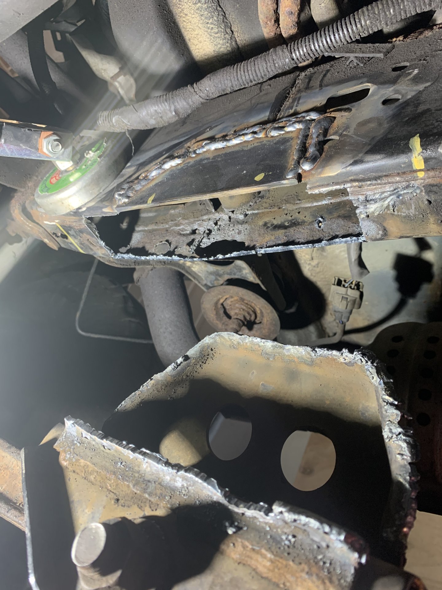

Definitely sounds interesting and educational though. I’m going to resist getting distracted by that until I finish dealing with rust and reattach the control arm on my wife’s truck 😬

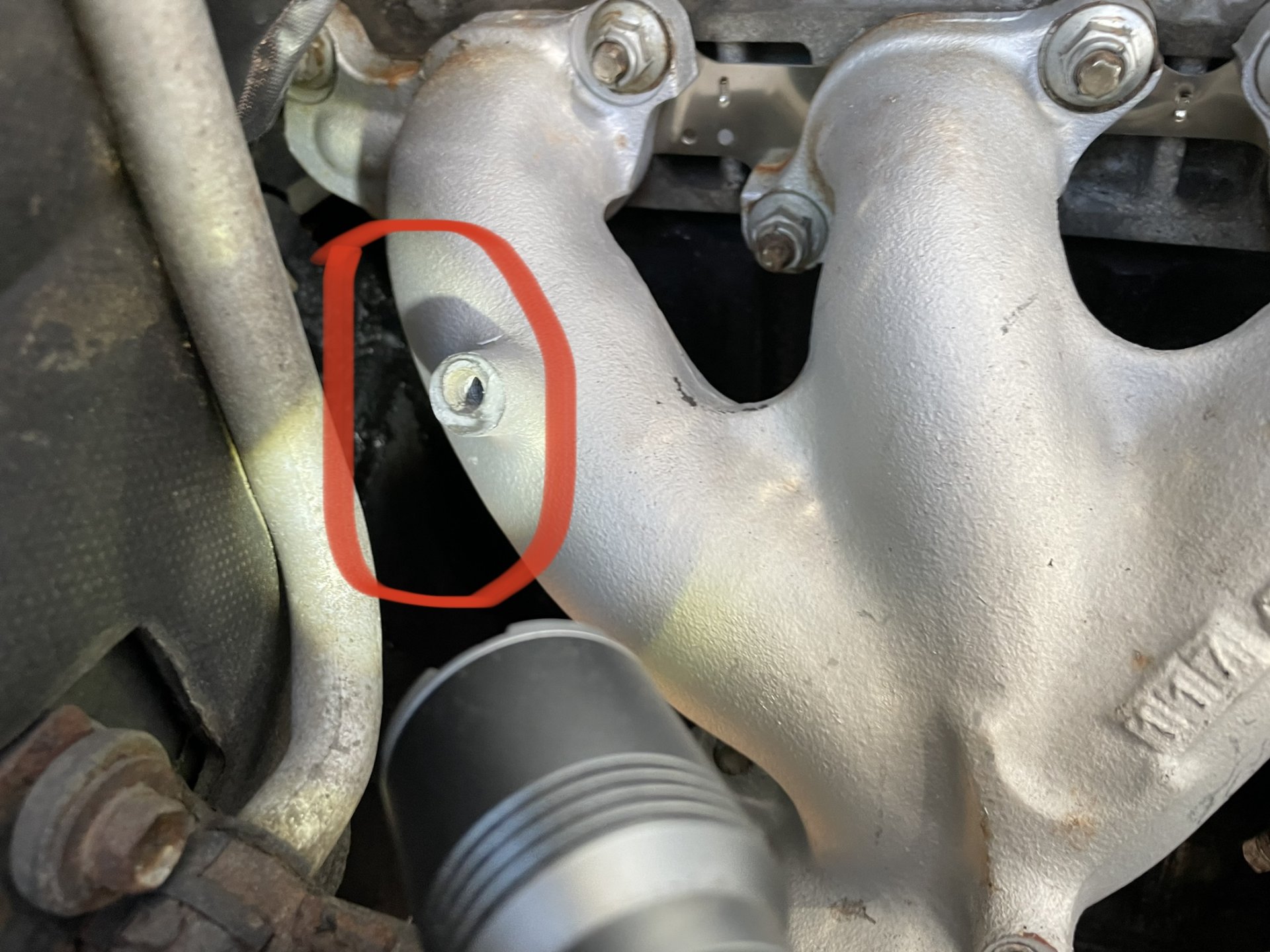

Noticed I recently started losing coolant in the 80-series and could smell whiffs of hot coolant from the engine bay. After looking at all the connections for leaks with no success, I finally found a wet spot towards the back of the block flowing down by the rear of the exhaust manifold.
The rear heater was deleted a while ago and the it’s not leaking at the firewall connections for the heater core. I also checked the freeze plug in that vicinity and it’s fine.
Am I about to learn how to replace the head gasket or is there something else back there less “catastrophic” that I’m missing?
Pesky heater hose?
