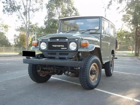

Dan's 1979 BJ40
Great rig! I wish mine was a diesel.
I feel ya on the 80 as I know it would be hard to let go of mine and even harder for my wife who loves it dearly. But, I agree with you that the 40 has enduring character and appeal that pushes aside modern practicality. I think you made the right choice :cheers:.

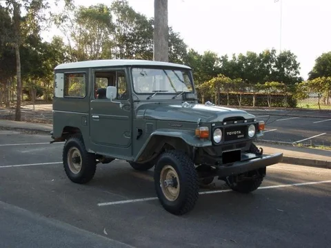

oh good you took that hidious roof rak off
Sure did, it wouldn't fit in the garage with it on. The cruiser looks so much better without it.
....and it did not help the aerodynamic 40 series shape at all! :hillbilly:
Mine originally sported a similar roofrack. Best thing I ever did was to dump both it and my bullbar. The weight-saving and lowering of the centre-of-gravity both made a tremendous difference to handling and performance (not that either of those terms sit well when you're discussing a BJ40 :D).

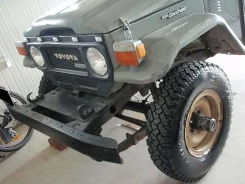

The next thing on my "to-do-list" is get the suspension sorted out. I'm either going to fit some smaller shackles to get the shackle angles away from vertical, or have some longer main leaves made up to get the extended shackles that are now fitted away from vertical. Something needs to be done because with the extended shackles on it now at vertical and the heavy-duty leaf packs, it rides like crap and is too stiff.
