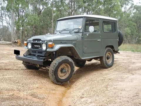

Well, i finally got my new shackles fitted a few days ago. Just standard sized ones, but damn they made a huge difference. The springs now actually flex and don't feel restricted like they used to. I much prefer the stock look anyway and wasn't a fan of the huge shackles. It could still be "flexier" i think, but that might mean removing a leaf or two from each spring pack? And maybe the shocks are too stiff, not too sure yet. For now I'm happy with it and this morning i drove it for four hours straight , just to test it out :D. It feels like it has suspension now, haha! :rolleyes:
Couple of poser shots...

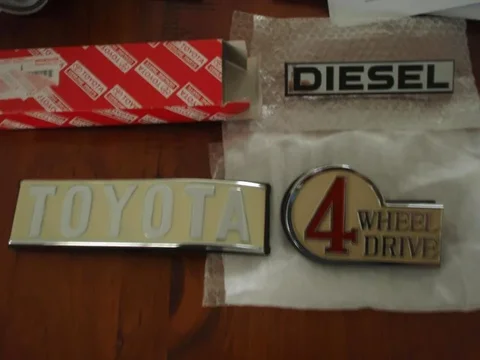

...And with the recent strong aussie dollar i couldn't resist buying a few Landcruiser porn items. :) It spins me out that you can still buy brand-new emblems for a vehicle over 30 years old!
If and when i decide to strip it back and have it resprayed the original colour then i'll add these. For now i just like to look at them....all shiny mmmm...:beer:

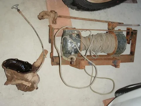

PTO winch = score!
Well i scored a complete 8000lb Thomas PTO winch this weekend. A good friend of the family has an 82 HJ47, with a seized 2H in it, that has been sitting in his paddock for around 4 years. I remember getting driven around in it 15 years ago and while it was a bit rough, it was a reliable old work ute that had a hard life. We visited his farm a year ago and i spotted it sitting out in the grass, rusting away. I had just bought the BJ and i remember this ute had a winch so i checked it out and saw it was a Thomas winch. He promised me it was mine, i just had to remove it. :D
We went up there yesterday, pumped some air in the old tyres and dragged her up onto some hard ground so i could get underneath. It came out easy enough and everything slides and spins like it should. The steel cable is broken, but thats no hassle. I'm going to clean it up, grease it all and make up a cradle to mount it up. I'm pretty happy. Not a bad swap for a carton of bundy rum & coke cans! :hillbilly:

I got the emblems from a couple of stores listed on ebay in the USA. I found it easier to justify now that the aussie dollar is just about equal to the USD. :)

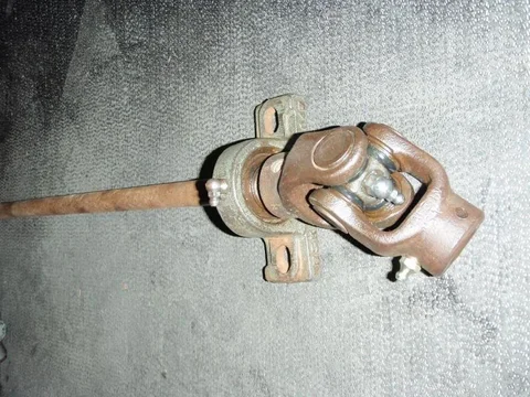

Righto, so i haven't really done anything to the BJ over the last few months, except drive it. I've cleaned the PTO winch up, greased all the uni's and got it ready to mount, but it's still sitting on my garage floor waiting.

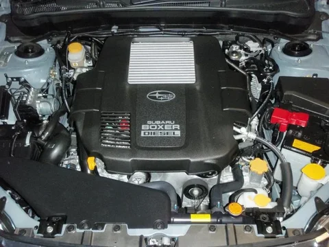

Of course it had to be diesel....
A Subaru Forester with the new Boxer Diesel. What can i say, this engine is fantastic. It's mated to a 6-speed manual and they claim you can get 6.4L per 100Km's on the highway, or around 1000km's to a tank. Peak torque of 350nm between 1800-2400rpm is a good place to play around in. It's got a Diesel Particulate Filter (DPF) straight after the turbo, which is the only thing i wasn't keen on. Hopefully i won't have any hassles with it clogging up anyway, due to amount of highway driving i do. Because it's a horizontally-opposed engine it has basically no vibration and sits down really low in the engine bay.
I'm going to have it for a few years now, so we will see how reliable this hi-tech diesel turns out to be. So far i'm loving it. :steer:

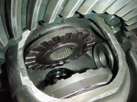

Got the lockright fitted to the cruiser today. Damn, it was an easy install! I thought i had a leaking wheel cylinder before i started, but turns out it was an axle seal. I fitted two new Toyota axle seals, repacked the wheel bearings and it's all good so far. Now that i know how simple a Lockright installation is, i want to put one in the front diff! Took her for a test drive and everything is good. Driving style has to change a bit and you definately know it is there, but i'm not driving the 40 everyday now so it's not such a big deal. Can't wait to get offroad now and test it out. :)
I found my new favourite shop too. It's a Toyota parts only centre about 10 mins from work. I picked up a whole heap of new OEM nuts and bolts before starting the job.

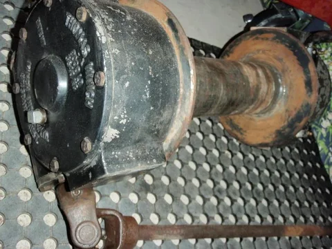

Here's some pics of the PTO winch cleaned up and greased ready for fitting. I might repaint it in the future, but for now i just want to get it fitted and working.

I've only got a locker in the rear, and you can really feel it trying to straighten the truck up if you apply power while your in a corner. Roundabouts in the rain are going to be interesting. Because the 40 is so slow i'm quite often burying the accelerator pedal, so the lockright is locked a lot of the time. I'll test it out this weekend maybe down the Glasshouse mountains.
