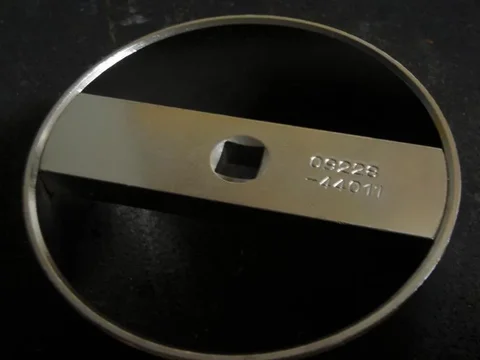

Ebay has also been good to me over the last few weeks. I picked up a brand new Toyota SST for the OEM 15600-41010 oil filters for a really good price. This should make the routine oil & filter changes a bit more enjoyable. :lol:

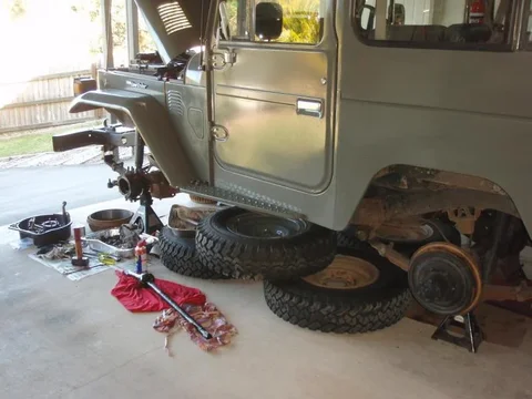

Finally got in and did the infamous swivel-hub rebuild. The LH side axle seal was leaking slightly. I put in new Marlin inner-axle seals, new bearings and new gaskets/seals. I used OEM nuts, washers, axle studs and cleaned/re-greased the Warn hubs. I separated the birfield and re-greased them while i was in there too. I used the "steel pipe-against concrete" method to seperate the inner axle and the birfield and it worked awesome. :hillbilly:
Just like everybody mentions, it's not a hard job, it's just really messy once you get into it! :doh:
Time to get dirty.:D Lots of crud built up on the swivel hubs...
