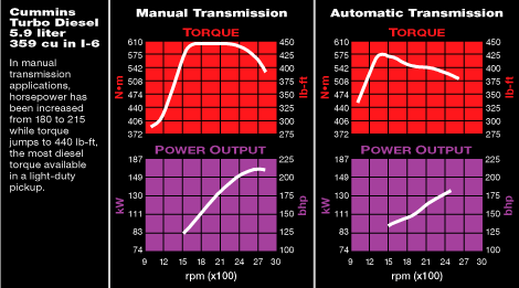

That chart is a stock dodge 5.9 p7100 truck. 215hp and 440ft/lbs, you can see it has no problem fueling past 2200rpms. There might be other variations of the 5.9 cummins for industrial use that are different but for the dodge, like the one used:
Year Disp hp tq pump valves
1996 5.9L 215 440 P-7100 12V
1997 5.9L 215 440 P-7100 12V
1998 5.9L 235 460 P-7100 12V

Took my roomies 96 cummins nv4500 scouting my hunt area. I knew it was the case but thought I'd drive it again just so I could be certain, it defuels about 22 2300, loses power fast but keeps climbing to about 2700 or so.
The chart you posted really has nothing to do with the p pump governors. Rather, depending on trans year and application they produce different amounts of torque and hp.
For example that chart really only applies to manual trucks for that year. Automatics have lower ratings.
Truly he's better off keeping rpms under 2k or less on the hwy.

Didn't say he wouldn't be better keeping it at 1800, but you said he was out of his power band which clearly looking at the graph isn't true. The manual chart and the chart I posted are the same. I quoted 215hp and 440ft/lbs just like your chart. not sure about your "Buddy's truck " but I have driven a s*** ton of Dodge 5.9's and none of them defuel at 2300rpms. Your statement makes no sense, losses power fast but keeps climbing? It either losses power or the power climbs can't do both. The graph from the manufacture clearly shows power climbs to 2700rpms. Period. It couldn't do that if it was "defueling" there is no fight to be had. Your friend's truck might have an issue but I assure you it isn't an issue for everyone else.
I have plenty of power well passed 2,200 RPMs. I would like the RPMs to be lower when cruising but I knew that would be an issue going in to it. I could try to source gears from a diesel cruiser from oversees but that's more cost and I would have a problem and lots of downtime if something broke. I could also go to a taller tire but right now I like my ride height at the moment. Getting 20mpg on the highway in the mountains is just fine at the moment. No complaints.
Torque falls sharp. I can assure you, factory p pumps start to defuel at that range, period. Look it up (why do you think people do 3k gov springs?) Truck will still gain speed but you lose the torque. Ignore HP, it means little. He's definitely out of his power band over 22, and mileage will suffer. Truck has no issues, that's what 12 valves do. AGAIN HP and Torque has nothing to do with governor speeds, your chart meant absolutely nothing regarding torque curve, that's just a list of max HP and torque, which occurs like 17-2200. HP climbs and that's what I meant that you lose power but the truck won't just stop accelerating until you hit about 27/2800 rpm when it governs out. Read the torque curve. Read the link I posted.
"*The "governed speed" is the highest speed that produces useable power. Above the governed speed, engine power drops VERY quickly." 2700 RPM
One last time, starts to defuel, torque declines quickly, useable power stops at 2700, but torque falls quick just after 2200, you can FEEL it. It still accelerates but doesn't pull like it does at peak torque, ie power band, ie torque curve, ie 16-2200'ish.
His pump is stock minus a 10 fuel plate and some playing with the AFC (by me), but maybe it's more noticeable when making more power. ;) "loses power fast but (rpms) keeps climbing to about 2700. *before it just stops accelerating all together*
Stock governor springs de-fuel starting at about 2200 RPMS, it's quite noticeable. Governor spring kits allow your IP to fuel up to 3000, 4000, 5000 + RPMS depending on what kit you buy. The popular choice is to do a 4K GSK. It fuels nice and hard throughout the RPM range. If you plan to do a 4K GSK and REV ABOVE ~3250 RPMS, YOU MUST ALSO UPGRAGE THE EXHAUST VALVESPRINGS TO 60LB SPRINGS! Many kits come with both sets:

I quoted a lot of people. Fact, that's how a p pump works. Fact dyno charts plot a torque curve, it's not disputable. But hey, resort to calling names and backing out of the conversation, or just admit you have no idea what you're speaking of. Let me know when you tune a pump yourself or swap something yourself. I posted several links, clearly everyone made it all up. We're all a bunch of diesel bros. That company is lying too, no one understands p pumps, they've only been on cummins since 93, and so no one can call em out on that. ...and if you can't feel when your engine stops pulling you're an idiot, no butt dynoing involved. You can see it on the dyno chart from cummins, but I suspect you don't understand torque. You could also read it in any of the links I posted but nah, it's all BS, made up, no one understands p pumps except you, with all your experience driving them around. BD, Schied, Gillette, Innovative, Industrial Injection, they'd all tell you the same. I'm not an innovator but I'm not stupid and I can read a damn torque curve, and I can read what the pros have said, and guys who have tested their products. First hand experience always helps too but in that case I guess there's just something wrong with the truck... of course. Oh and his too...
"ive had my 3k gsk in the truck for over 10 months now, and i love it. recently i had the oportunity to dyno my truck at the fall brawl, and was happy with the hp and torque readings, but i studied the dyno charts and it seems like the truck was defueling heavily at about 2800rpm. is that a good defuel rpm with the 3k springs, or should it be higher? my other question is can i go back in the pump and make the springs one click tighter and will that raise the defuel rpm to maybe 3000, 3,200 rpm? my top end seems ok, but i think i can get more out of it."
HP= TQxRPM / 5252 Torque is measured, HP is calculated, HP means little with these cummins, we're looking for torque! That's what you feel, and you can feel it drop off. That 3k GSK keeps the pump fueling longer, keeping the torque curve flatter, longer, making for a better driving experience, with more useable power between shifts.

Go punch it in 2nd and let it wind up, you'll feel it start to slow significantly around 2300 and then it'll stop accelerating a little past 2700 and it'll just maintain speed. It's especially apparent going up a hill.

You specifically said he was out of his power band. He obviously is not, power band goes to 2700+ rpms. If you would have said you weren't making peak torque, that would have been true, but that is not what you said. Facts are he is in his power band. Like I said yes there are many other ways to make a lot more power with the 5.9. You said he was spinning too high of an rpm, making more power doesn't change that. I did agree that getting rpms down to 1800 would be ideal but no need to go changing a bunch of things when it will work great as it is.

That is not arguable. Keep trying to diffuse to lame posts you quote. But answer these 3 questions.
What rpm is peak torque?
What rpm is peak hp?
Is the truck between those two?
Then he is in his power band.
Would he be better off for the reasons I already posted to spin 1800rpms at cruise? Yes. Is he in the power band at cruise now? Yes. Facts are facts, you can go back and change your statement and say "well ummm I meant torque not power band" and that is fine, but as you said it you are defending an indefensible position.

Power band by definition is what you say however I've said many times to follow the torque curve and that you will find that it peaks between 17 and 22 and after 22 it drops substantially. Again my original point was that the P 7100 pumps starts to defuel around 22 or 2300 rpm's. When that happens peak torque drops significantly which is why the 3K Gov. Spring kit is so good it extends your peak torque range and there's really no reason to be outside of that peak torque. Again optimal range for cummins is like 17-22 +- stock.
Oh and extend that peak torque range and I'm sure you can figure out what happens to HP.
But really I think this is what it's coming down to for you, and HP in a low revving diesel is just not comparable to gas engines.
