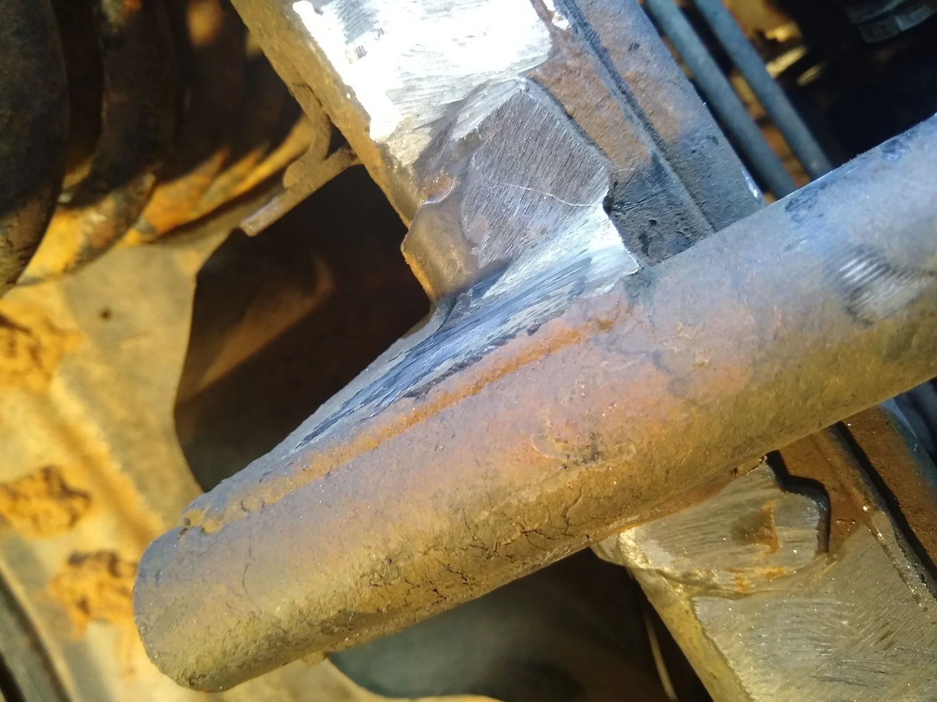

I took a close look at where the cross member attaches to the opposite frame side and found what appears to be a small crack. This is the solid rod that attaches to the panhard bracket and runs across the rig to the opposite frame rail. I think this was probably a result of the original cracking but I'm not taking a chance so I welded up a 3/16" plate bracket to reinforce that entire area as well. So I would say that if you found cracks on the steering side you should also closely examine the opposite rail where this rod attaches.

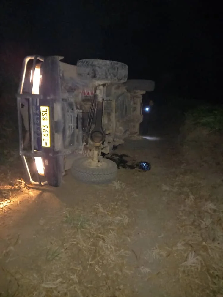

I recently tipped my LC over on right (driver) side. After getting the panel beating sorted the old girl developed a massive death wobble. Tightening bearings, replacing bushes and balancing eventually sorted that, but plenty cracks on chassis around steering box, shock and spring towers and a couple more were discovered. Slowly getting sorted as she's my dd and its rainy/mud season. I like that someone saw the problem around the steering box and created a fix with the weld-in plates.
Wow, that's horrible!! I did a cursory look in these locations for cracks but the frame paint makes it hard to tell if there's a minor crack or not. In my photos above I couldn't see that crack on the opposite frame rail very well at all, it looked just like a crack in the paint. It wasn't until I ground it down that it was really obvious.

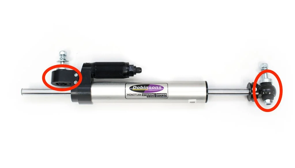

The Dobinsons dampers are certainly bad-to-the-bone, running them on all our shop trucks. They are indeed non-emulsion type. Keep in mind both ends are attached via rubber bushings. The one on the reservoir side is more like a small isolator that actual bushings, but the side on the shaft end full on rubber taper bushings like on the end of an OME shock or similar.
As far as connecting axle housing to steering linkage with damper, after a quick look under the front of personal rig, would have to be a pretty funky setup with odd angles, AND... with rigs that have a lot of articulation (as in NOT full size trucks), would require some extra special parts. Seems like having the damper connected directly to the steering box (stock setup) is an intelligent way to set it up.

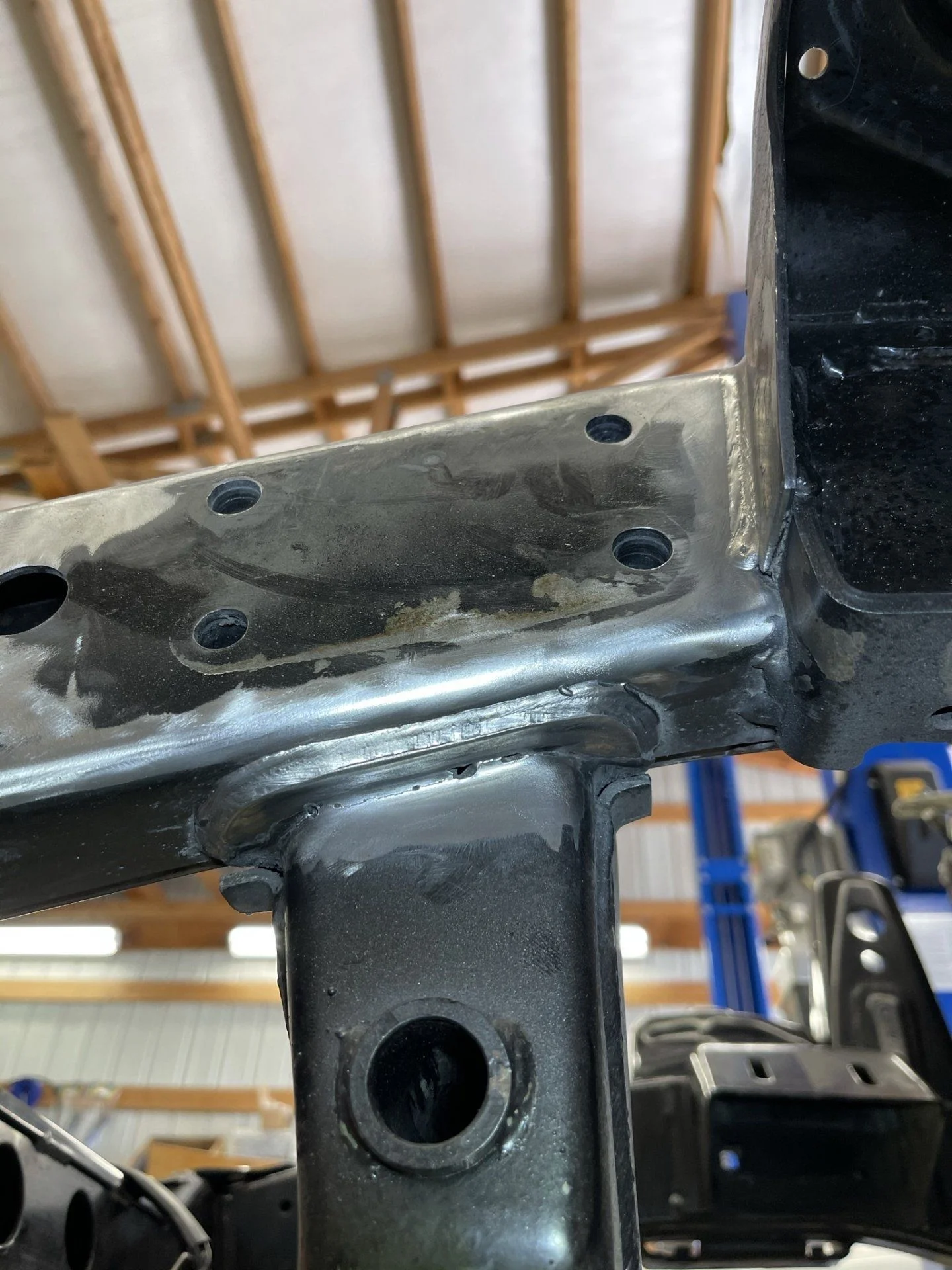

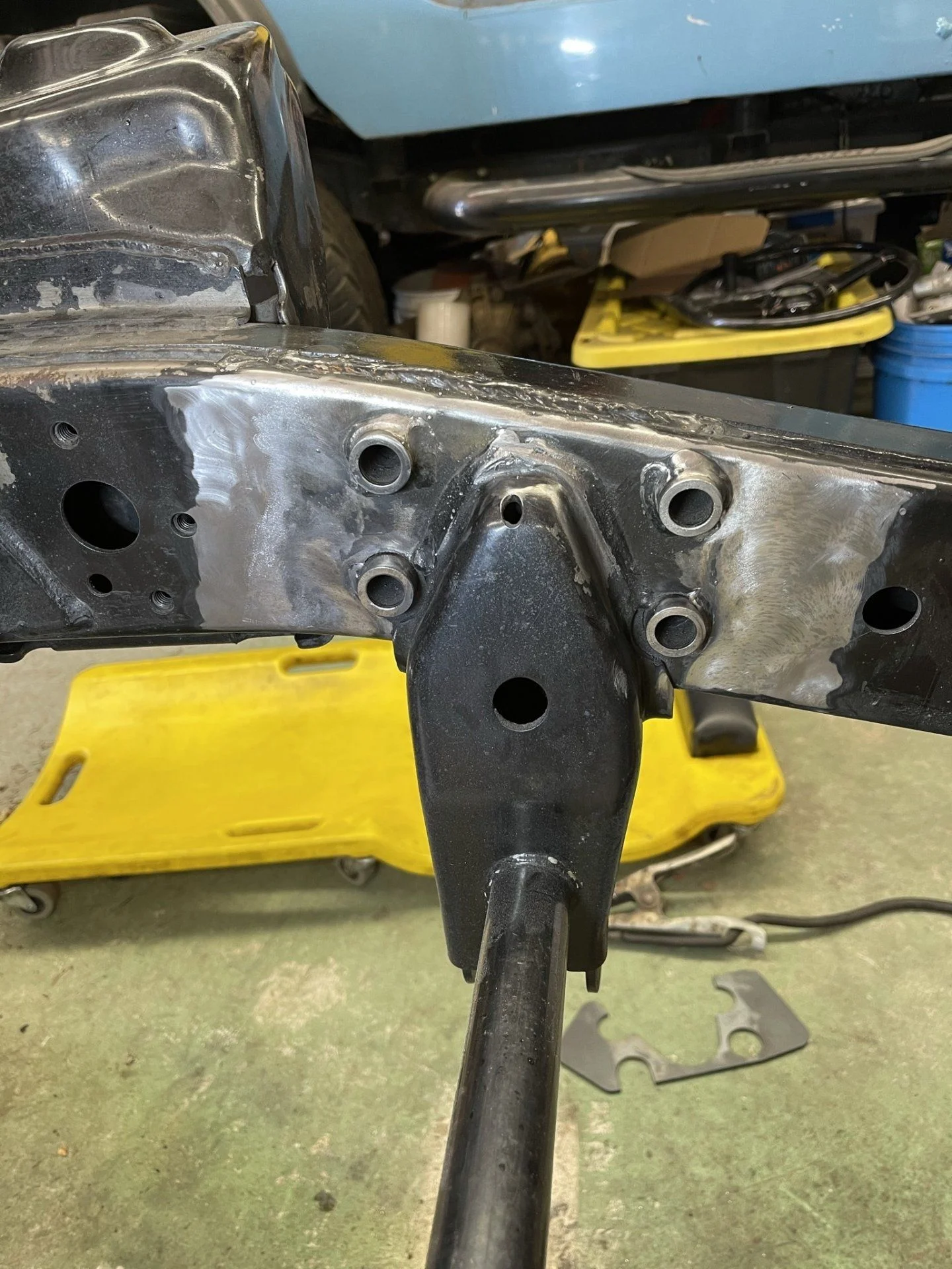

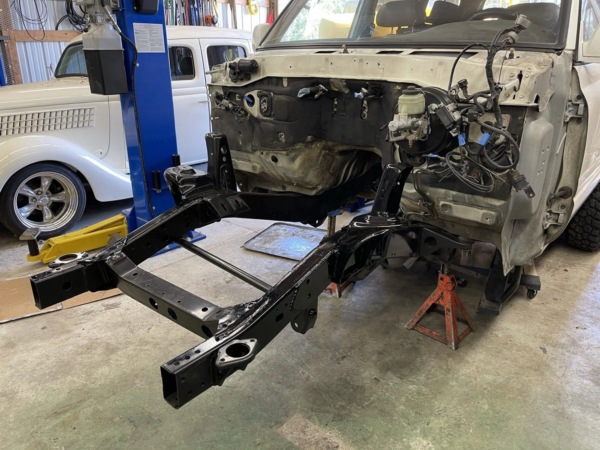

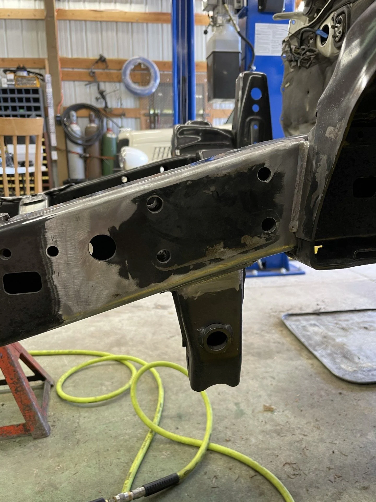

Quick update for others dealing with this. I ended up ordering these frame reinforcement plates from The 4WD Shed in Australia. They were $120 to my door, but well worth it IMO. Got them welded in yesterday.

The biggest difference I've made was quality tires (Nitto) road-forced balanced and a super strong steering stabilizer (Dobinson's Adjustable). This makes sense because the things most likely to contribute to a self-amplifying harmonic (which is what death wobble is) are the huge rotating masses at each end of the axle (tires) and the damper designed to reduce the harmonics inevitably associated with those large rotating masses (steering stabilizer).
The damper has made an unbelievably VERY SIGNIFICANT difference, quite frankly it's the only thing that made ANY consistent difference in the process of rebuilding my entire front-end including new radius arms, bushings all around, steering rods/TREs, all wear components in the front axle including birfs, etc. It's great that some folks can drive on 37s without a stabilizer--good for them, but that's certainly not the case for me.

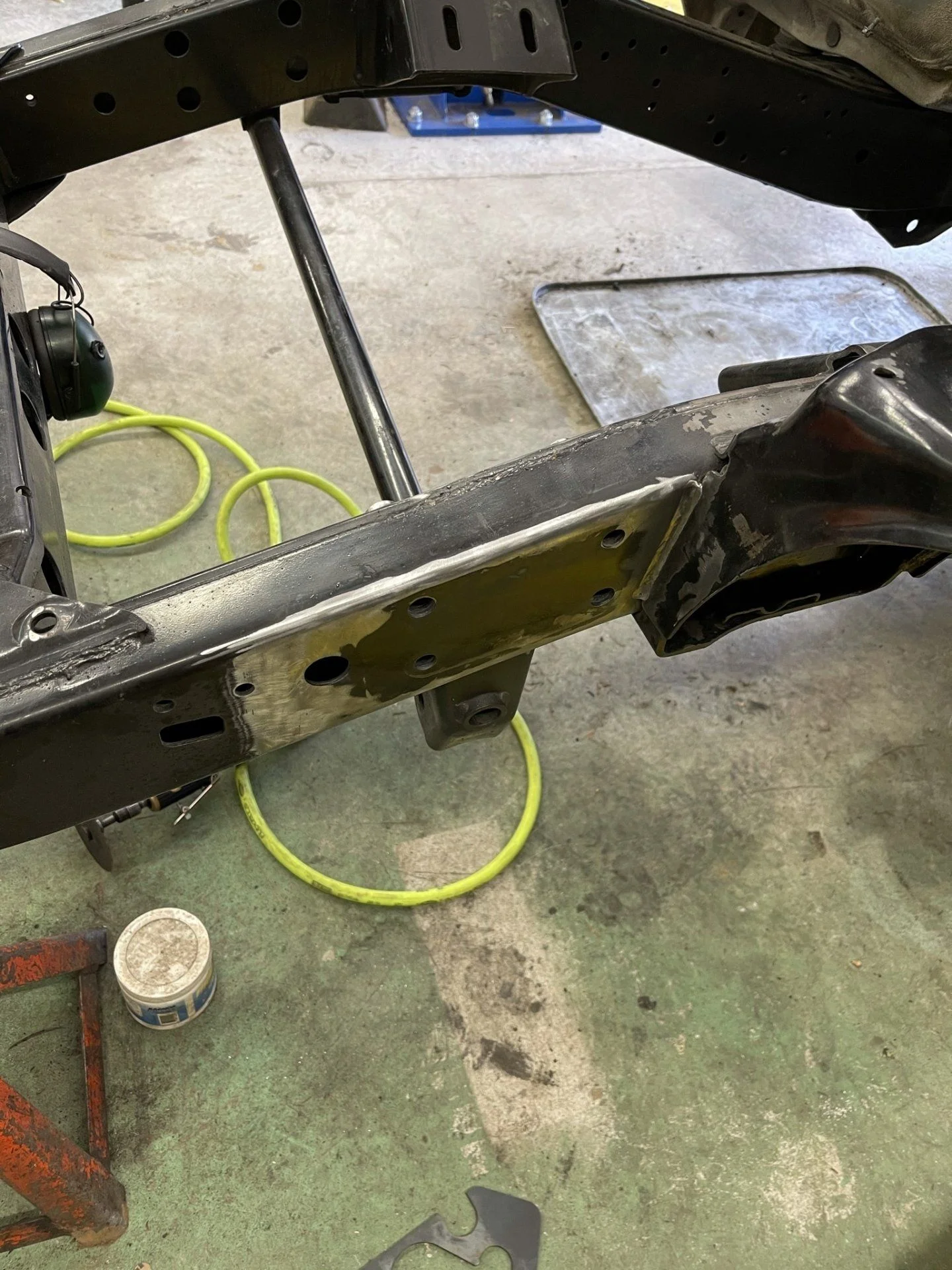

Thanks for the Template, I also have a 90' HDJ81 and was stoked to find it. I fabbed the plates today and will be welding them to the frame tomorrow.

Today I was under the rig and decided to really check out the frame. Found a crack under the steering box, and where the tubes are welded on the inside.
Hard to say which of these issues are causes are which are symptoms. The DW itself could crack the frame and beat the TRE's and bushes to death.

Another great thread came up the other day around welding cracked frames properly, definitely worth the read prior to doing the welding.
DeltaVS now finally offers a US source for pre cut plates!
