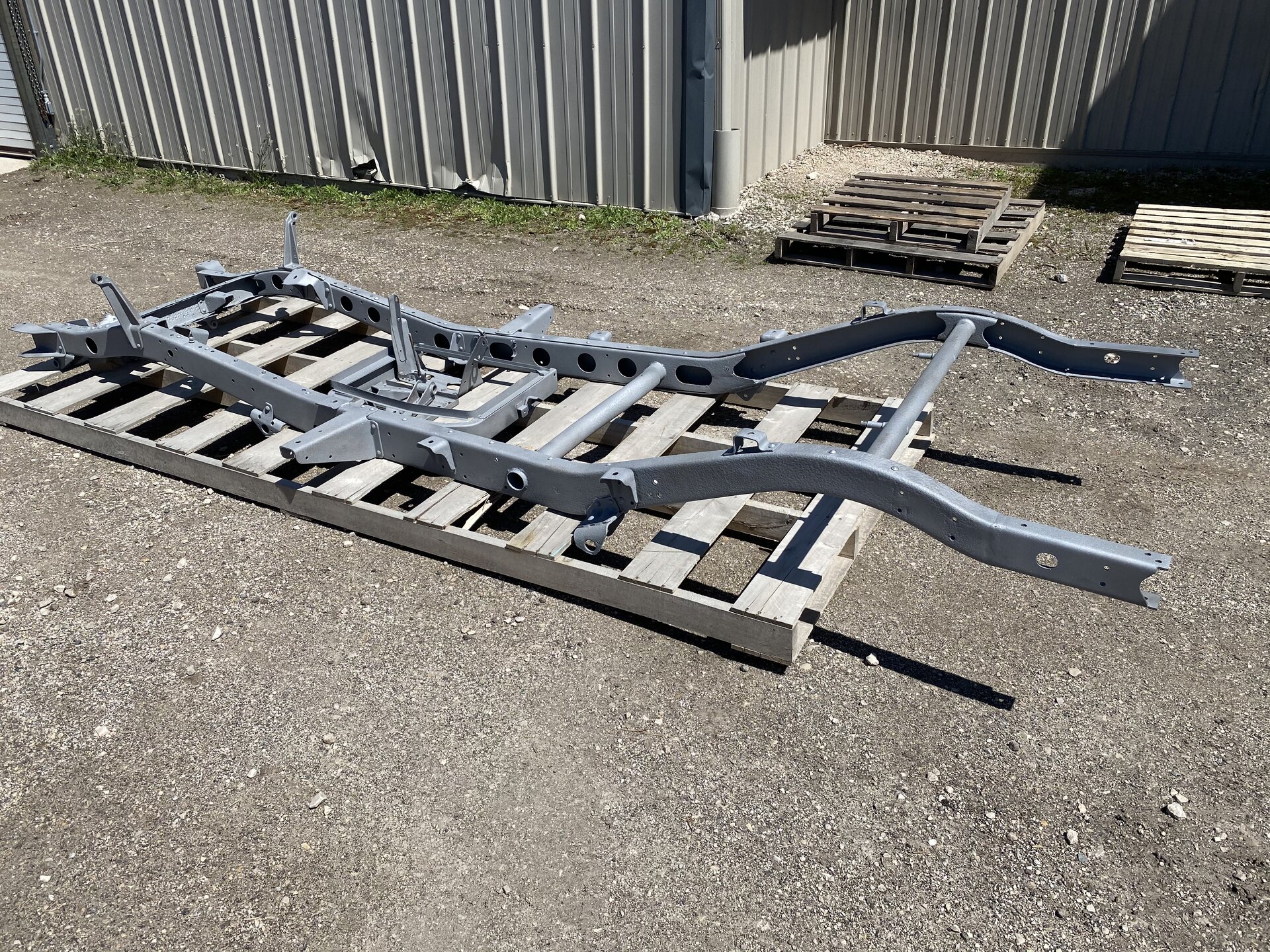

I stripped my frame down and pressure washed it real good. Then I took it to a shop and they sandblasted and powder coated it for around $500. I remember thinking it was a well worth the money. Check out page 1 of my build thread, there is a picture of it.
