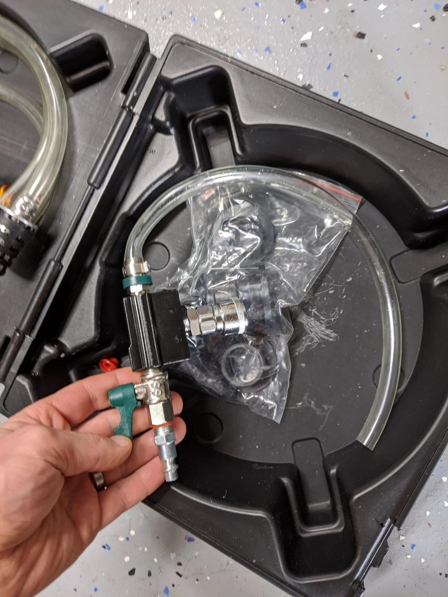

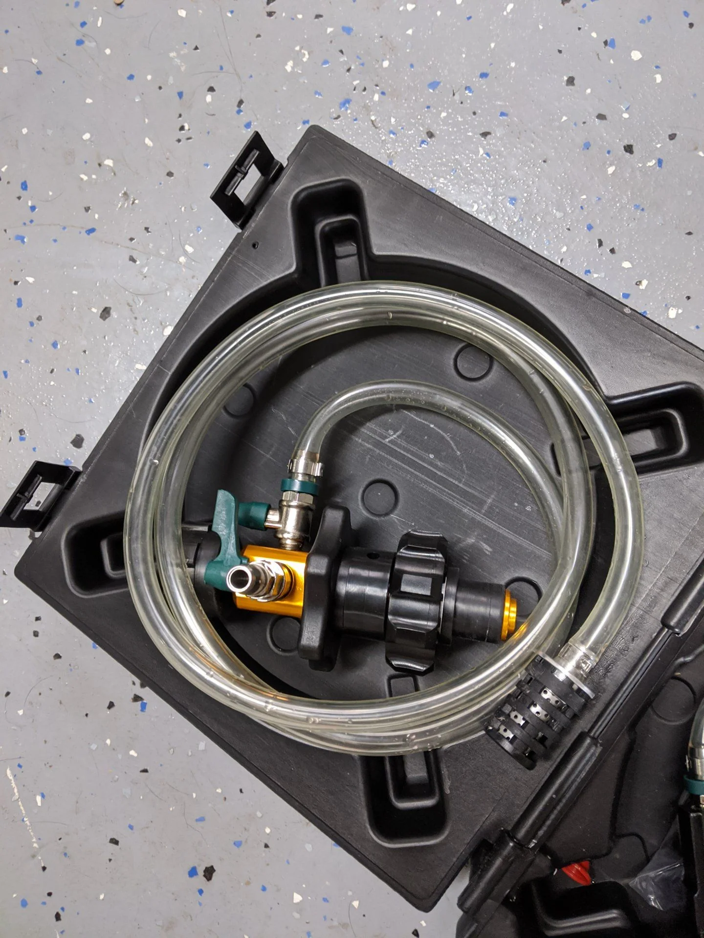

This is the one I bought after trying out a couple. The adapters are better than the other kits I used. Can be used to pressure test a coolant system as well, just done through vacuum.
OEM Tools 24444 with 5 adapters
5 min learning curve on the tool, but once you get it, you can swap the coolant on a cruiser in all of 30 min. I have used it on about 6 different makes and models and there always seems to be an adapter that works.

I used two brands: a friends MityVac which worked fine - it was a quality tool with fewer adapters. I also tried a cheap model from Amazon made by FJC which I returned as the cone style adapter wouldn't hold vacuum at the radiator cap.
The "oemtool" one I settled on I have one misgiving - the valve handles are plastic/nylon and I'm not sure they will hold up years down the road. That said I think there are plenty of options to swap them with if they were to break.

I have found zero air in my system if I use the tool properly, and after removing the adapter I will add a small amount of coolant to top up the radiator.
The instructions that come with the OEM tool coolant vac are poor. I went to YouTube for a tutorial and that was great.
I have used funnels for about ten years and never had an issue if the system was burped properly, but this tool makes the job almost completely mess-free now.
