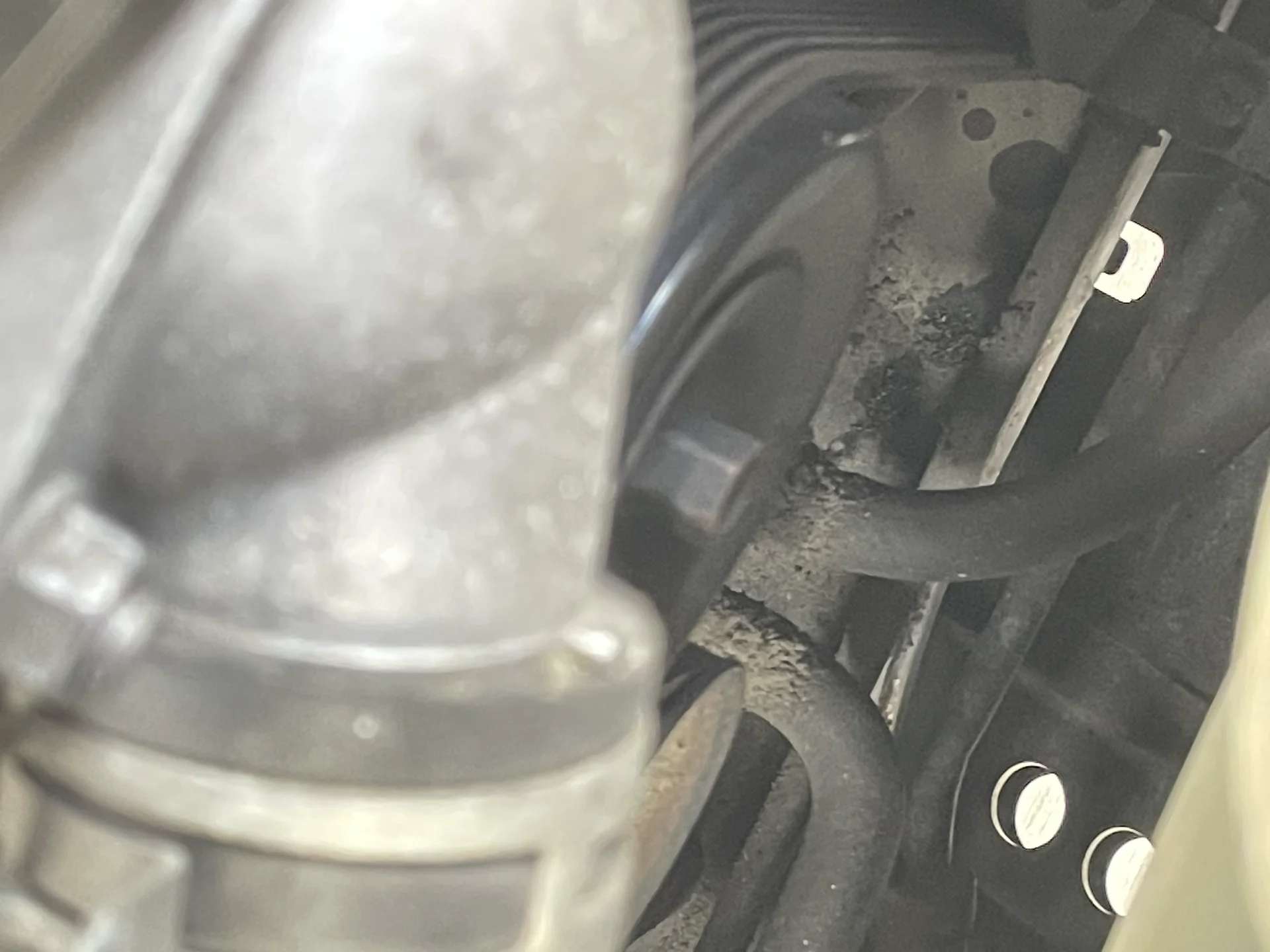

Got car home from shop. Still need to do some testing here but so far I've noticed:
- Still smell the coolant when I pop open the hood for ~ 5 mile drive.
- Did notice a drip as shown here. Not sure if mechanic did something but I don't think I noticed this before. Any ideas? Will keep an eye on it. Will be doing a longer drive on it tmrw
