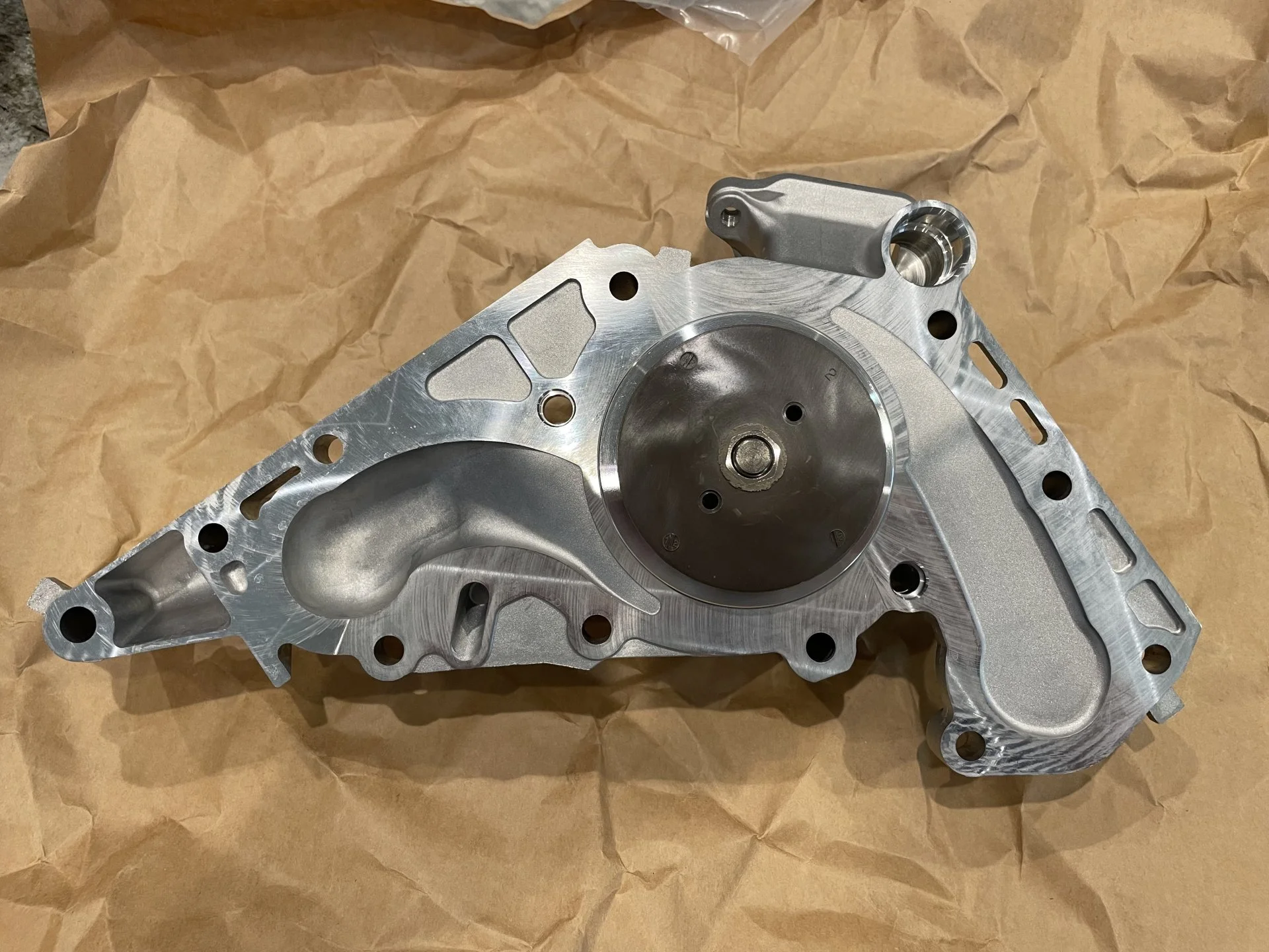

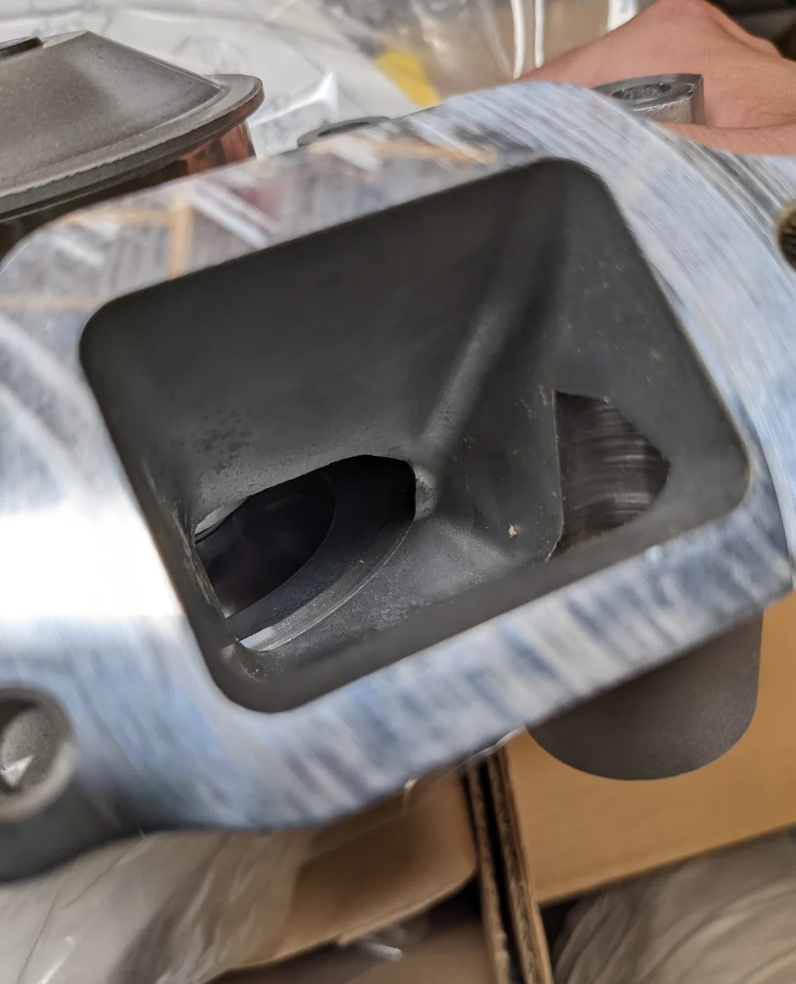

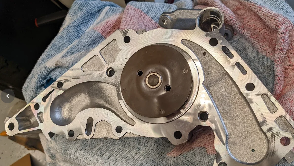

I immediately became suspicious of the waterpump. It had very unfinished ports, with aluminum casting slopy matting, no Aisin label or stamp but most importantly the flat matting surface to the engine side was badly finished and had some pitting. The water ports had pitting as well. Overall it did not look like an Aisin product. I heard from a buddy that there is a fake water pump market so I returned the entire kit and ordered from RockAuto.

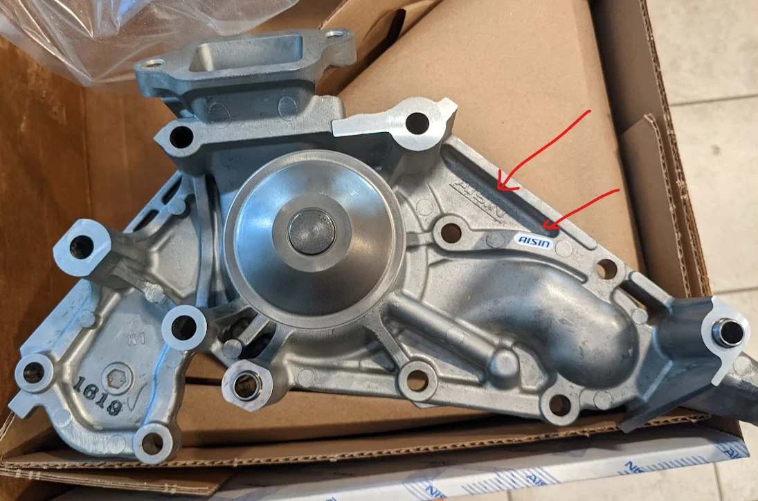

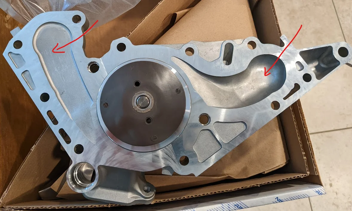

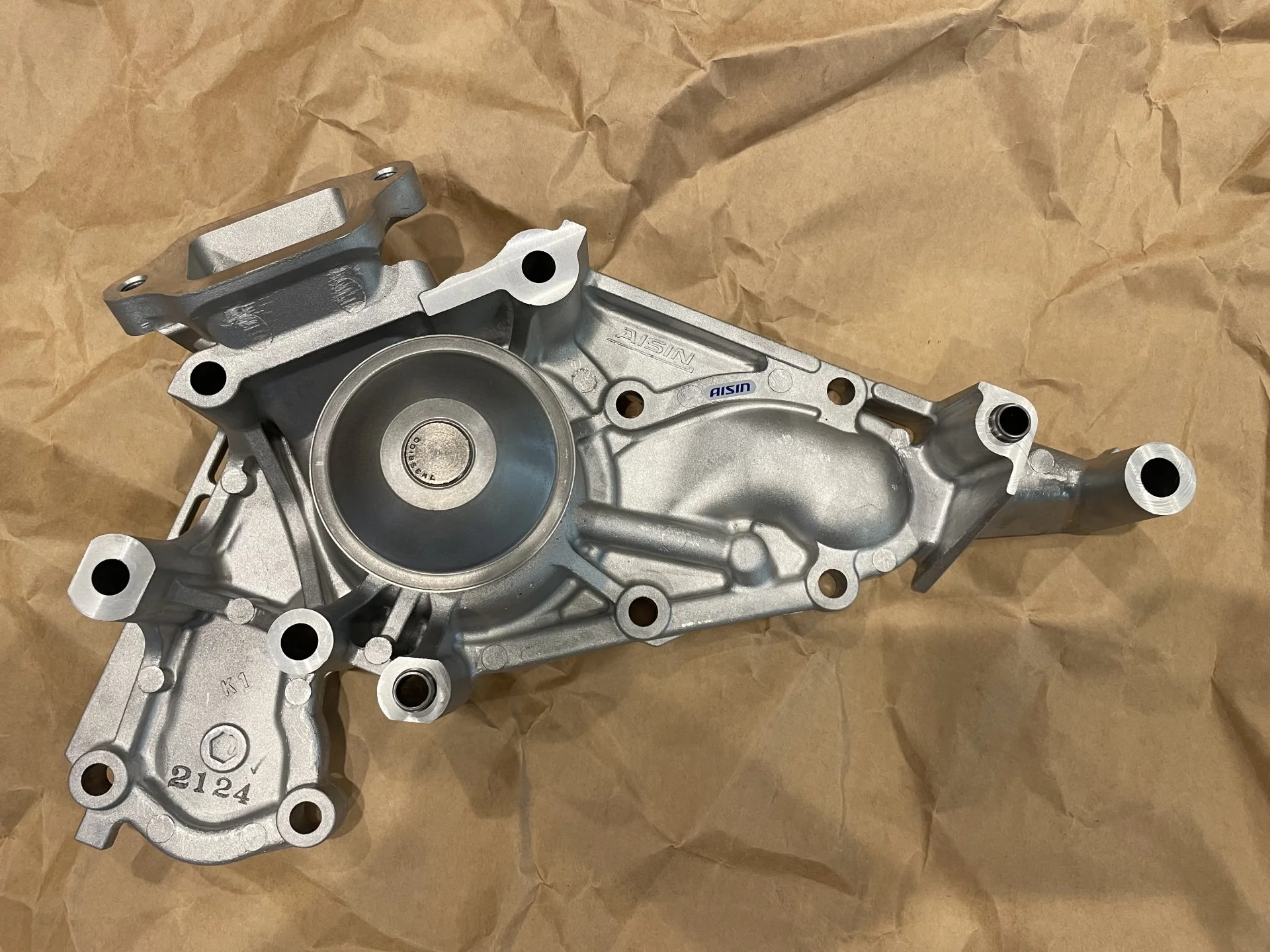

After receiving the RockAuto version of the part I confirmed my suspicion. The RockAuto version of the pump was a world of way in regards to finishing compared to the amazon version. The box was slightly different but otherwise, everything was identical, the only difference was the pump itself. Pictures speak loudly so I've attached them. Be aware!
Amazon:
RockAuto:
I can't stress this enough that otherwise the box and contents were identical! the box had a different logo outside and had a different design but even the components were arranged the same way. The Amazon pump was packaged like new and both packages looked like they had never been handled.

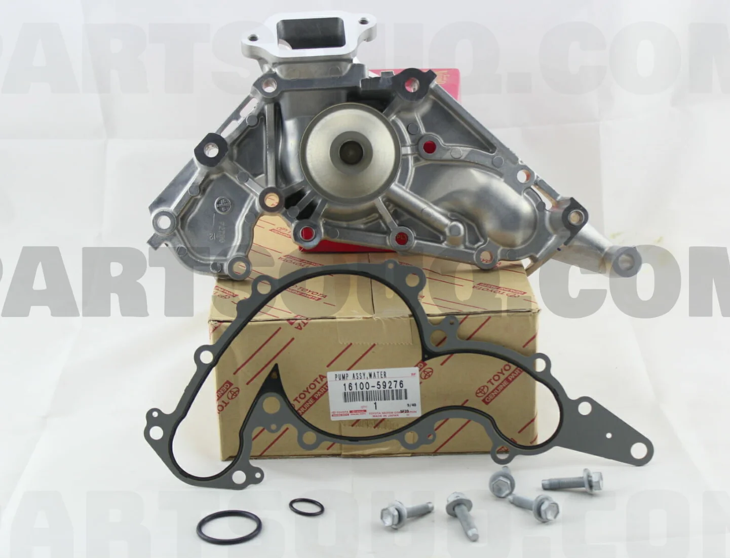

Excellent point about fake parts and always needing to be cautious. I just wanted to point out (since you gave me a minor heart attack) that Partsouq does not show the AISIN logo on the Toyota part. In addition, the water pump I got from McGeorge Toyota also does not include the logo. Images below:
Image from Partsouq Water Pump

Amazon Aisin port: (yes that's an aluminum shaving hanging by a thread.)
RockAuto Aisin port:

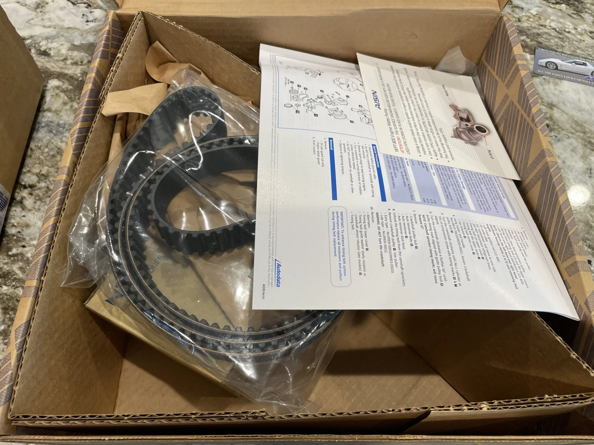

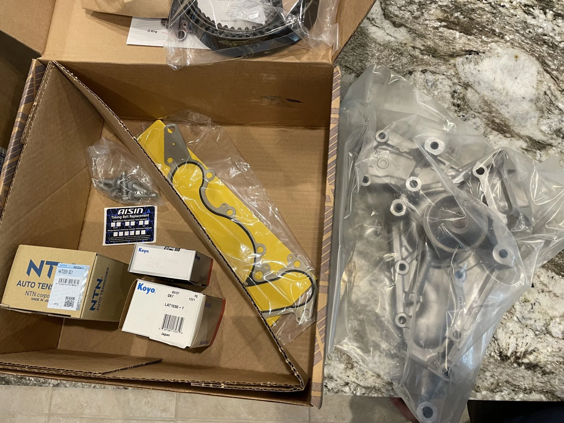

According to the TKT-021 box label, this kit is being assembled in the U.S. So, maybe they are all legit but with different production runs parts or maybe they are some knockoffs being put together and being sold off in the marketplace. IDK...but the parts I received from Rockauto looks good. For those curious, here's what and how it comes in the TKT-021 kit from RockAuto:
The box (this box was inside larger RockAuto box with bubblewrap...so box in a box):
How it looks when you open the box: Includes instructions
The content/parts in the box:
Here's the water pump (It looks like OP images):

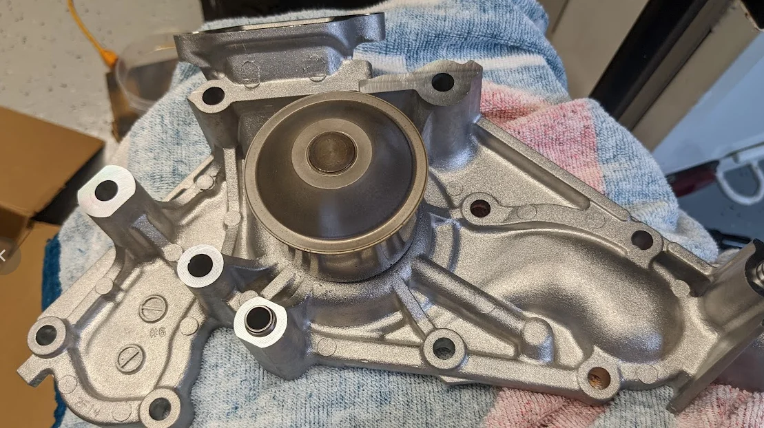

My waterpump from RockAuto looks identical to the one you are concerned with. Same green marks and the same little shaving from the edge that was not completely broken during the mfg process.
