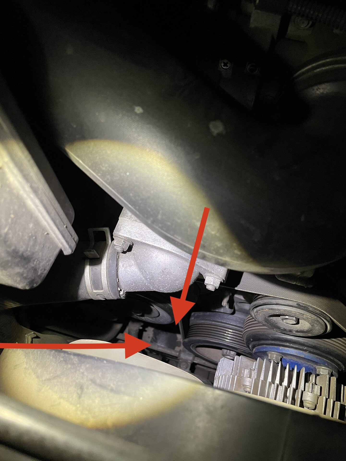

Hard to tell what that is- better if you clean that area and watch.
But check your coolant 1st thing in the morning- under the cap as explained above.

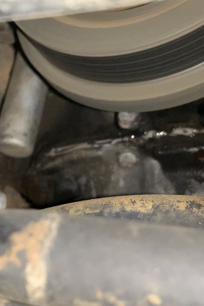

Are you clear on how to check for coolant leaking under the crank pulley- to rule that out?
Got it - will clean it and check it tomorrow as well as the coolant level in relation to cap - will update.
No to be quite honest I'm not familiar with where the crank pulley is. Researching that now but if you had any tips that would be super helpful!

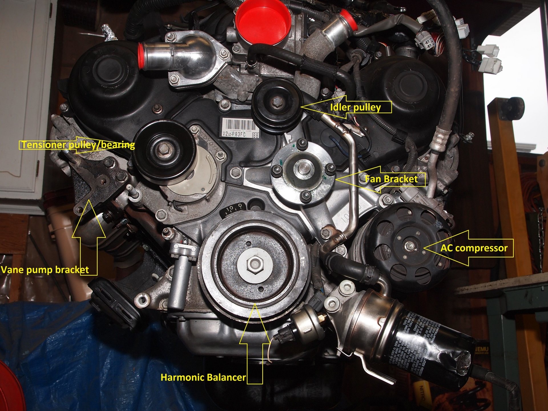

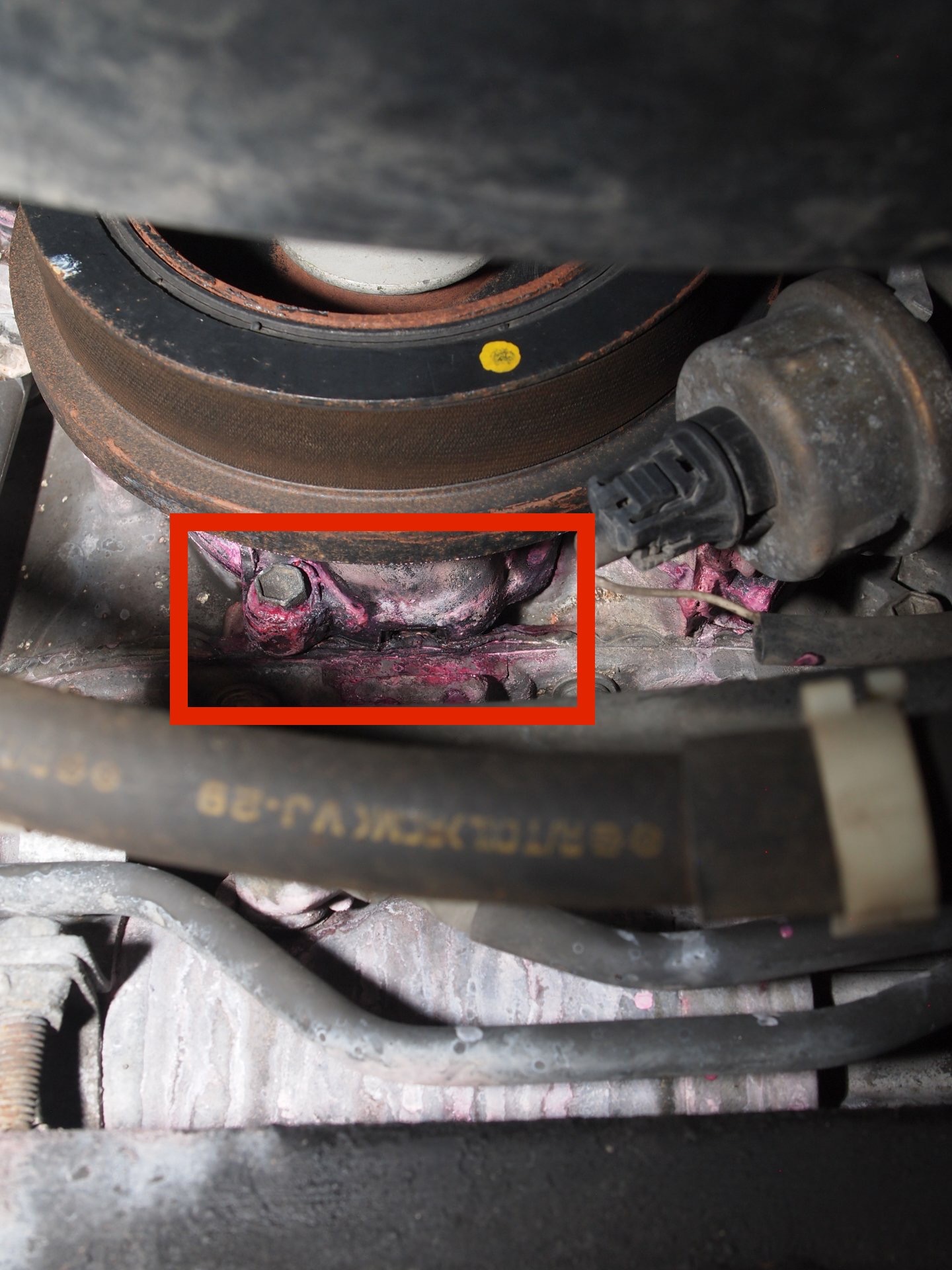

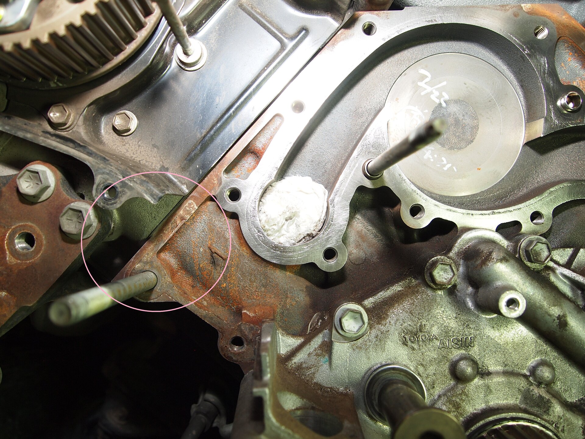

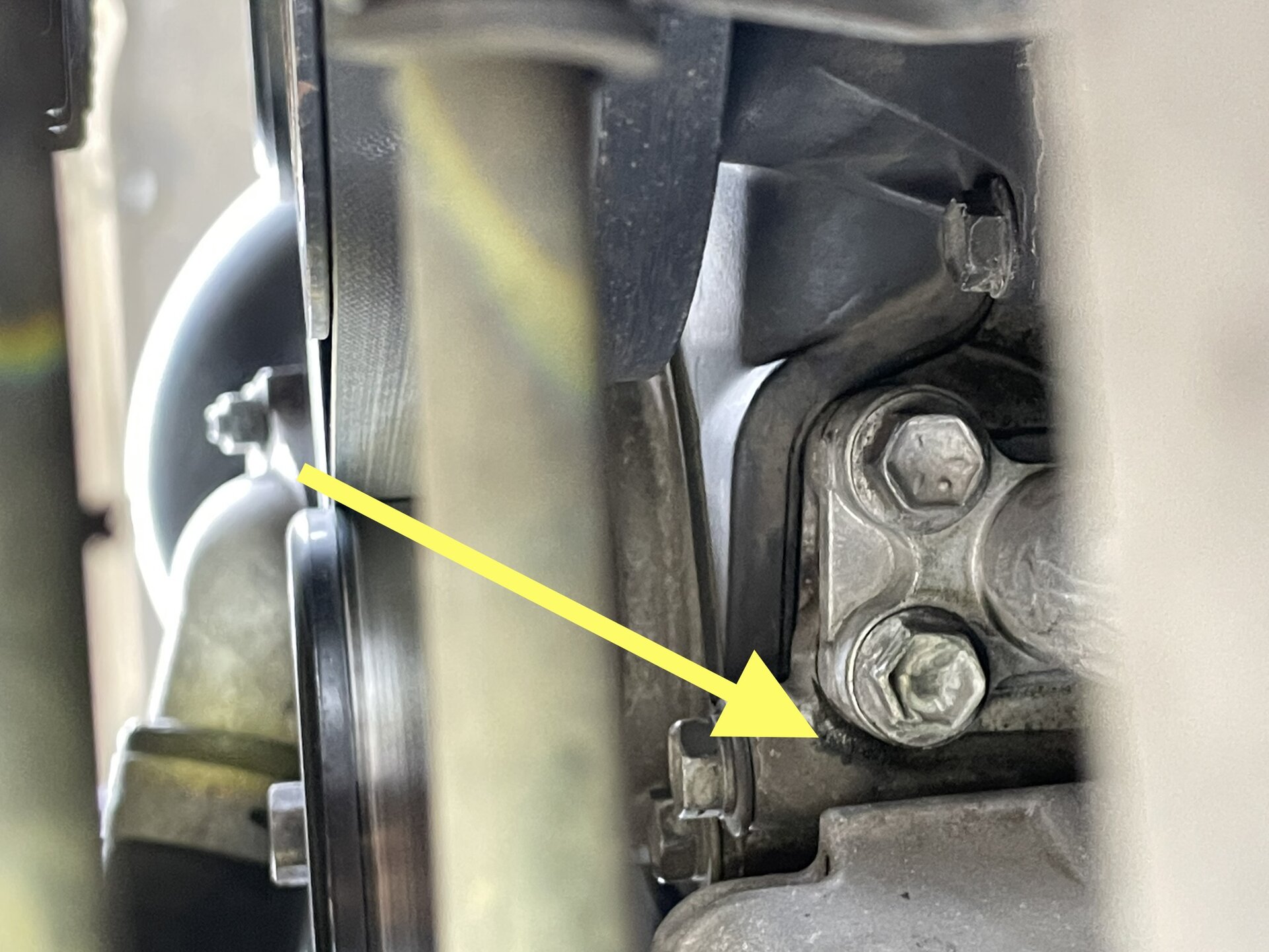

Courtesy of @2001LC
Under harmonic balancer area
There’s a small narrow opening below and behind the harmonic balancer pulley

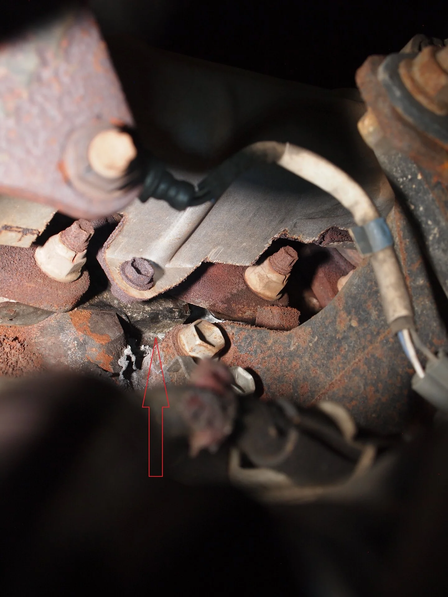

Couple of good leak threads - gives you some places to inspect.
When I couldn’t find an obvious leak a few weeks back, it was seeping out from beneath the thermostat housing area.
Do make sure to clean off whole area as much as possible though when looking for fresh leaks.

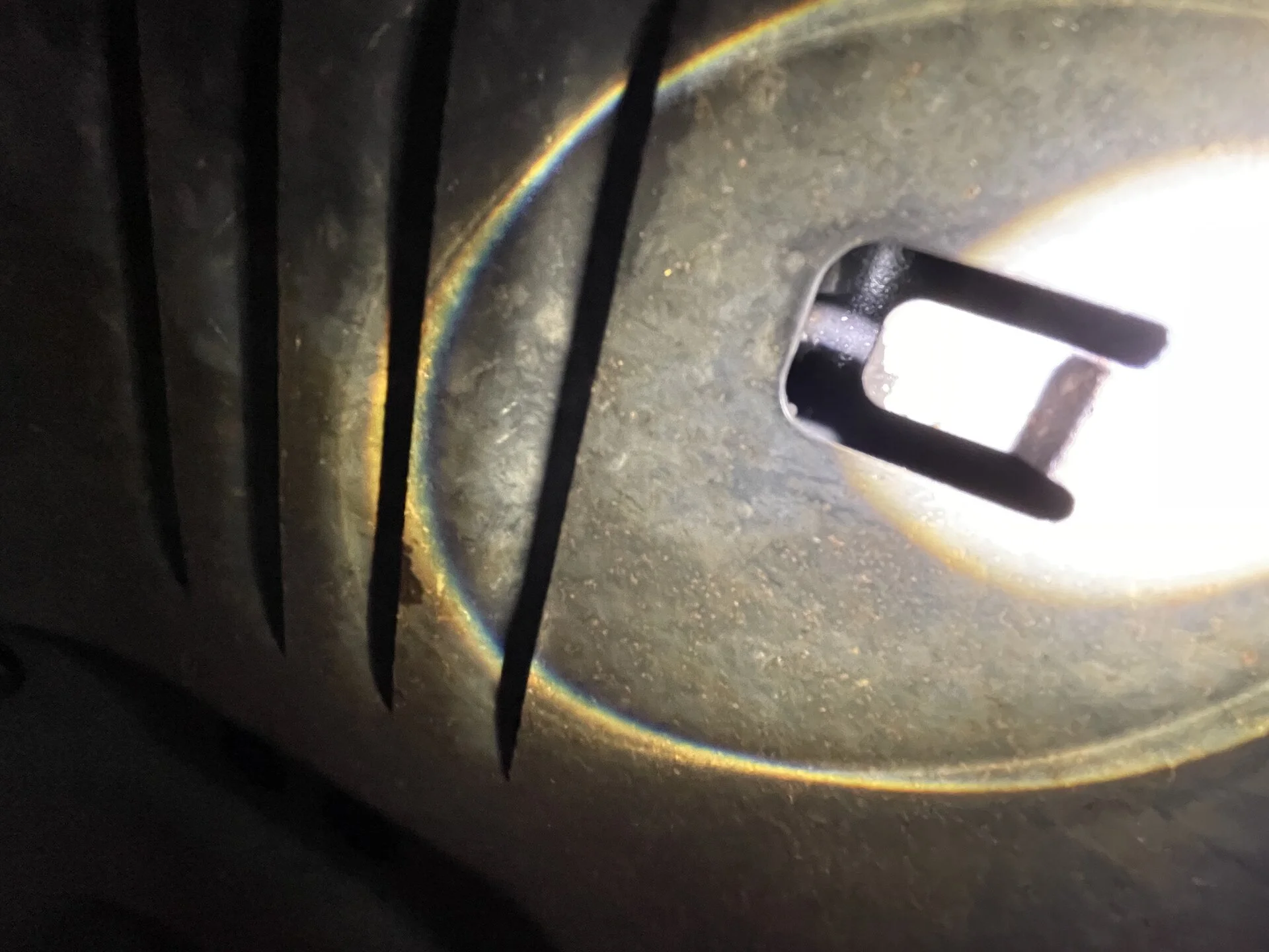

Maybe post a few more pics?
Are you handy enough to drop the skid plate down below? I think there are like 8 bolts holding it on. Getting a view from the bottom up may help a lot for diagnosis and cleaning.

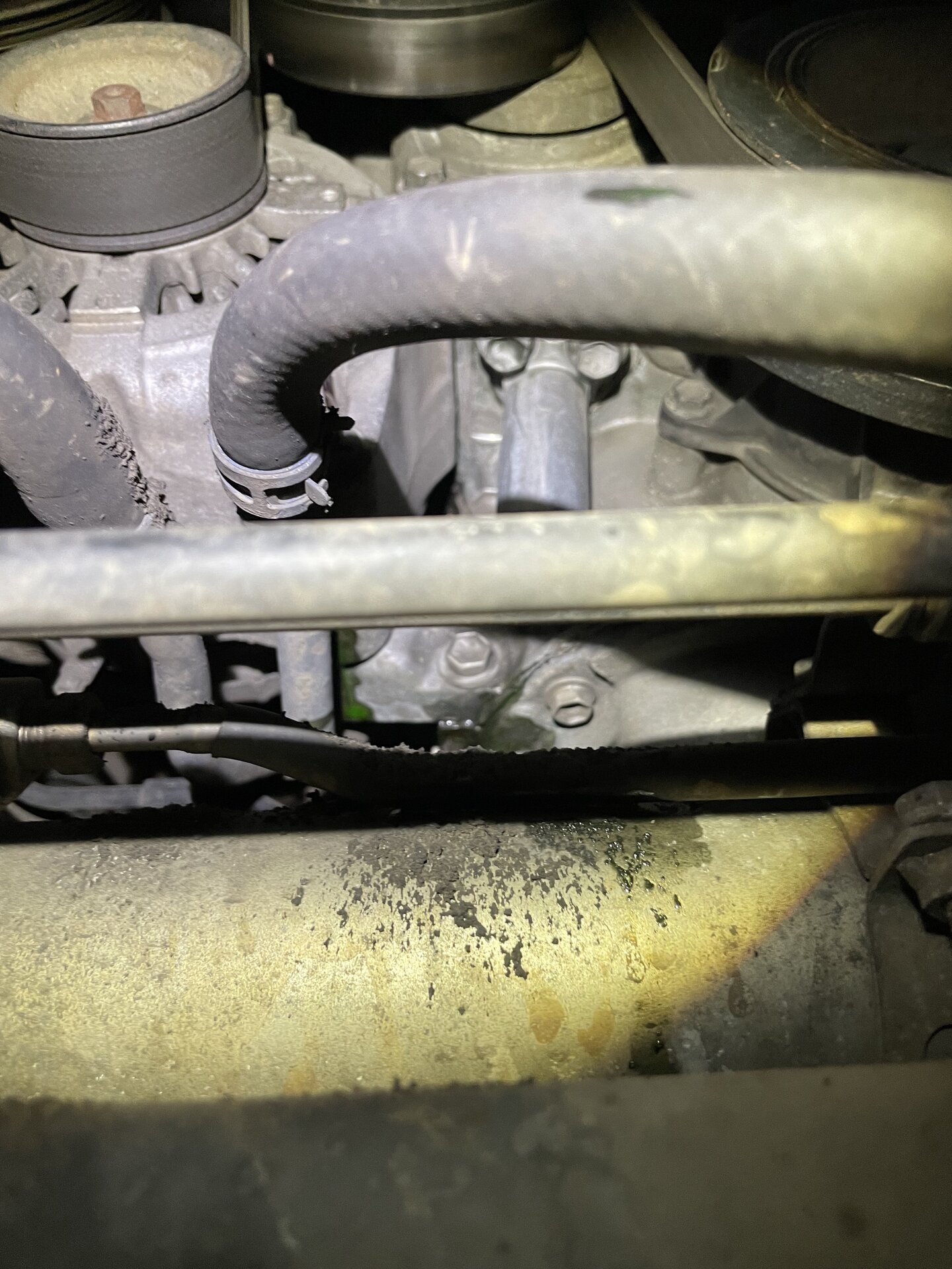

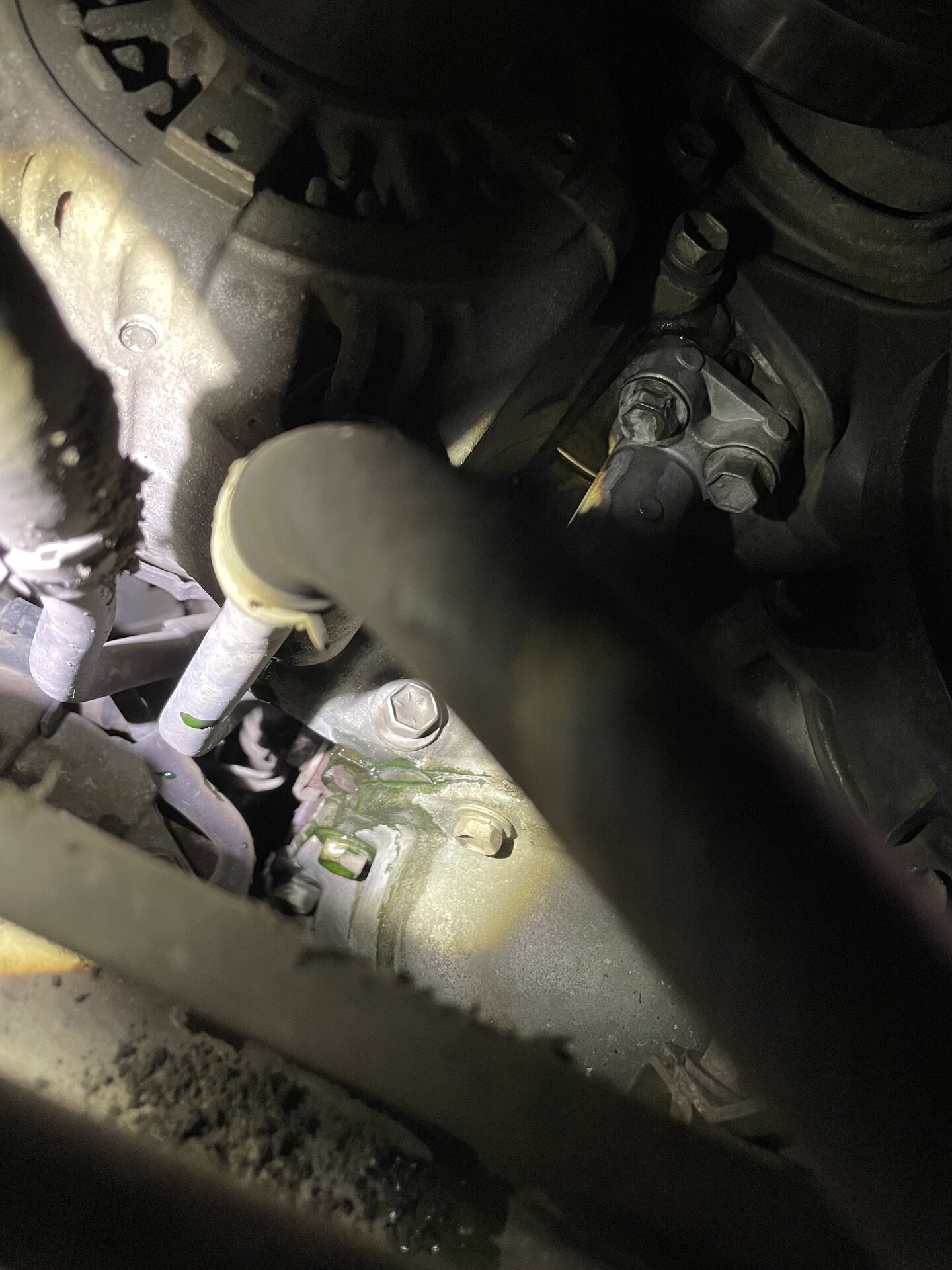

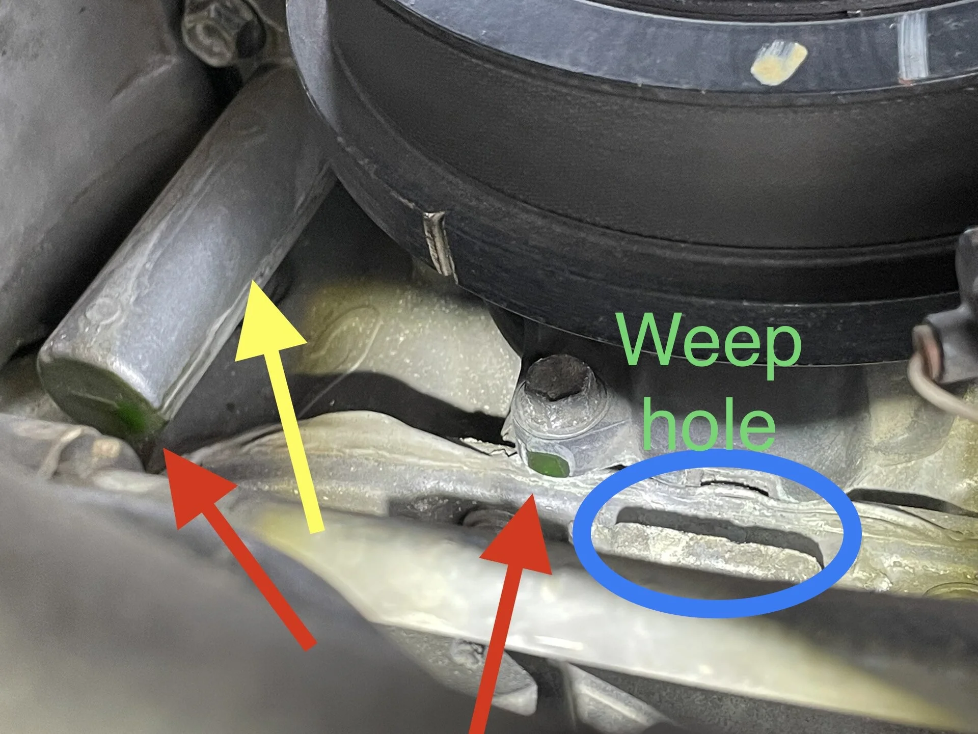

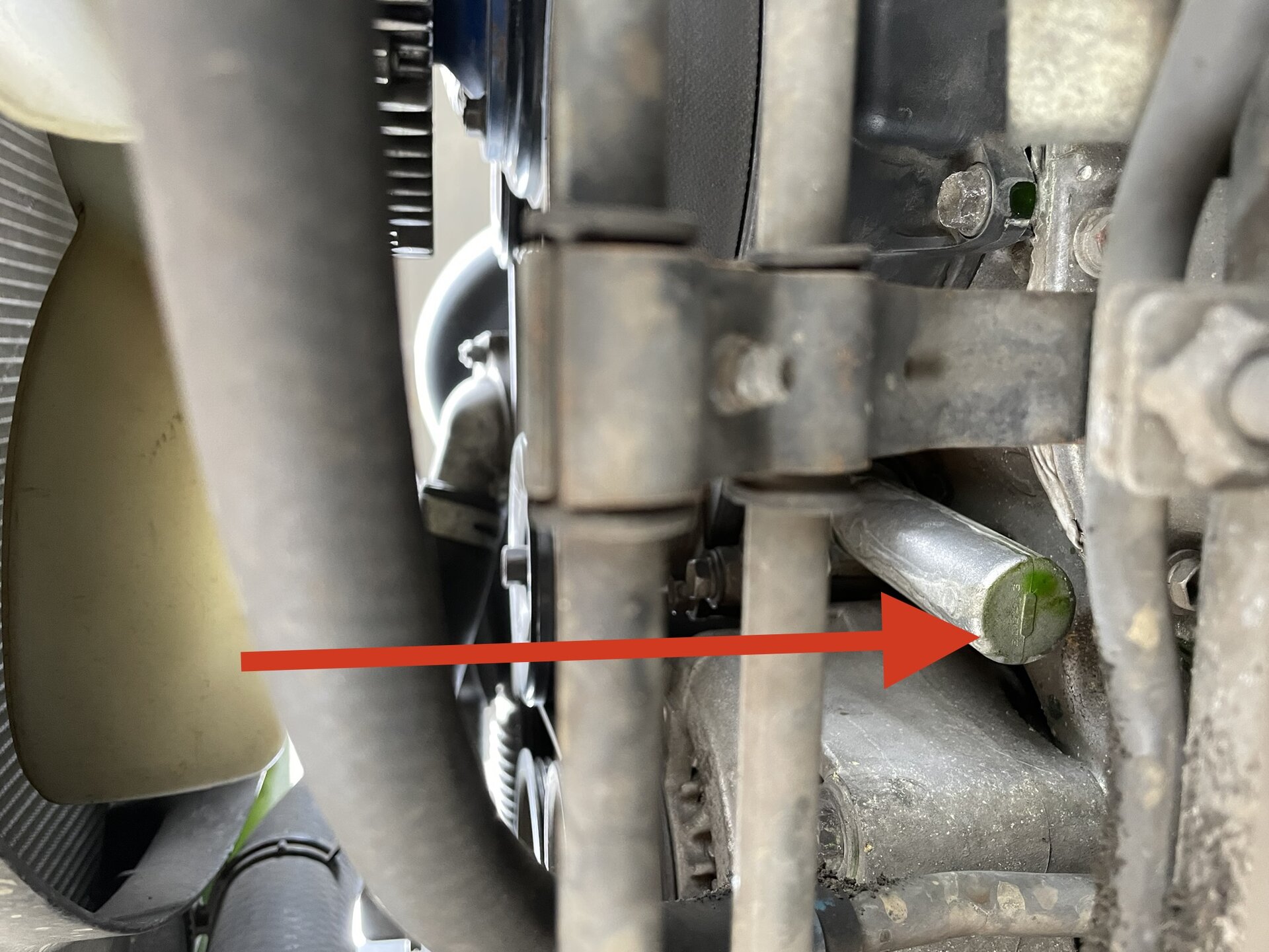

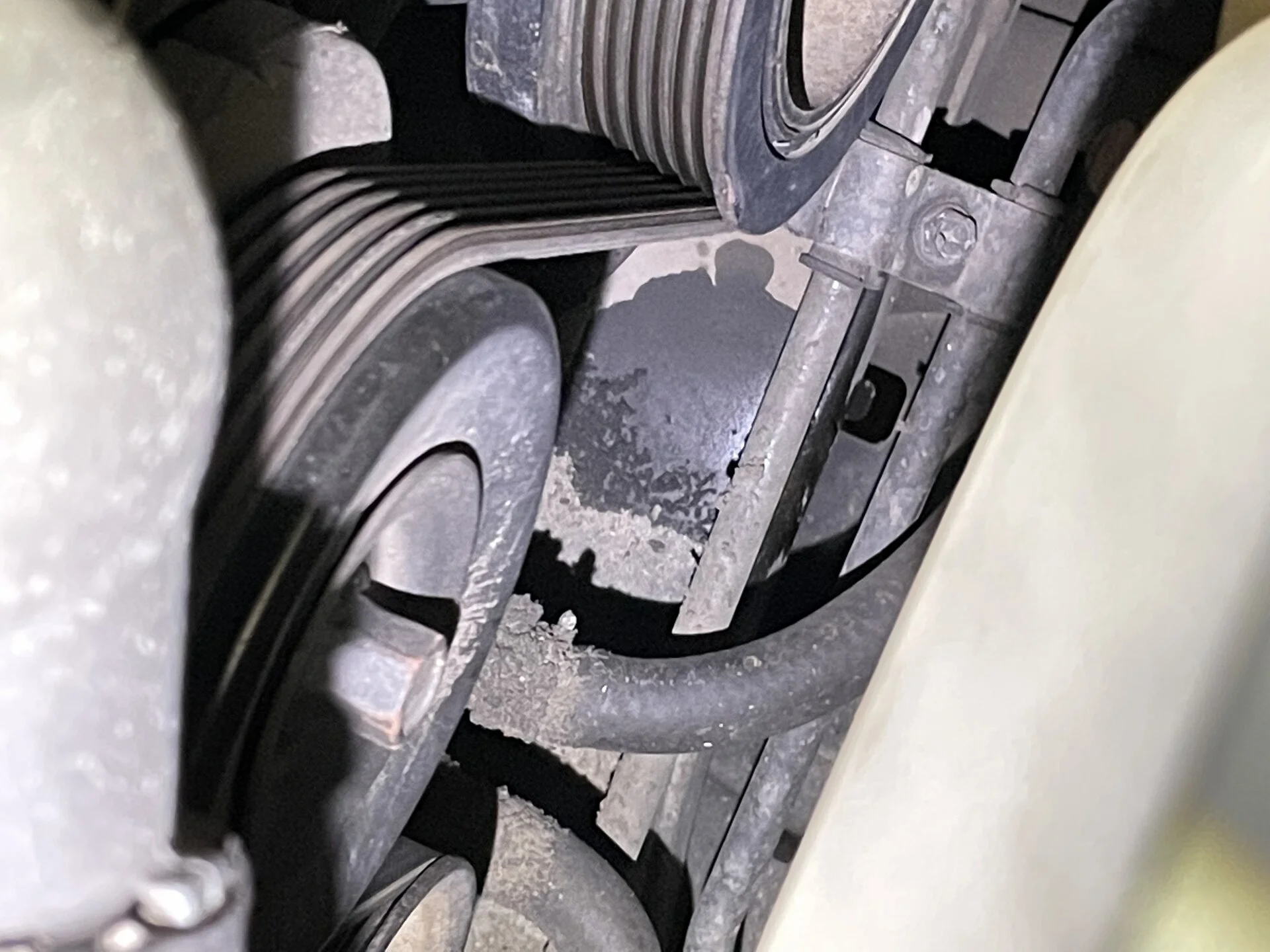

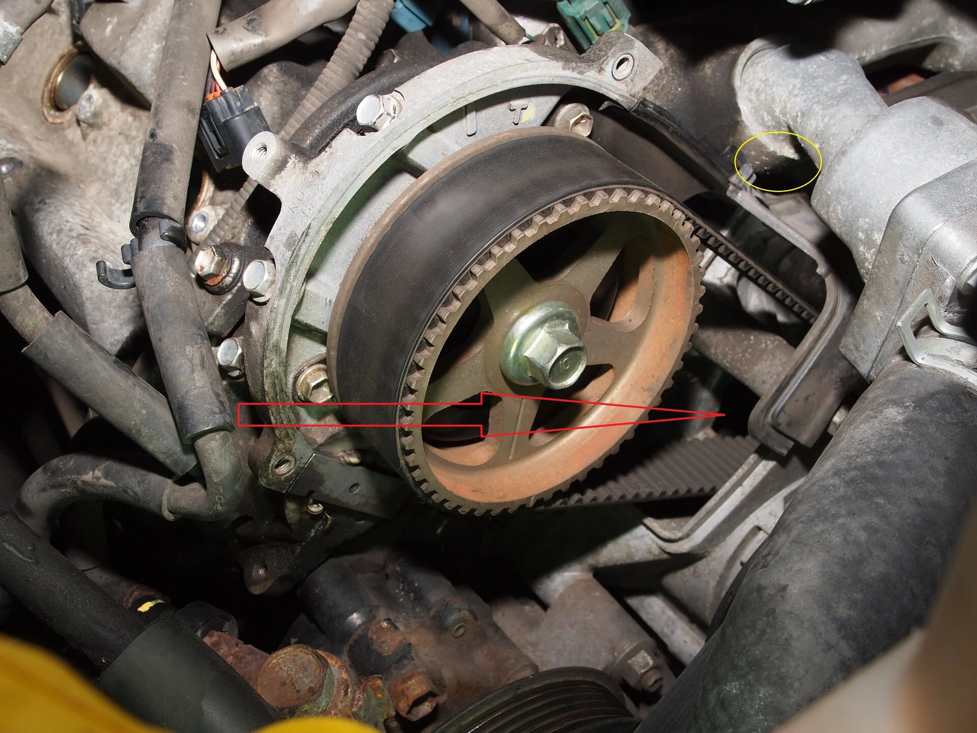

Pulled cover off finally and went for a short drive. It didn't leak quite as much as yesterday but I do see a little more clearly where it's coming from. Still need to do some research here with all the threads you guys shared but sounds like things are leading towards water pump? (red arrows are coolant traces, yellow arrows are maybe coolant?)

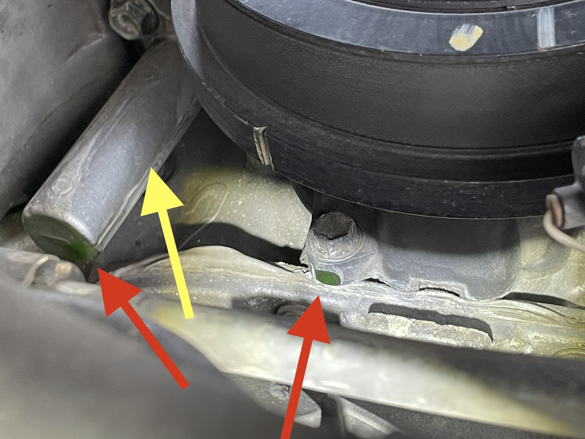

Can’t really tell from photos but if you think coolant is leaking down on tensioner from above - I suspect the underside of the thermostat housing area.
If it were water pump I think you’d first see it leaking from the weep hole and it looks dry in this picture.

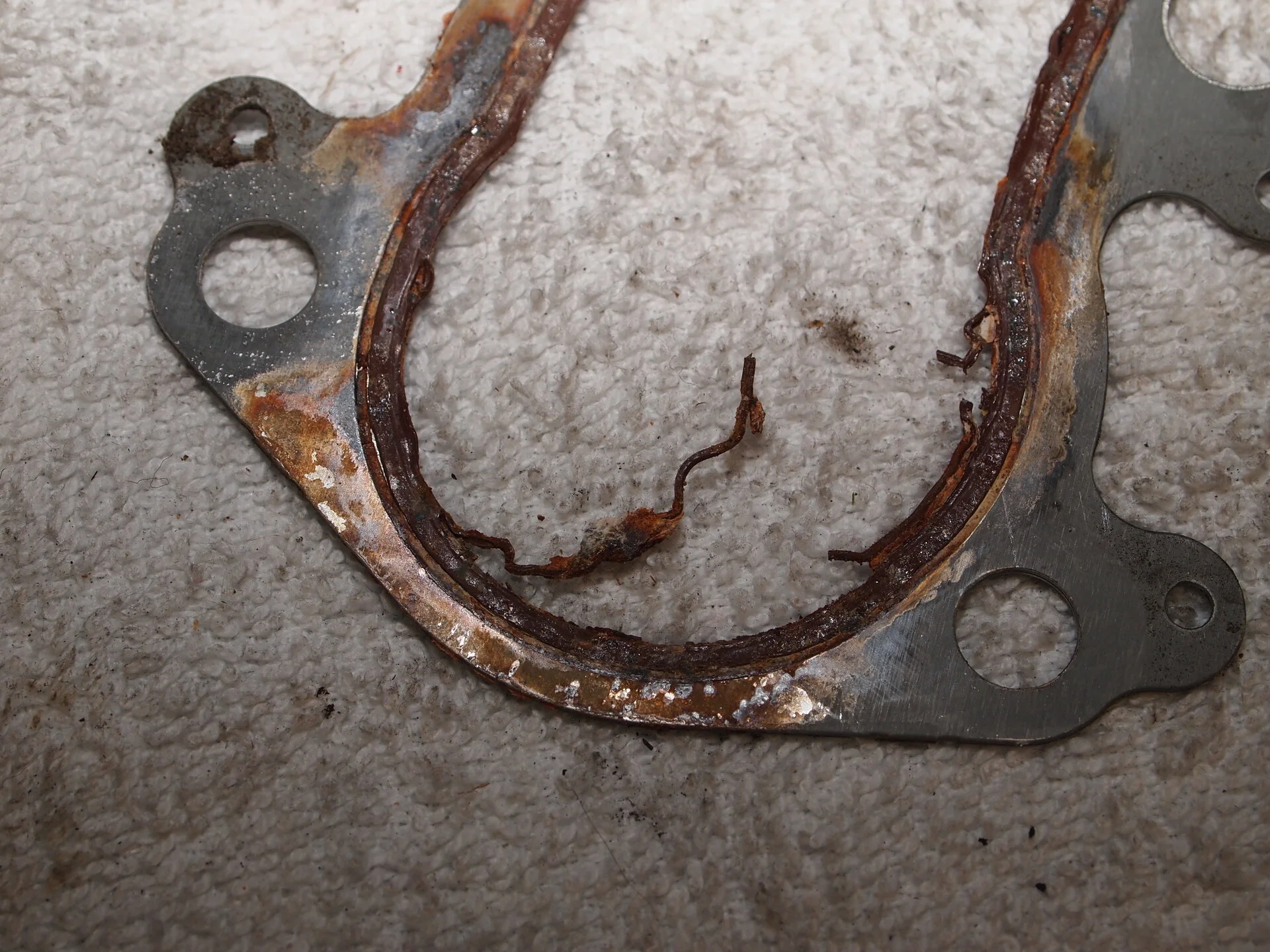

If when that last time the job was done, a new gasket wasn’t used for thermostat- it can leak there. Or where the thermostat inlet housing meets the engine- if wrong sealant used or poor prep work, it will leak. I would look closely there.
Sounds like you’re getting close.
FYI water pump is behind fan bracket- you won’t be able to see it
Can’t really tell from photos but if you think coolant is leaking down on tensioner from above - I suspect the underside of the thermostat housing area. If when that last job was done, a new gasket wasn’t used for thermostat- it can leak there. Or where the housing meets the engine- if wrong sealant used or poor prep work, it will leak.

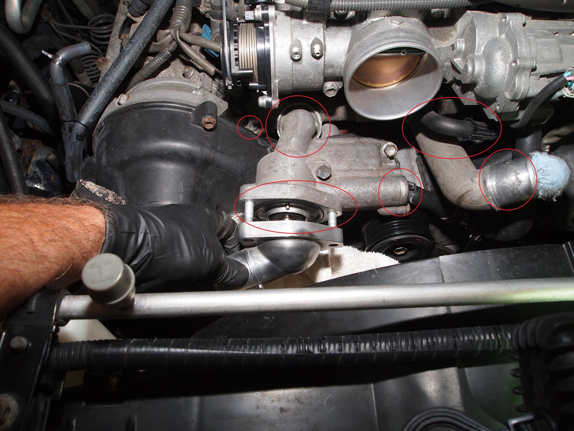

Seeing green coolant, speaks to shop you're using. Not good IMHO! One of the benefits of Toyota red coolant (LL). It leaves a dry crusts bubbly pinkish glob at leak, making finding easier.

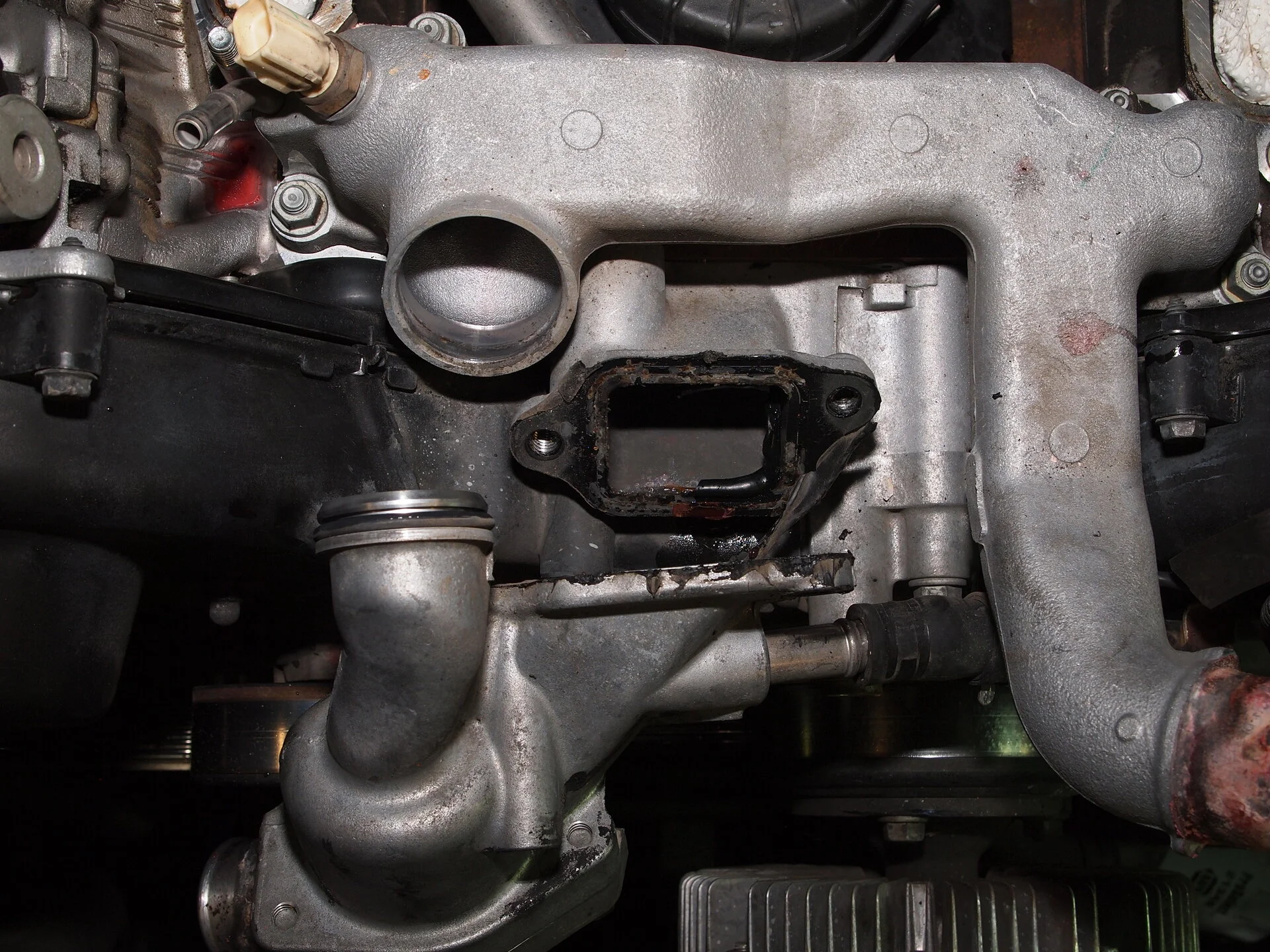

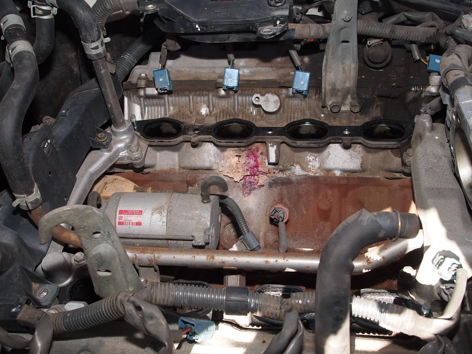

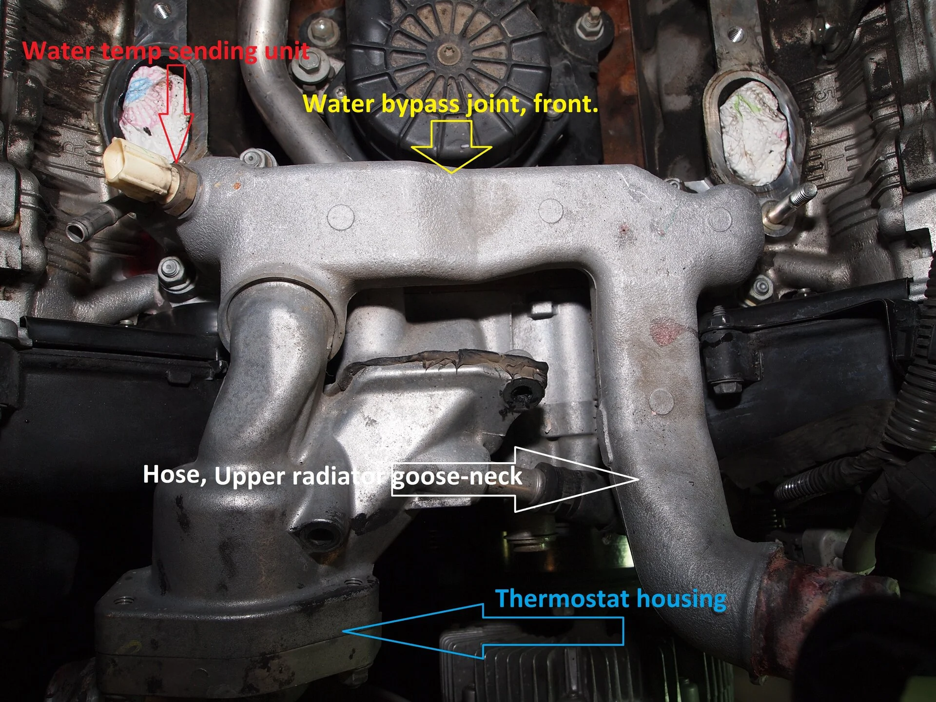

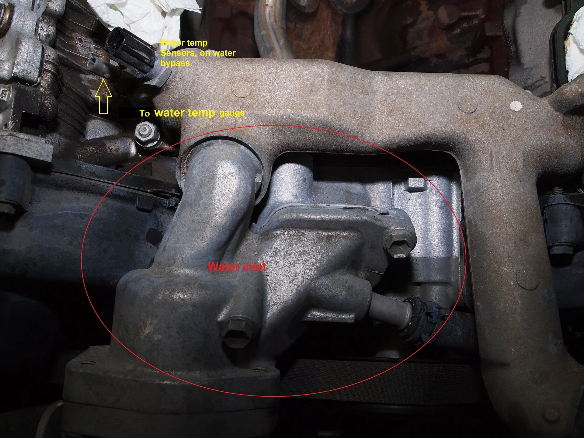

Work your way up, from green coolant drips. Focus on:
Water inlet, where it's FIPG seals it to water pump, where it's O-ring seal to water bypass front, where hose connects to it, it's cap (thermostat housing lower hose connects to). Also front water bypass, water gauge sensor threaded into it. Also hose(s) connected to throttle body.
This is picture, from a 06-07 VVT. Which water bypass and inlet are similar to the 98-02
Water bypass & water inlet

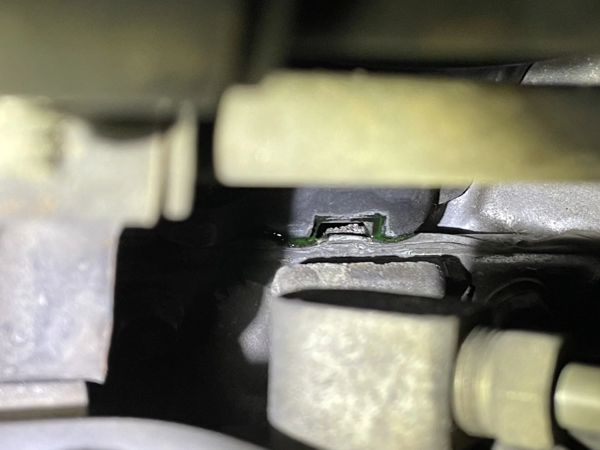

Thanks @2001LC - I keep trying to find a drip from the circled areas that you posted but I am finding it's dry all dry in those areas. No wetness at all.
I keep looking for a trace above the timing belt tensioner but it seems everything is below it. With that said, I can now see some wetness around the weep hole on harmonic balancer. The odd thing is I don't see anything below or around that. Everything else is to the side of it near the timing belt tensioner.
Any ideas here?

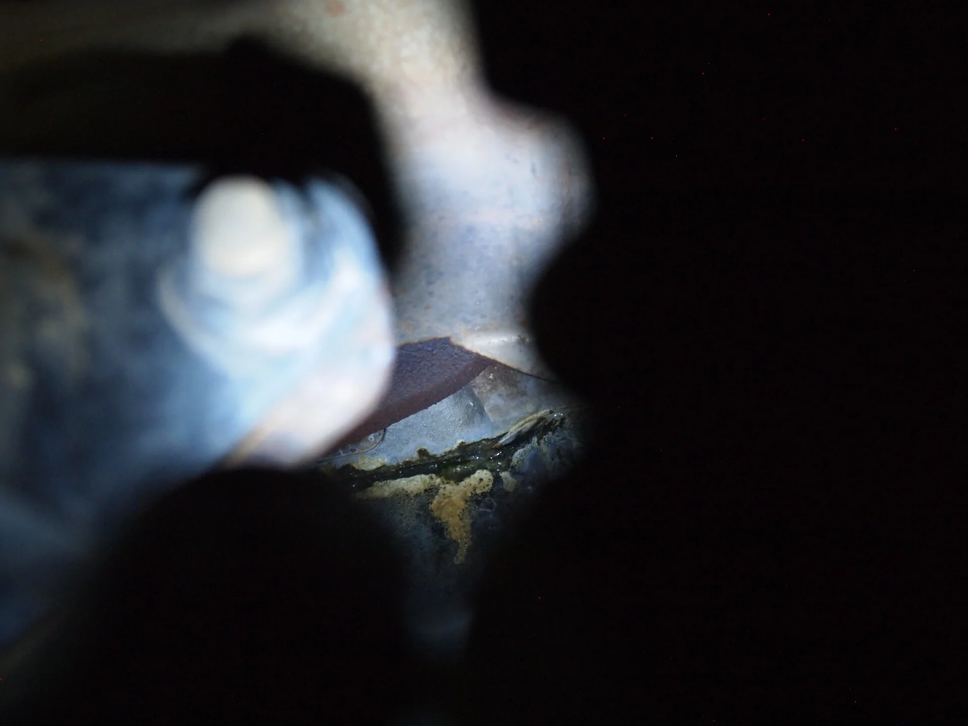

Finding coolant at front weep hole, is typically Water pump. Which @abuck99 pointed out in picture above. But be sure not from above WP, before replacing water pump..

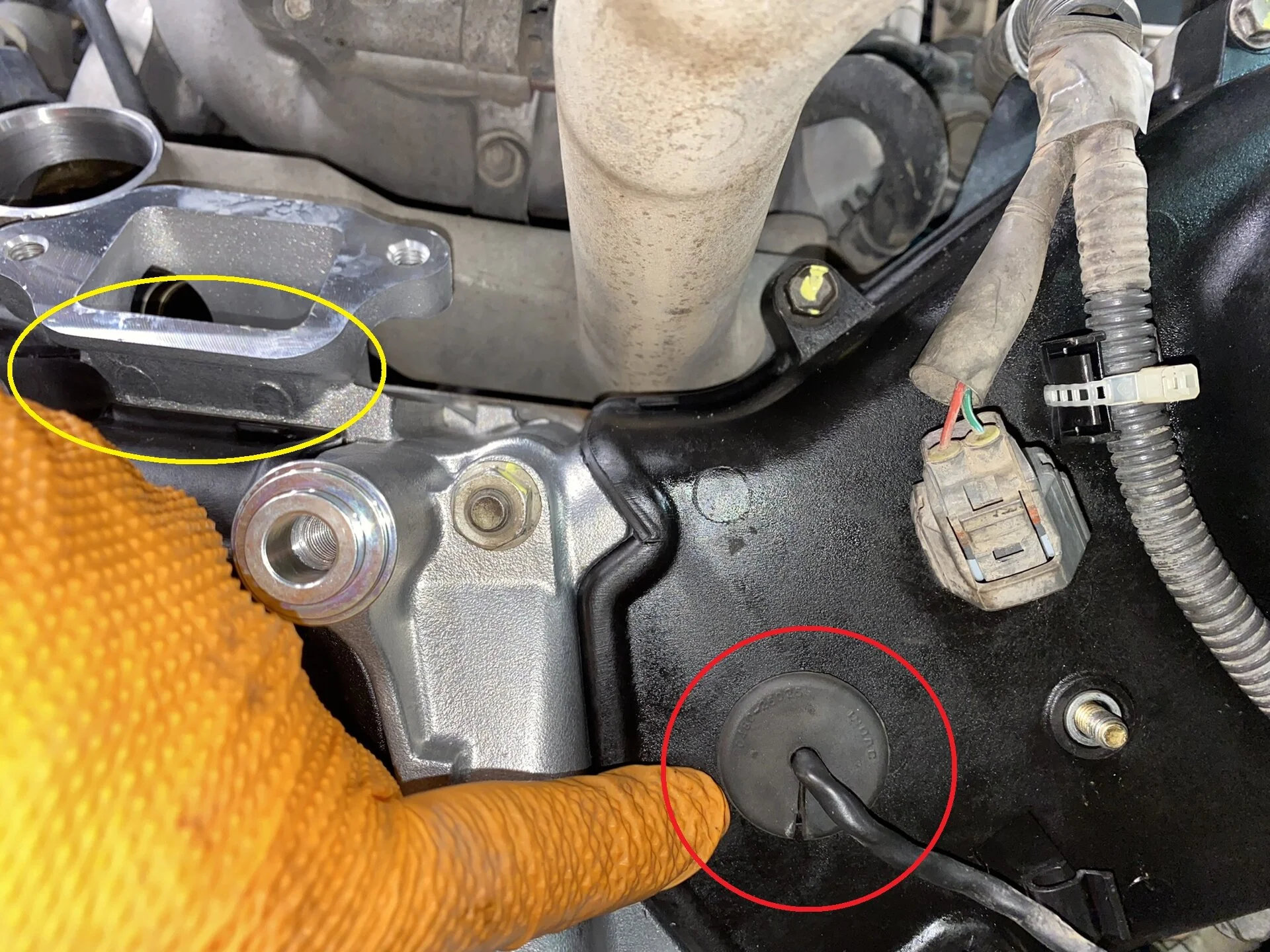

Some of those top side leaks, can be hard to spot. It helps to pull engine cover and air pipe. Use flash light, mirror and camera to see under and around water inlet, also top of water pump gasket. If still nothing found. You can pull upper RH timing cover easier than LH. I've a guild able bore-scope, I can snake around WP. Which I could also pull cam sensor wires' grommet, and snake into LH cover. Many shop have bore-scope.
Also I'll note not all Aisin kits are equal (China made boot leg) and even a real Aisin water pump can fail.

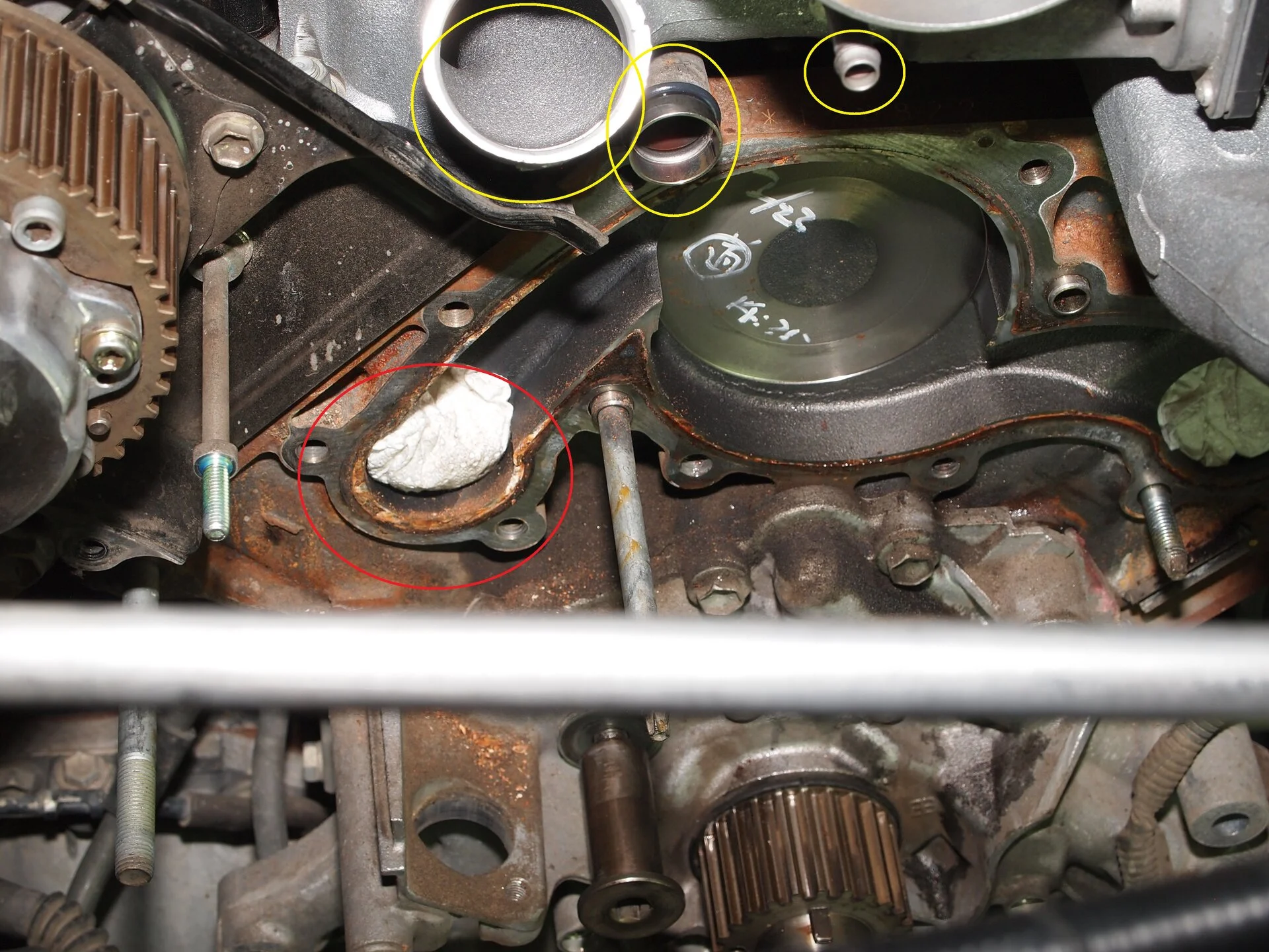

Area under inlet O-ring (yellow circle) is hard to see until air pipe off. You can see into timing belt area LH cover off, but not well without a borescope.
Under inlets FIPG seal (rectangular area circled in yellow) is hard to see. A leak here can get behind plastic t-belt cover, and come out lower weep hole.
The rubber cam grommet (circled in red) removed. Makes for fast borescope point of entry.

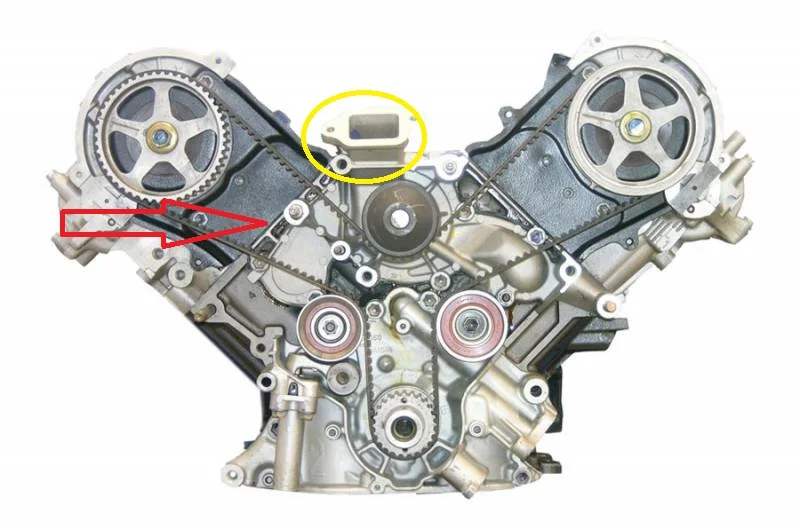

Second, by removing BK2 upper plastic timing cover. Red arrow is pointing to head gasket. I would want leak confirmed, before removing a head.
Again using a borescope, they can pin point and provide pictures of point of leak.

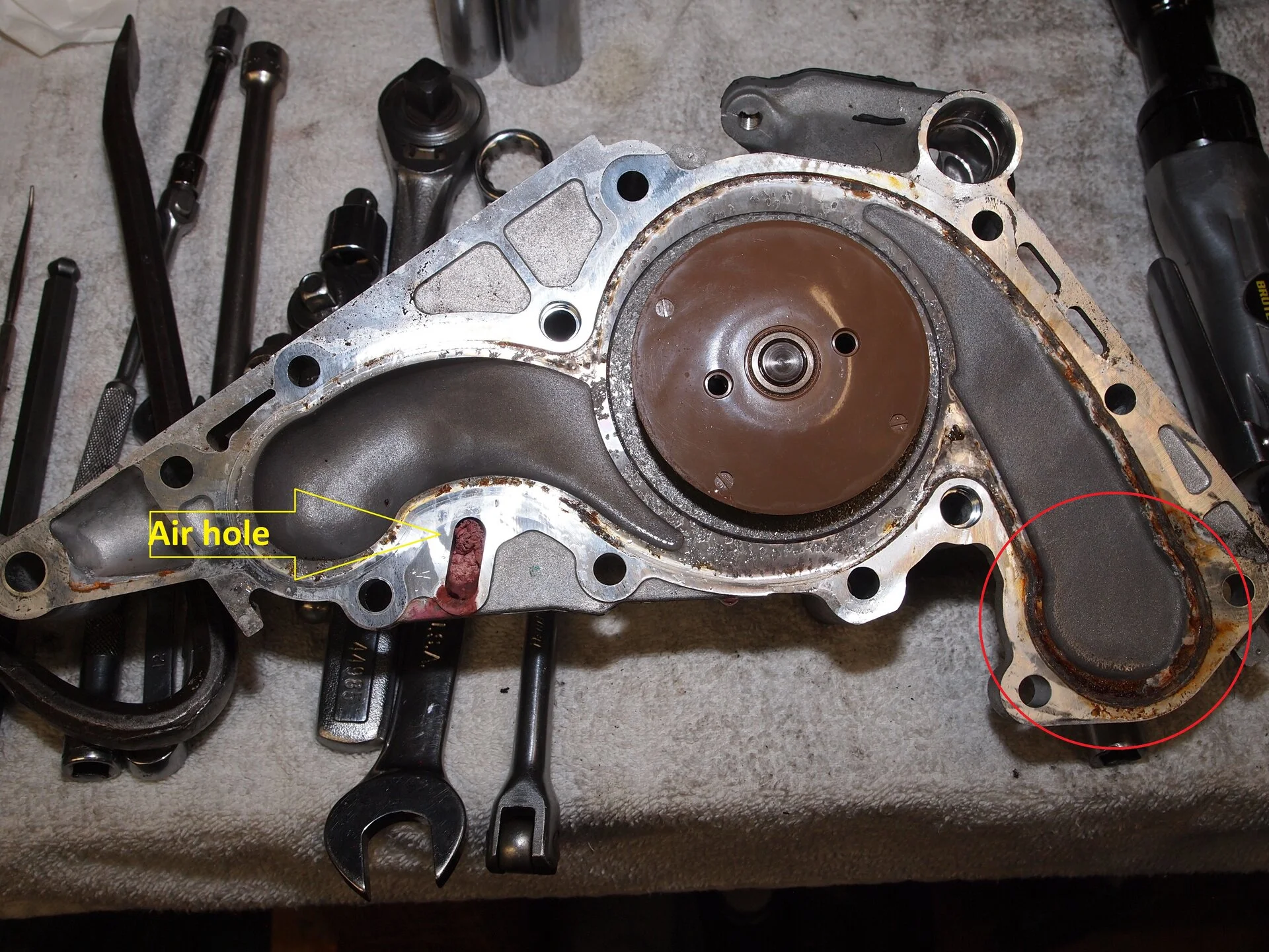

Front AND Rear Water bypass, attaches to heads at yellow circles. Water pump port for water cross over pipe goes into back of water pump (SM O-ring sealed) blue circle.
If at BK2 front Water bypass gasket (yellow), It would be seen on top front of head. SM O-ring would leak into engine valley. They "may" also flow down front of engine BK2 side.
The most difficult would be the water pump leak, but can be done with bore scope.

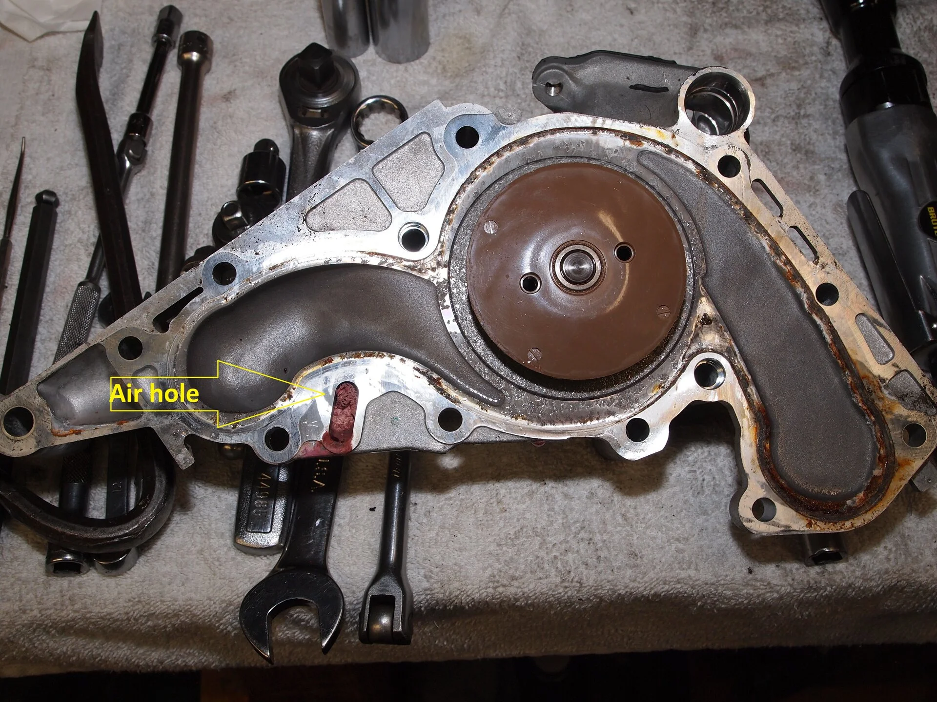

Water pump leaks, not at water inlet FIPG seal (rectangle port water inlet attaches to) or small O-ring port of water cross over pipe on back side. But actually from a water pump failure. Are most often found at of two points. First being on LH side (BK1), where there is a weep hole in water pump. Which should first show-up on BK1, just below upper timing cover. Than weep at lower timing cover. This weep hole comes from shaft of water pump. When water pumps fail, bushing in shaft goes bad, and leaks at weep hole first. Then once really bad, at drive shaft of water pump leaks.

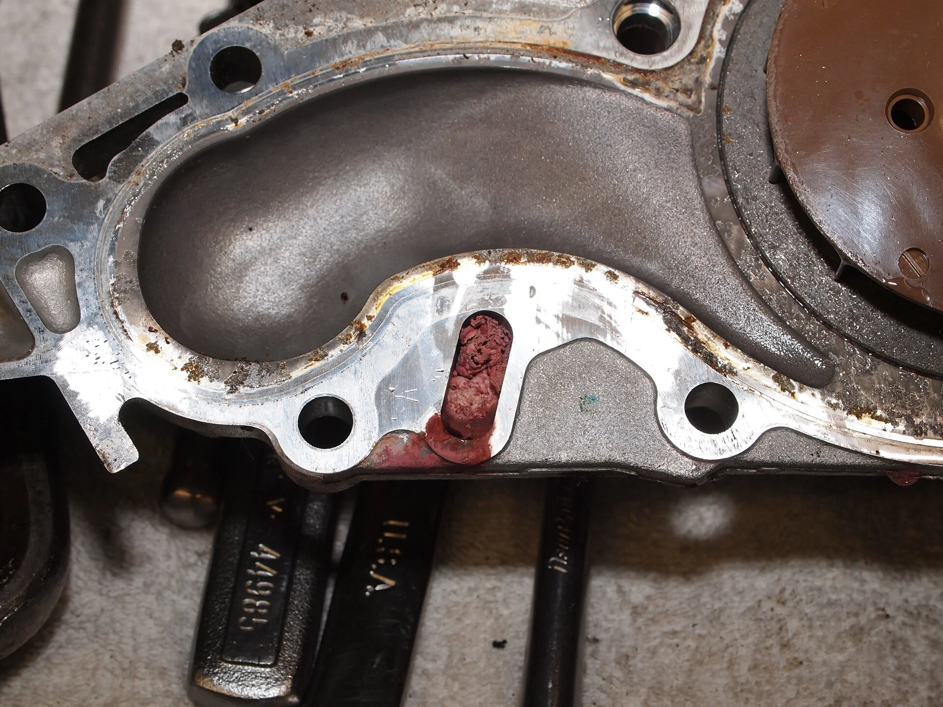

WP weep holes (on BK1) often, have some sign of weepage as seen here.
Front of block at water pump gasket BK2. Is a spot that could developed leak.
Red circle is on, BK2 side of water pump. Air hole (Weep) on on BK1
Red circle is BK2 water pump gasket side. But also notice yellow circles. The large is water bypass to water inlet port sealed with large O-ring. I see FIPG used here (wrongly so) which it should not be. Which often results in leaks. This too would show-up on front BK2 side of engine. The next medium size yellow, is small O-ring of water cross over pipe, going into back of water pump. This may leak down front of BK2.. Next is a small water tube on throttle body. Leak hear may would flow down front of engine.
