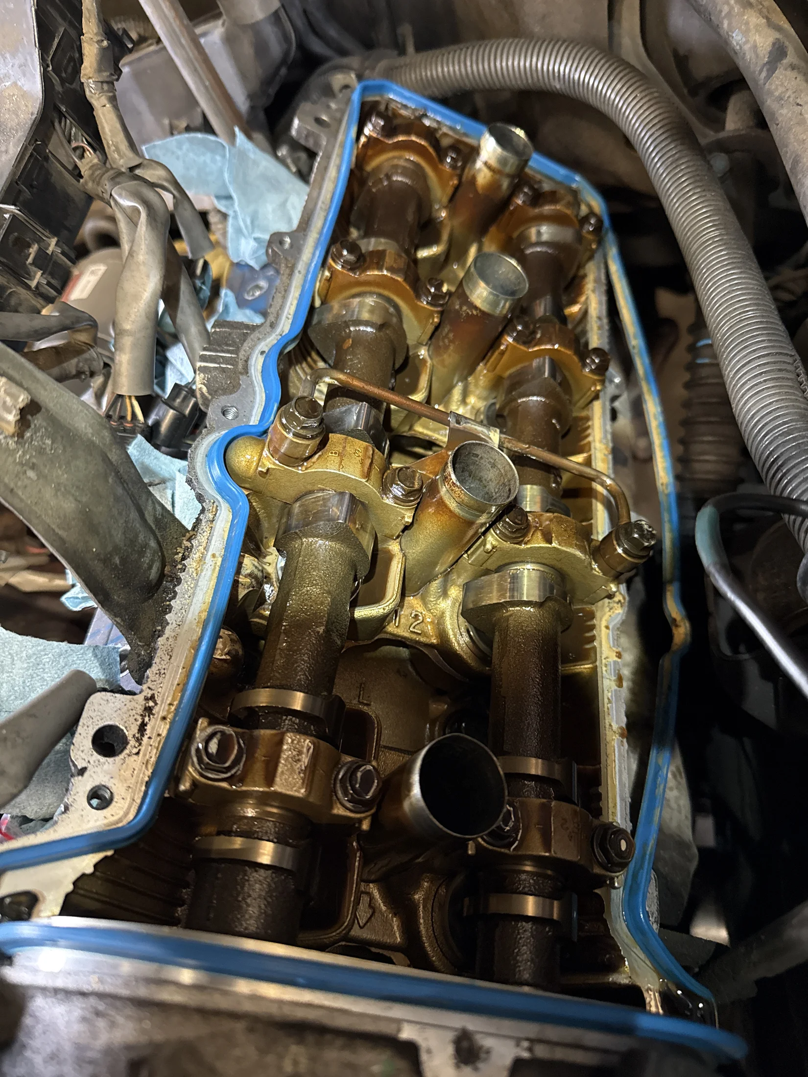

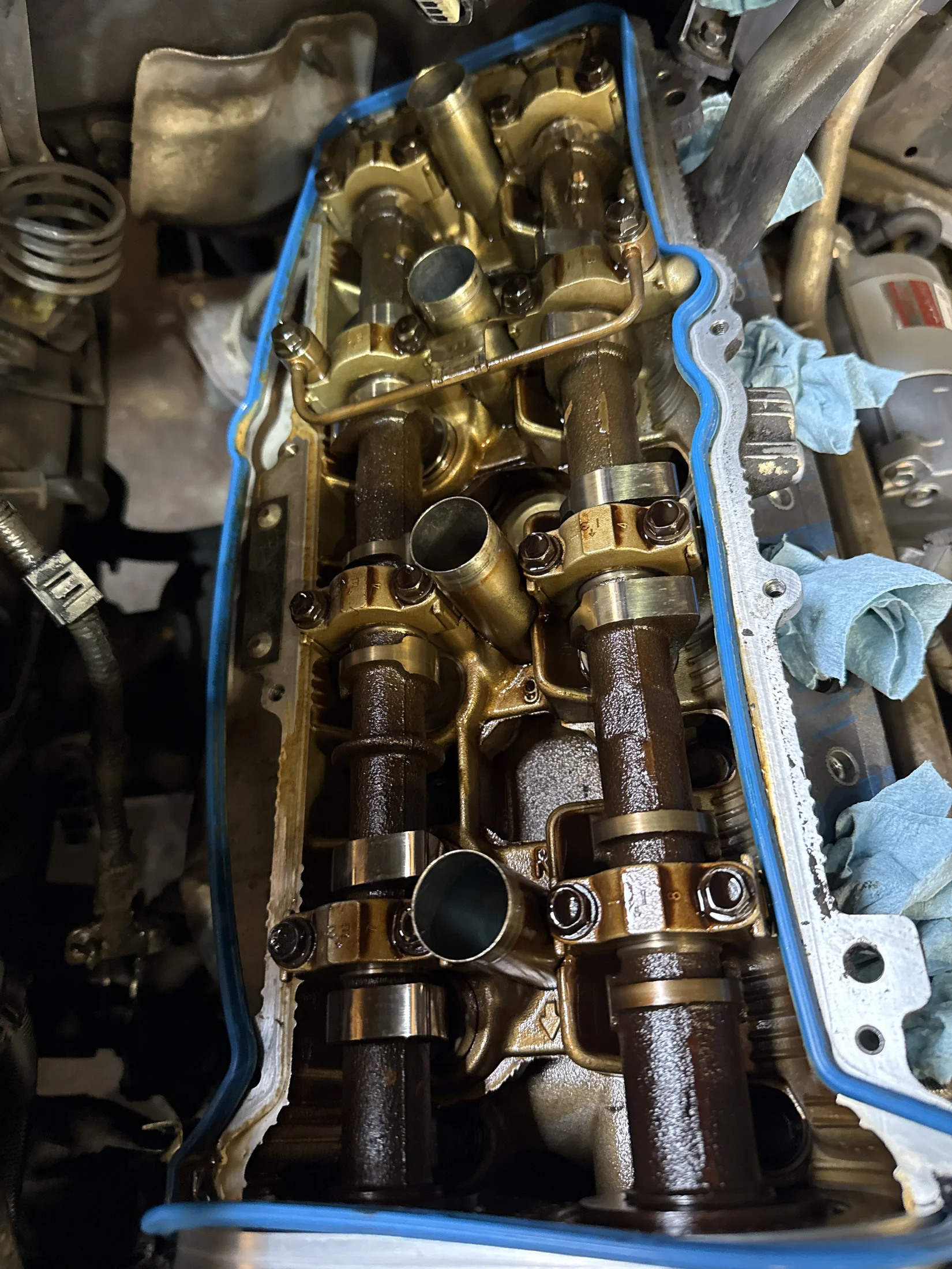

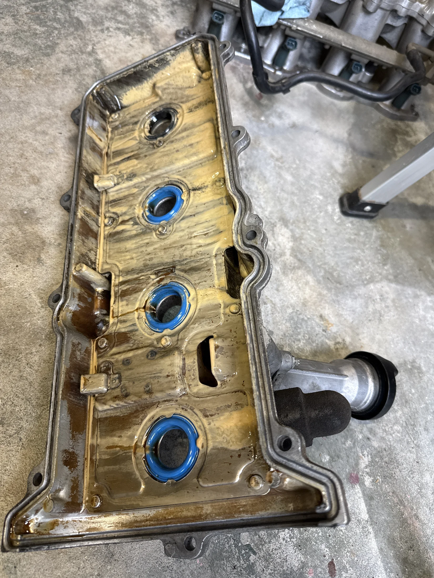

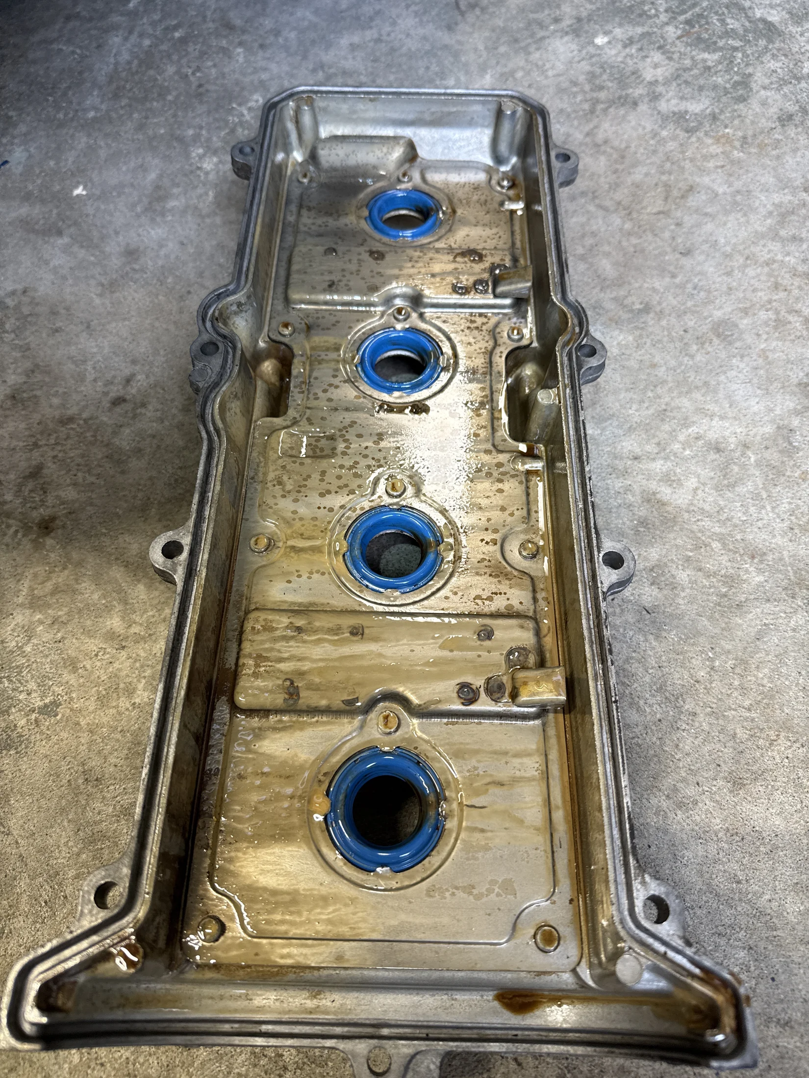

Just a thought, the intake manifold, thermostat and valve cover gaskets were recently done. With the leak appearing after the valve cover and intake manifold. Do you think the gaskets are leaking into the engine? I’m going to start taking it apart this week hopefully but everything is pointing to it not being head gaskets but something else.
Oil cooler may be a source as well.

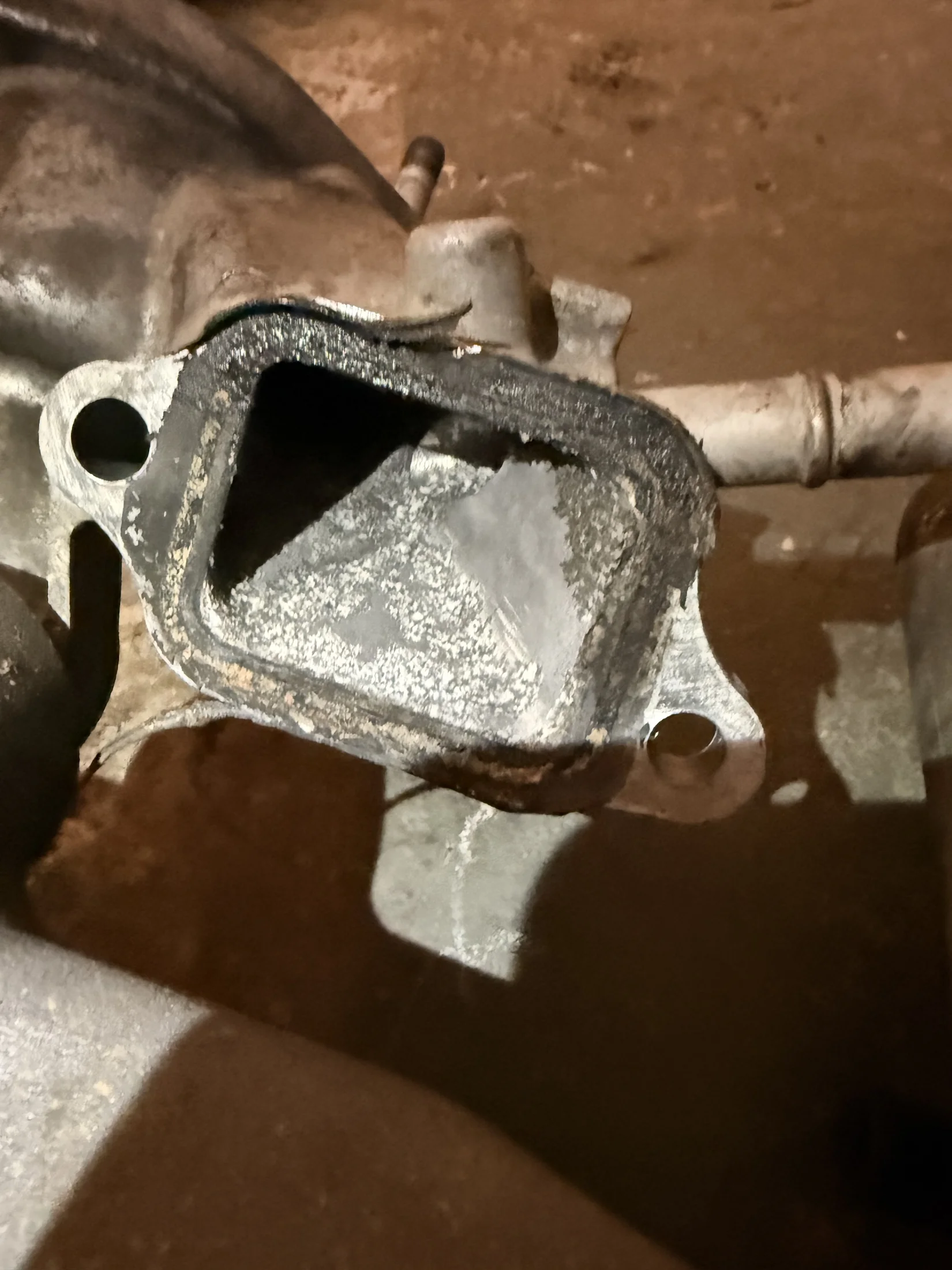

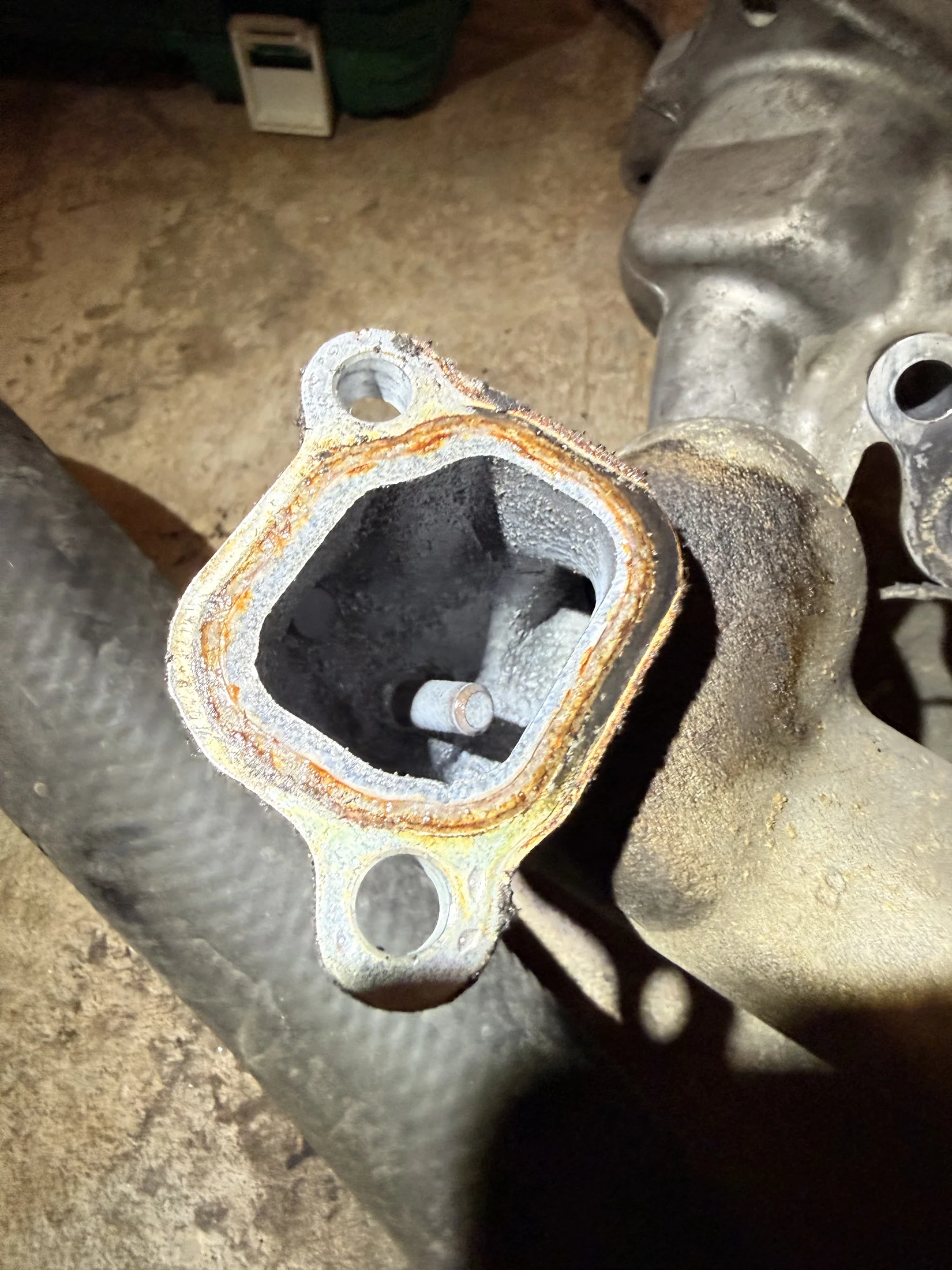

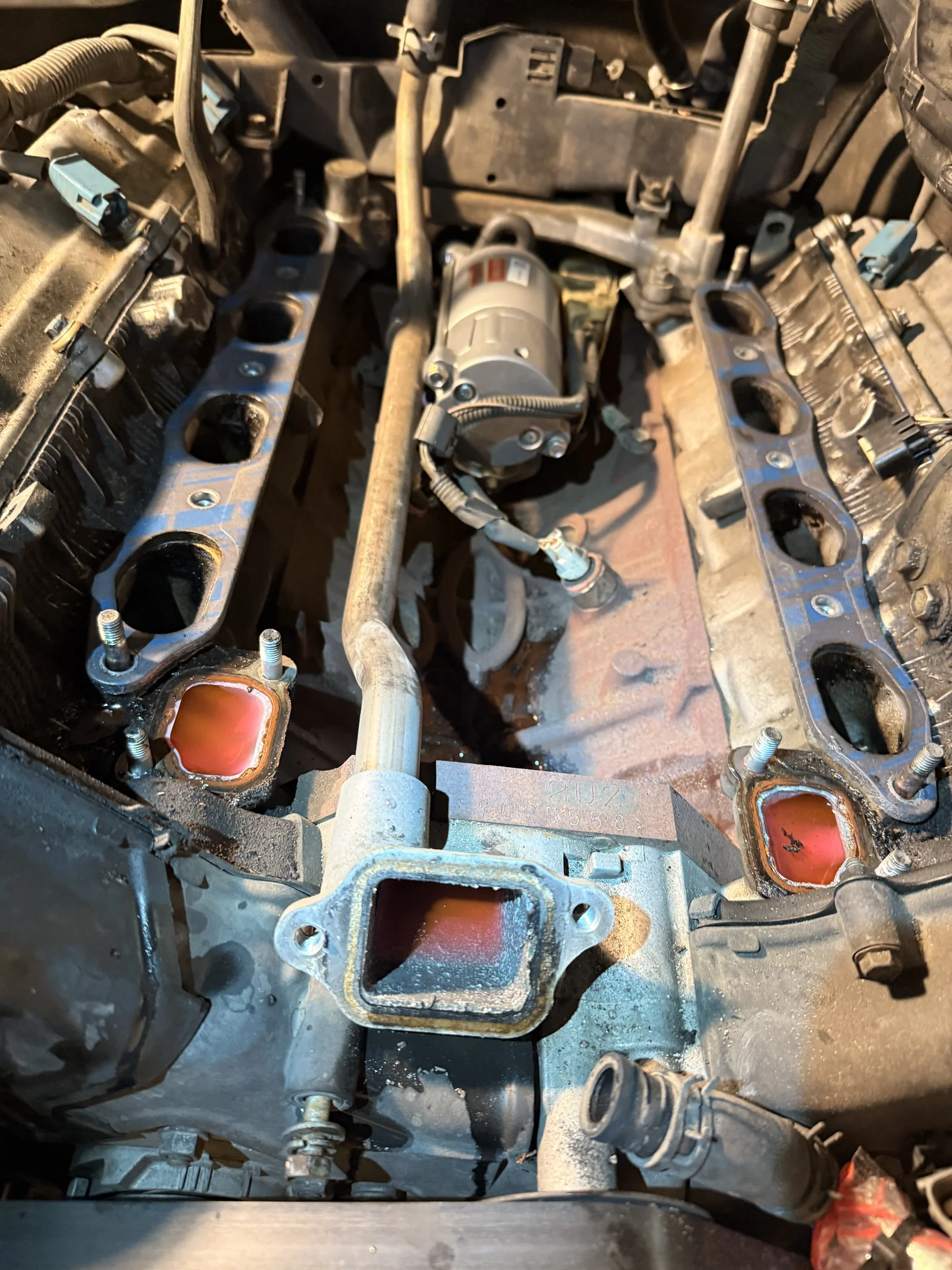

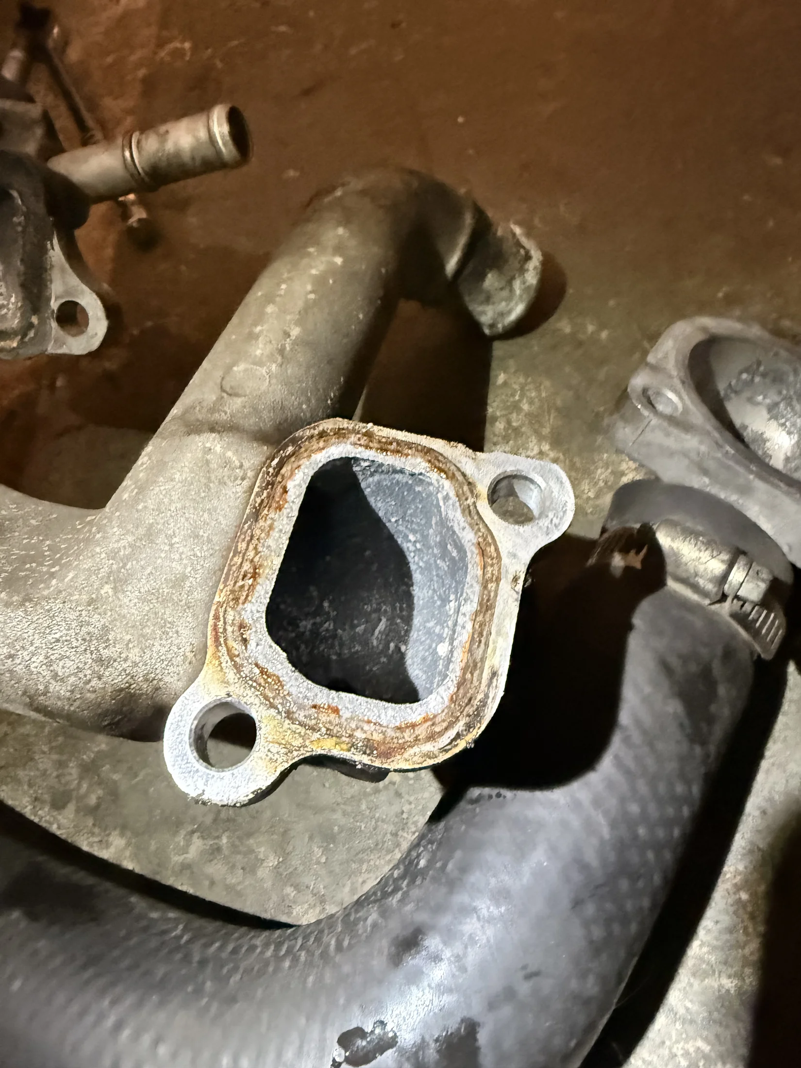

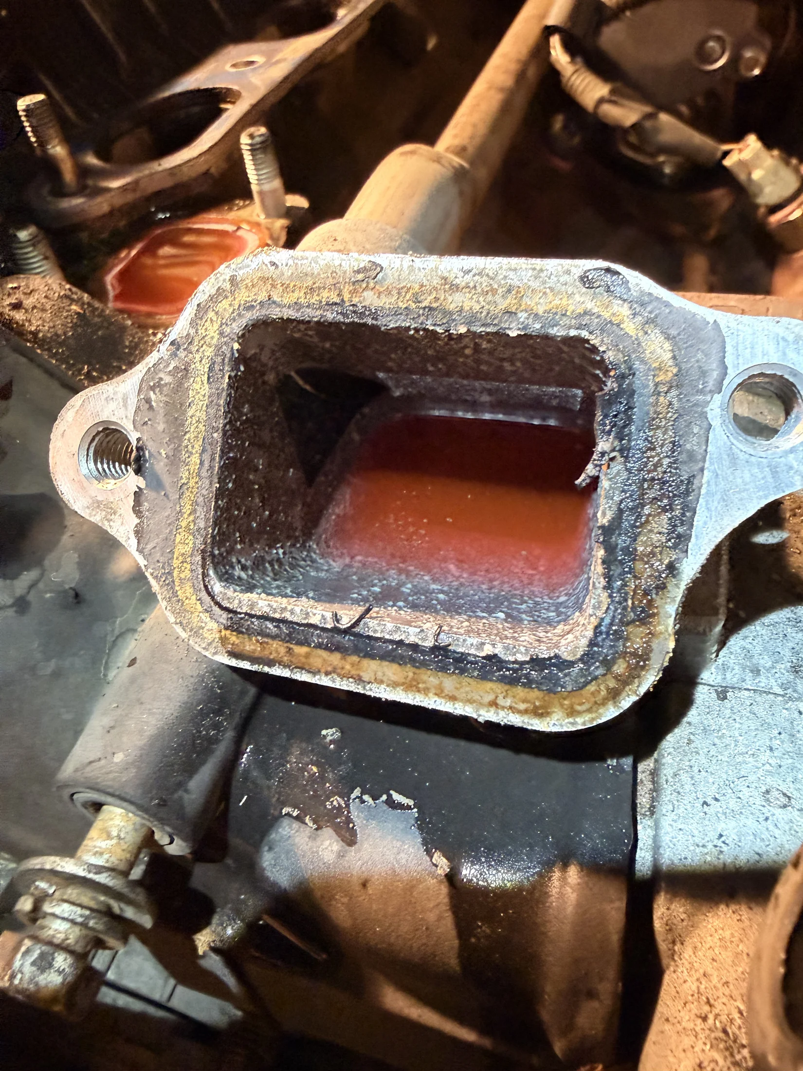

Pulled the intake manifold and thermostat/water inlet off. There’s a bunch of gross buildup in the water inlet. Looks like the gasket failed?
Anyone have experience with stone head gasket kits? Theres a few hundred dollar difference between that and OEM kit. Also, any tips for getting some of the buildup out of the coolant passages?
