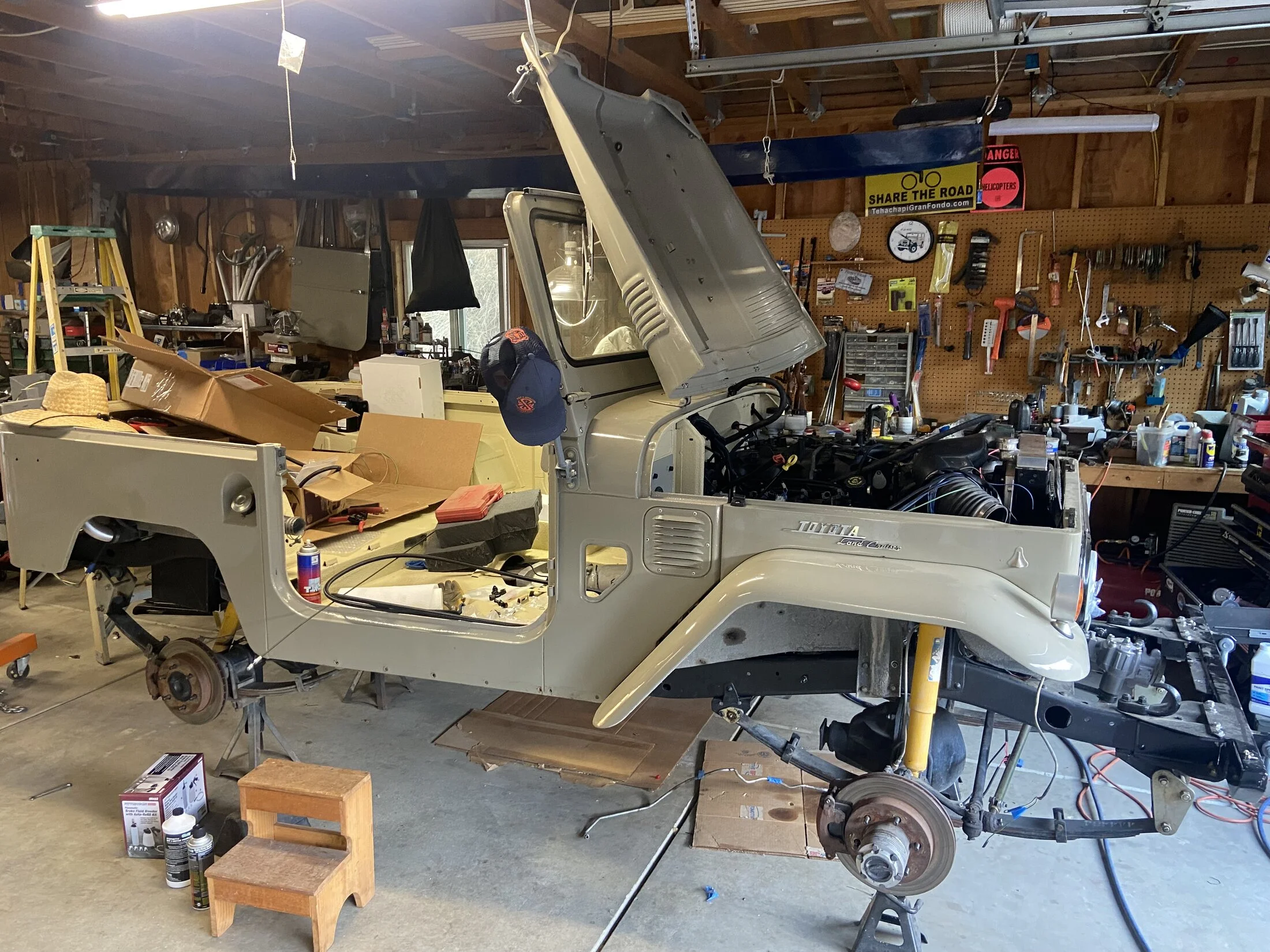

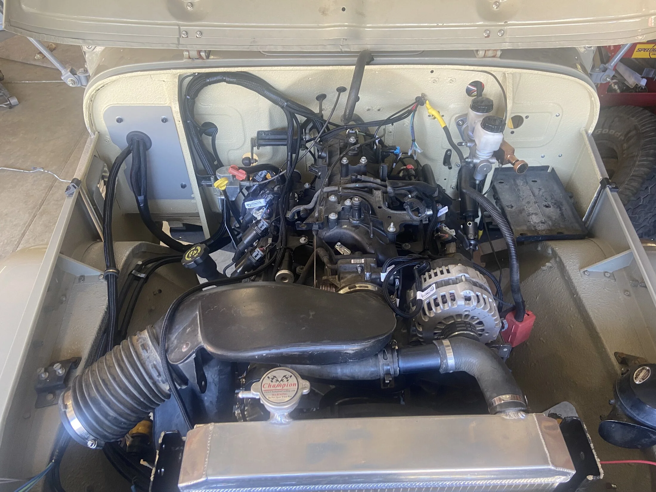

I went through the same thing. About 80% through the process of swapping in a 5.3L /4L60e combo. It is a ton of work but coming out nicely. It’s under Fix or sell: 1967 FJ40.

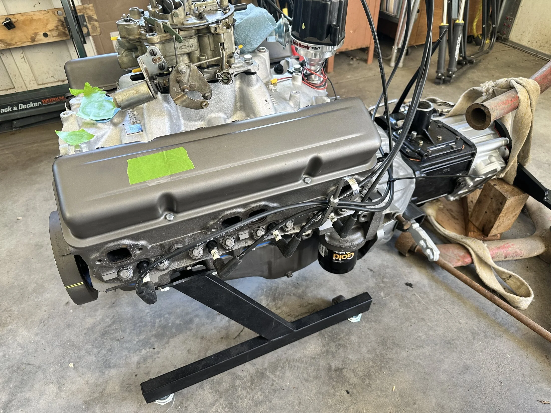

I like all the above, have a 350 SBC in mine with a 4 speed from a 1977. If I were to do it over I would go H55 5 speed transmission with split case instead of 4 speed mated to the 350.

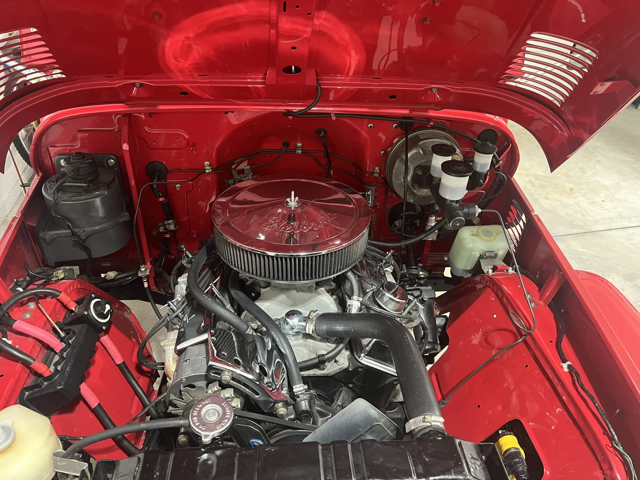

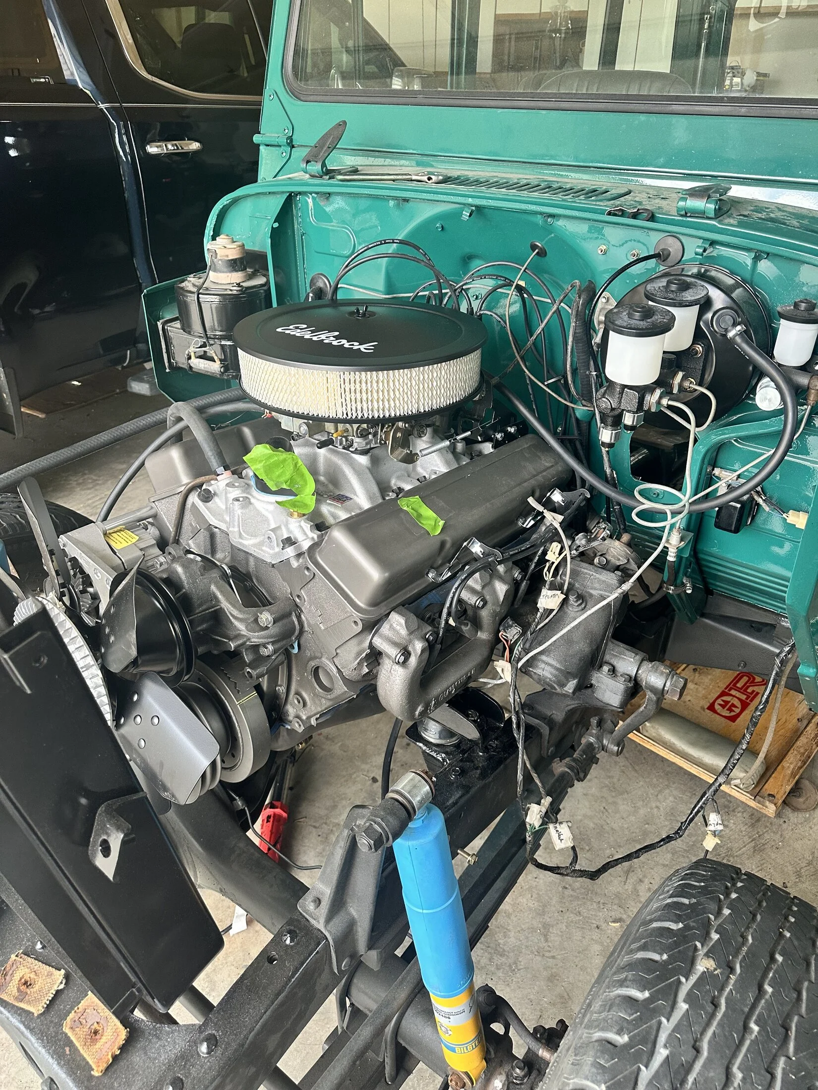

Just completed my restoration with a Chevy sbc V8 5.7l. had my first good test drive Wednesday with no overheating issues. I went with a new four core radiator and mechanical clutch fan. Used the 3 speed and transfer case.View attachment 3725424View attachment 3725422View attachment 3725423View attachment 3725427
Nice job! Looks great! I see you stuck with a stick shift. My whole purpose for considering a V8 would be to change to an automatic transmission due to surgery on both hips and low back years ago, and my wife doesn't want to drive a stick shift (that could be a bonus, LOL).

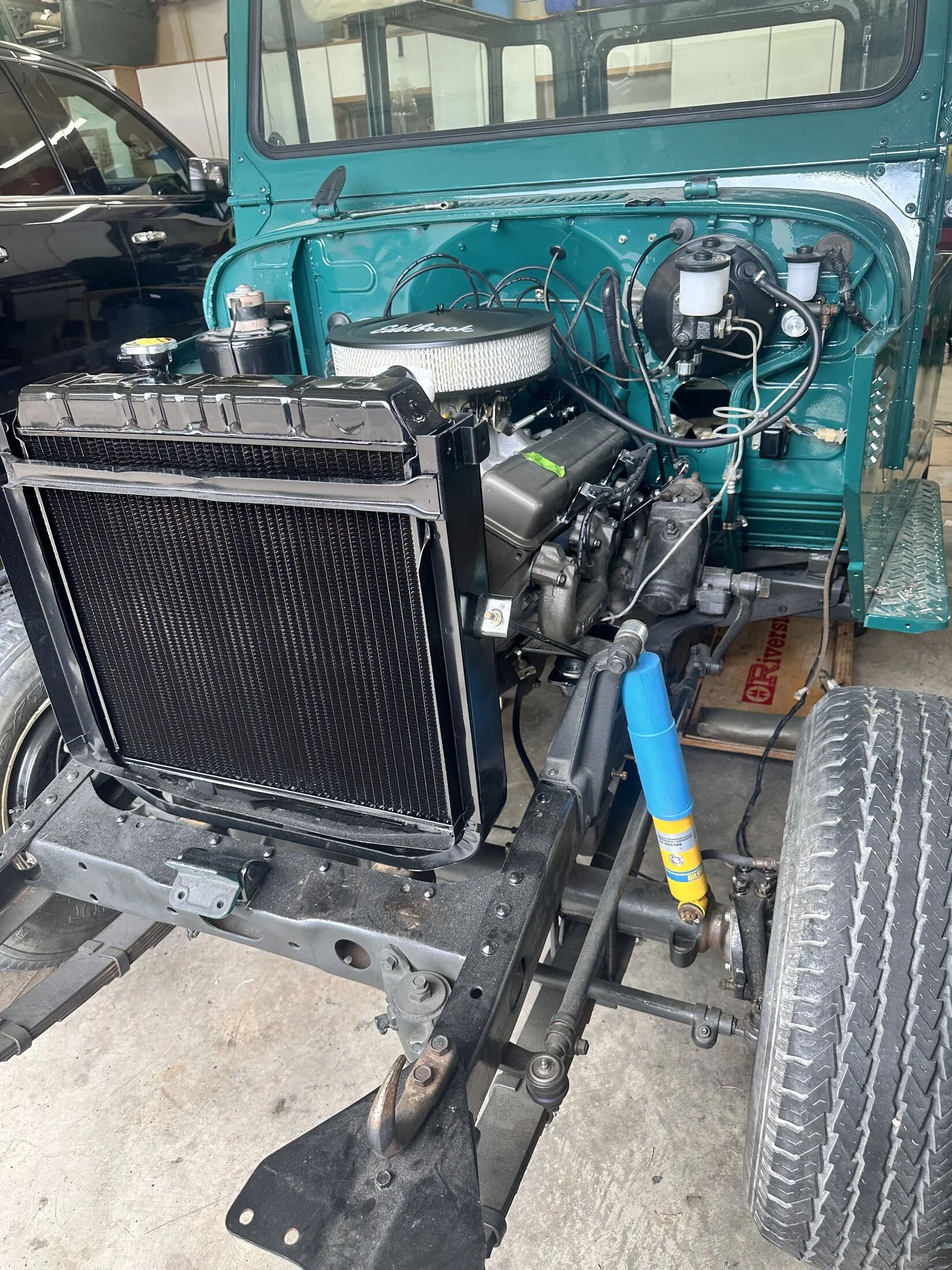

I've been running a factory radiator since the mid 80's and it keeps the 350 cool. A good shroud is the secret.
A slight correction, I did have to re-core it some time back. I stuck with 3 core as space was a concern.
