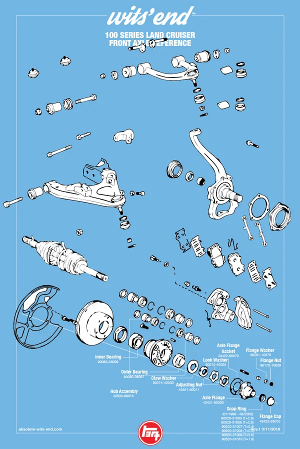

Reposting @NLXTACY 's handy axle cheatsheet.
Snap Rings?
Axle Flange Gaskets?
Adjusting (lock) nut?
Lock Washer?
Claw Washer?
The bearings themselves?
Just order Cruiser Outfitters wheel bearing and snap ring kits, call it good?
Do I need the Slee special tool for spindle greasing?
Or just hope for the best and just repack?

I've been in the hubs a few times either to service bearings or replace rotors. I haven't swapped out my bearings or races because they look fine and aren't making noise. If you want to replace yours to simply start with a clean slate, go for it, but you may find they have more life left.
While in the hub, I've always replaced the oil seal, flange gasket and the snap ring. The snap rings come in varying thicknesses so it's nice to have a variety in the garage. The lock washer and claw washer can be reused as long as they're not damaged (I've replaced mine, but not every time the hub is apart).

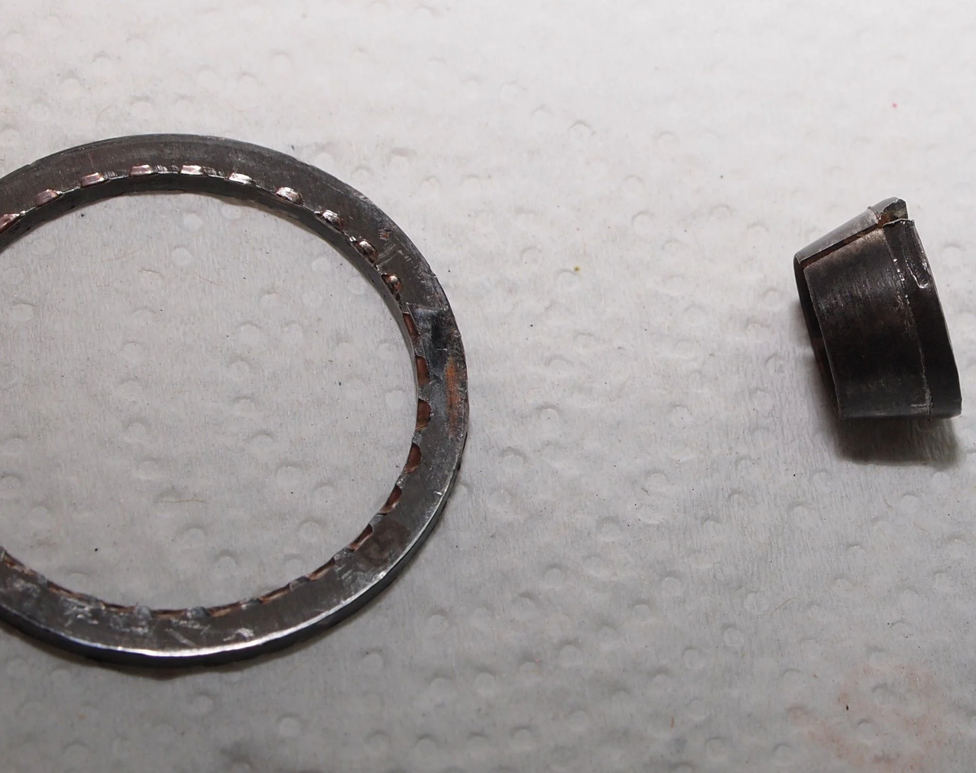

The most worn item was the claw washer.

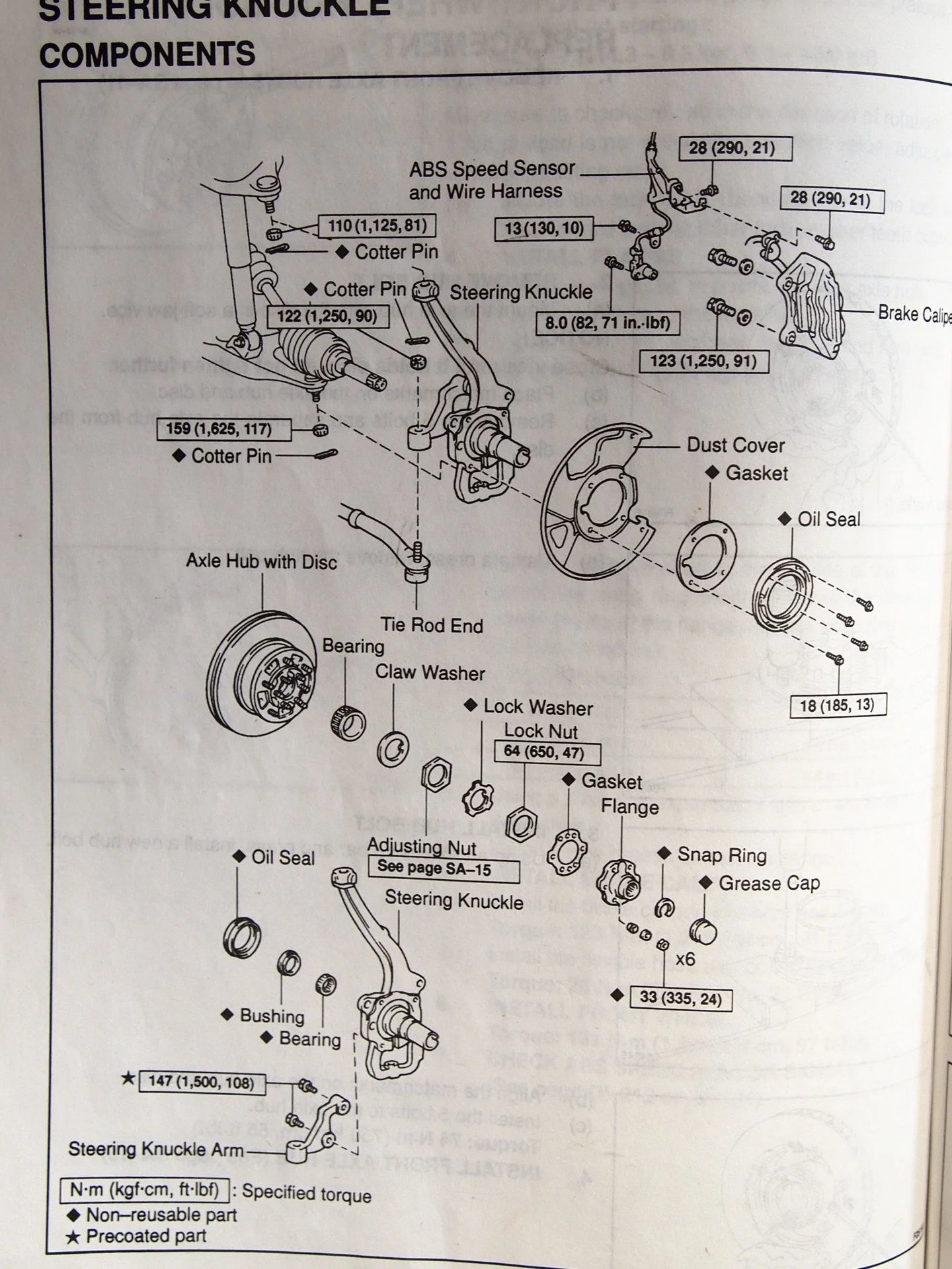

If not pulling steering knuckle (I like to first time in. Too recondition along with inspecting, clean and greasing & needle bearing & bushing. This includes replacing oil seal in back of knuckle 90316-A0001 and new Cotter keys for ball joint nuts that have been pulled).
You'll need:
Solvent (De-greaser).
Tub of grease (wheel bearing grease, is a high speed grease)
Oil seal 90311-70011 (you can reuse if in perfect condition, but best practice is to replace)
Locking washer 90215-42025 (can reuse old, if two tabs that have never been bent are found in usable position)
Hub Flange gasket 43422-60070 (these are often reusable if carefully removed)
Hub flange Snap ring (likely will need a "D" which is 2.4mm 90520-31007, possible a "C" 2.6mm 90520-31006)
Some extra to consider:
Claw washer will most certainly be scored on inside if wheel bearings have never serviced properly. You can flip good side in, scored out.

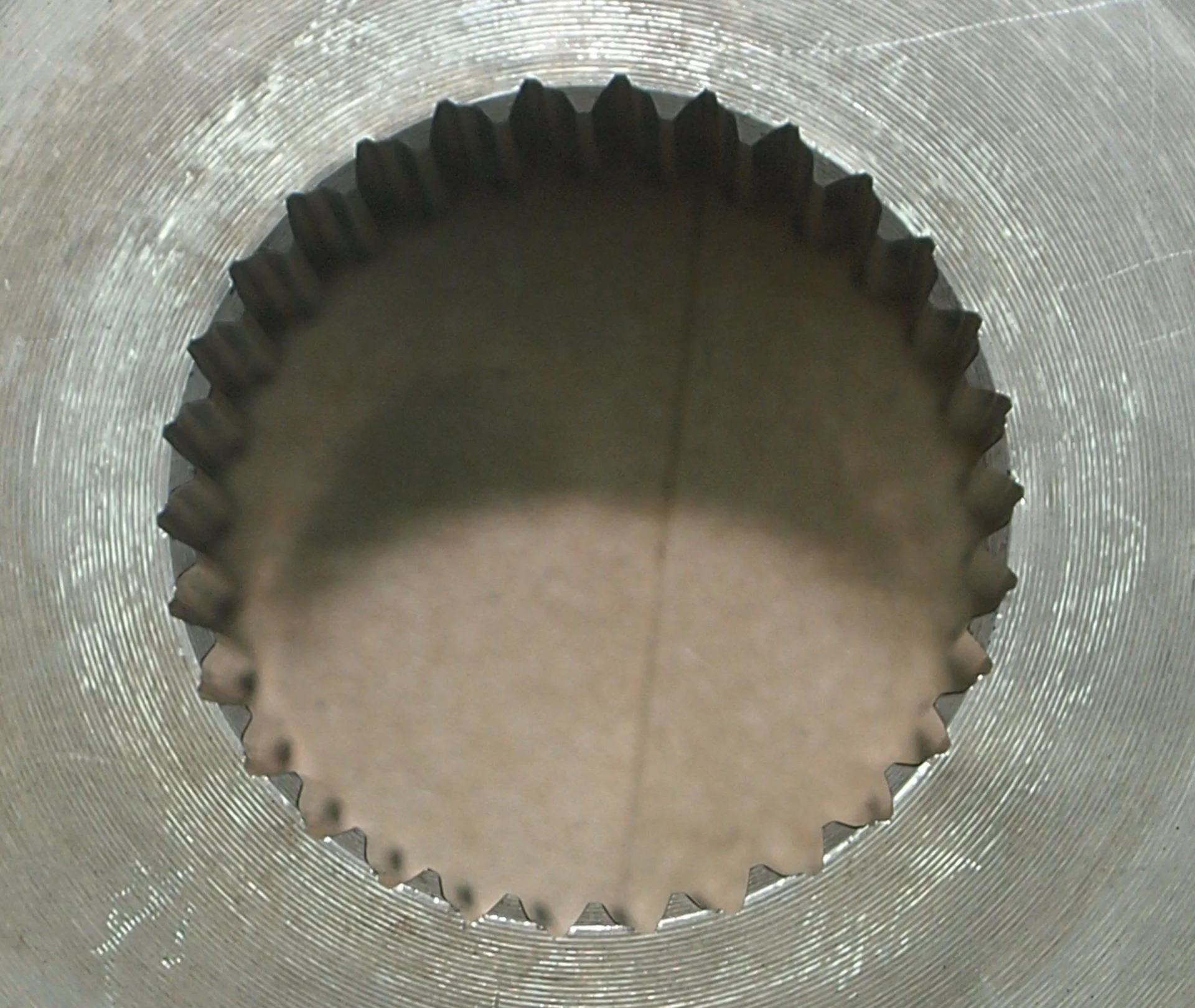

Hub flange teeth may be worn and cone washers may be scored. Replace these is a nice touch.
FSM states hub flange nuts not reusable. I do reuse most times, but add a drop of blue lock tight.
Grease cap if any damage around the lip. You want a water tight seal.

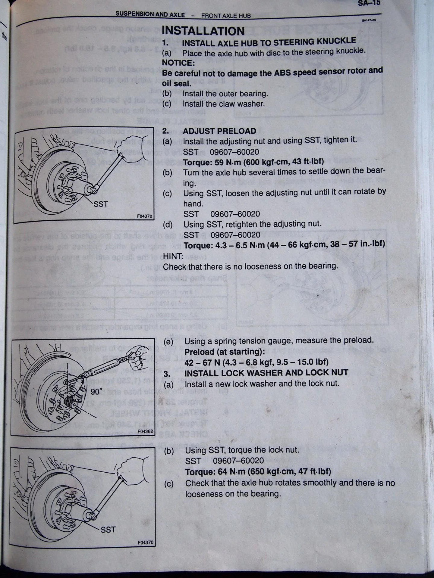

As for your bearing preload fish scales are for fish. Torque the bearing preload to 25 ft/lb rotate the wheel a couple times in both direction check the torque and never look back until next time.
The fastest way to grease the spindle bushing
How to lubricate front axle shaft bushings?
This may be first time we've disagreed.;)

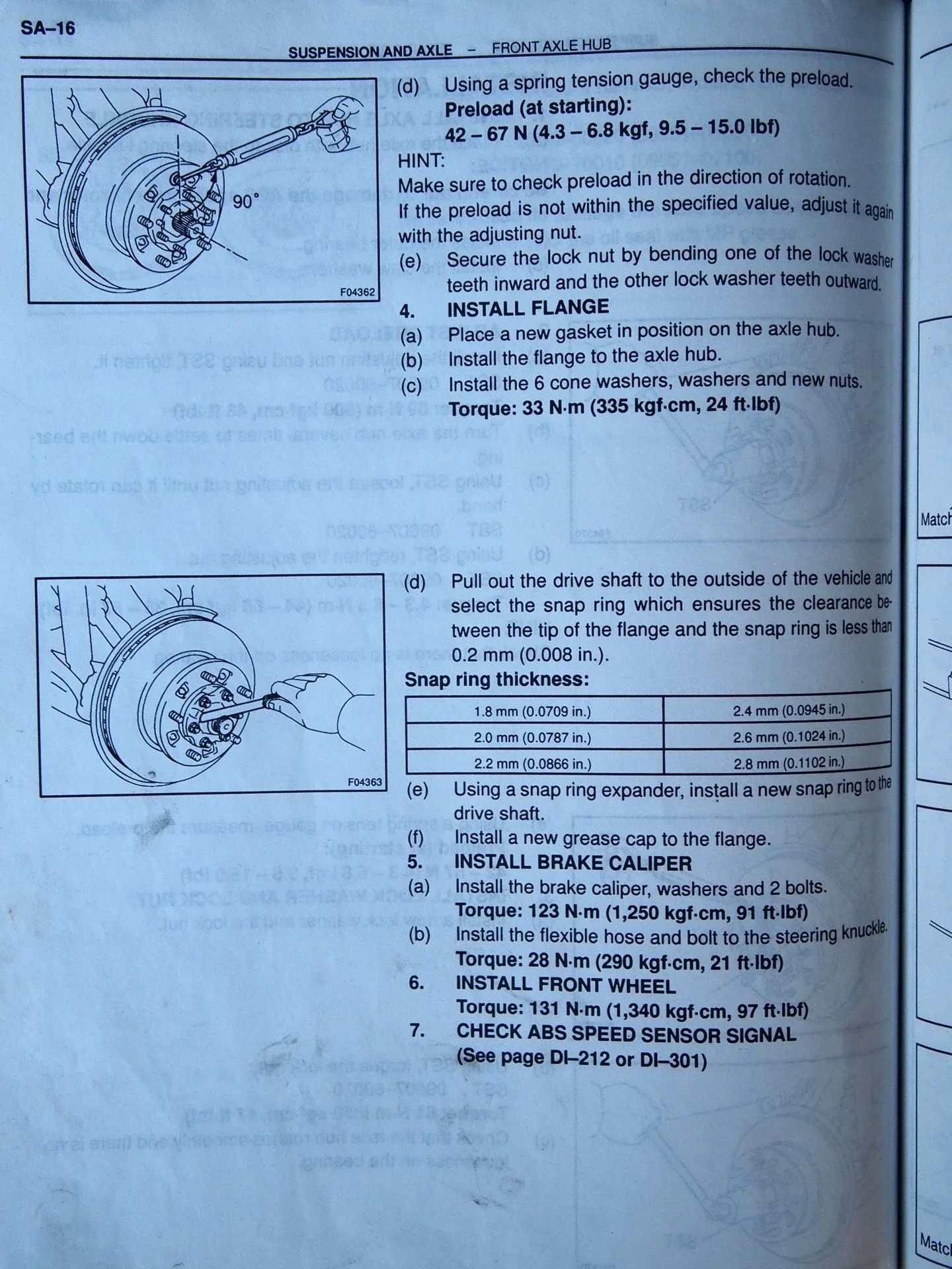

Where one can just torque to 25ft-lbf, it's my experience this will leave good or new bearings way to loose. Test will be at next 30K miles service. If claw washer scored at that time, bearings were set to loose.
I've tried just torquing to 10ft-lbf, 20ft-lbf, 30ft-lbf without a pull scale. Each of those claw washer was scored, with 10ft-lbf scored the most 30ft-lbf the least.
When I use the factory prescribed method, claw washer is in near perfect condition at 30K miles. The reason claw washer become scored is loose bearing chatter/vibrate. This create heat and can damage bearing, races and spindle. Additional this chatter combined with excessive hub flange snap ring gap creates a sawing action on axle and hub flange teeth warning them prematurely. The wide gap also pounds on snap ring, hub flange and axle end retain grove.
Most shop do not use a spring scale to set breakaway preload, nor do they check snap ring gap or replace them. It just to time consuming. It also ensure future high dollar repairs!
FSM has it right and is best practices

To adjust the wheel preload see 4 minute mark onwards on How to rebuild a toyota 4x4 solid front axle part 8 by lowrangeoffroad. I followed the same method (except I used 20 Foot pounds at 4:55 minute mark [they show 4ft-lb]) on my 2000 lC and Hilux 1990 and so far bearings are tight and spins as it should.
