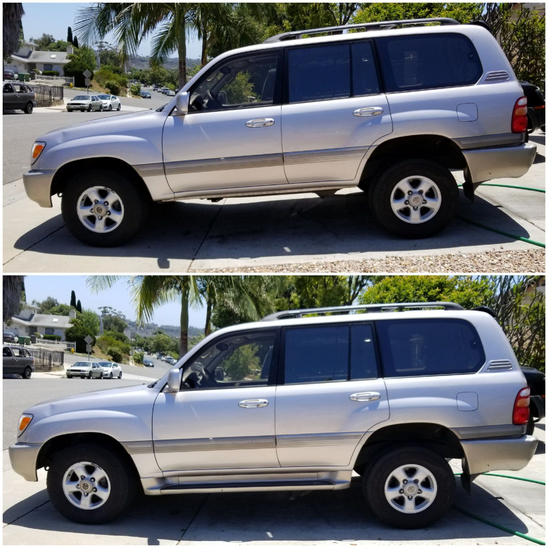

Running board removal makes a world of difference!
I think this thread is a great idea! I just purchased the same color 2000 and am going through rhe same things. I will definitely follow along your build and watch all the steps.
Running board removal makes a world of difference!View attachment 1733330

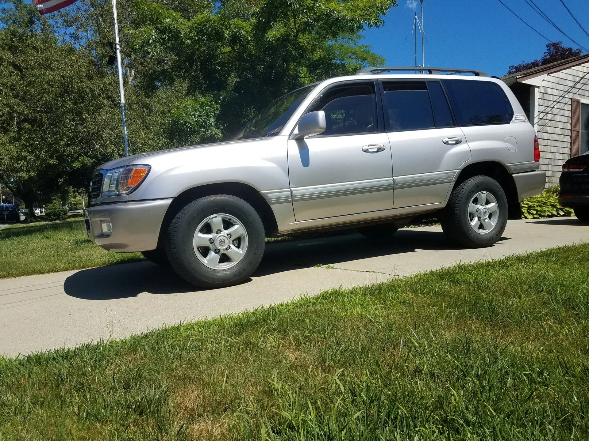

Well it's been a while since I've updated this. And unfortunately I haven't gotten as much accomplished as I'd have liked to by now. Been dealing with getting into my first year at college, work, relationship, life, etc., so I haven't had much free time on my hands. Things have started slowing down so I'm going to be catching up on everything I've wanted to do. I updated the OP as sort of a way to track where I'm at. I'm gonna shoot for most likely next weekend to check a lot of this stuff off my list, hoping the parts I've ordered make it in before then.

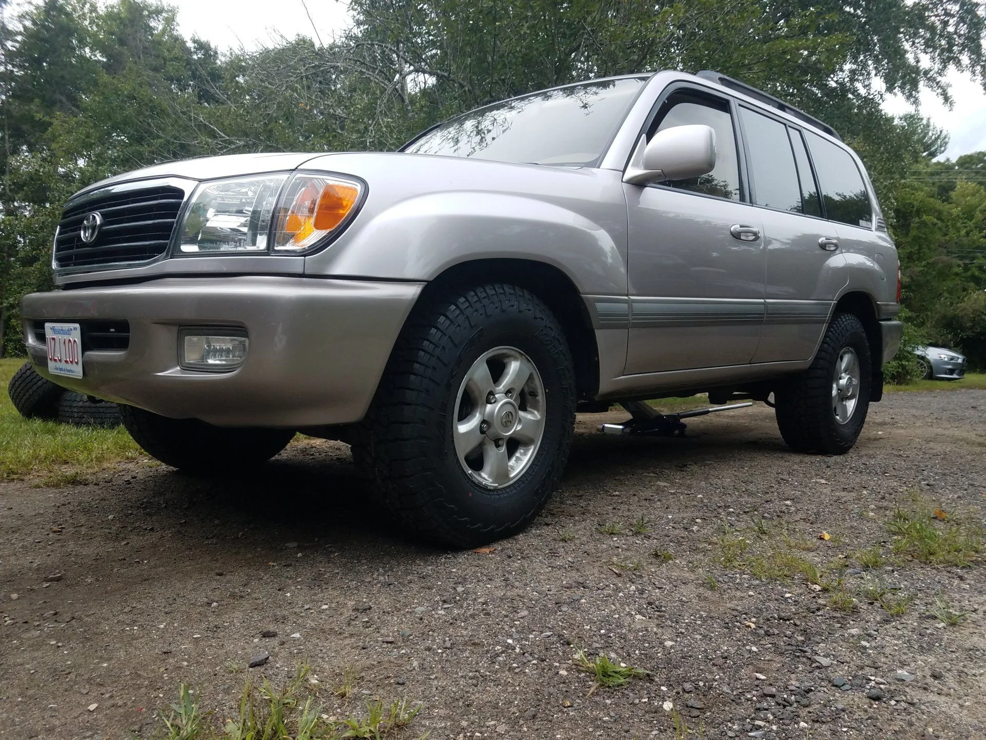

I managed to get a set of "33s" mounted on so far. I've been going back and forth with myself about mods and at this point I'm probably going to forgo a lot of what I wanted to do, and focus on driving the truck and getting it all squared away. If I happen to be able to replace something and go aftermarket I will. But unless I need it, it'll have to wait. Mainly due to other life expenses that piled on in the last couple months now.
With all that being said, here's how she's sitting as of now. While I do the deferred maintenance in the upcoming weeks I'm gonna get her cleaned up on the cheap. Painting worn out stuff, adding some 'contemporary' touches like new bulbs and what not. And get my hands on an UltraGauge and do some interior stuff.
That's about it really. Thanks to anyone bothering to follow along, and hope you're all doing well.
How do you like those Falkens?
So far they've been really great. This is the first A/T tire I've purchased and went with them on recommendation from a close friend who ran his for close to 60K miles with no problems (well, not until the very end of them being on his truck, but it wasn't the tire per se). They're much quieter than I expected. I don't have any variables aside from on-road driving and wet conditions, but those are pretty stellar. I commute and daily the truck and honestly it doesn't feel much different compared to the stock Michelin LTX's previously mounted. I went with the E Rated/10 Ply (specs in my sig) for when I eventually get off-road and for added security I guess. I'm no tire professional like many here, but I'm very impressed to say the least.
Edit: The price point is awesome too. I think it came to $690 from eBay, mutual friend mounted/balanced them for $30. I've yet to get a spare but I can't complain whatsoever about that aspect.
