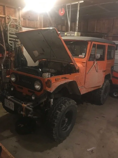

72 Fj40 with a 350 GM conversion. Toyota 4 speed tranny not sure the transfer case but pretty sure its the original. I think most of the FJ is a 75 actually with a 72 body. From my research the conversion is a Downey.

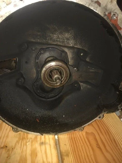

I found the Downey 350 conversion instructions and it looks like its almost all Toyota parts except the throw out bearing hub. I dont see any damage but should I replace the throw out bearing? I think the throw out bearing is Toyota.

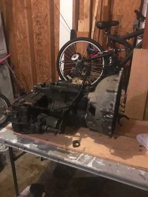

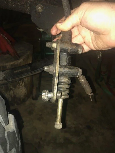

Pics as suggested will help everyone get an idea of what you’re dealing with. Starting with the tranny/transfer, clutch slave mount (and angle) on the bellhousing. You never know what kind of stuff previous owners bolted on in its previous life.
Posted pics, thanks!
First I’d like to know who picked up the tranny/transfer and bellhousing and set it on the table. Ha ha.

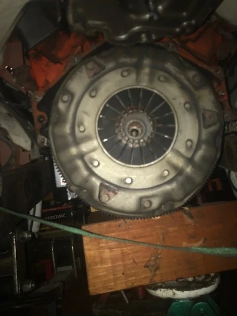

Jim @Downey (and many others) should be able to ID all the parts you’ve got in your setup. Lots of different ways to do the V8 conversion so some parts are intermixed. The clutch pressure plate looks like a centerforce clutch but it’s been awhile since I’ve messed with one. Toyota slave for sure. Mount is possibly an old Downey but it really doesn’t matter. You can make one pretty easily once you determine if it needs a better angle.

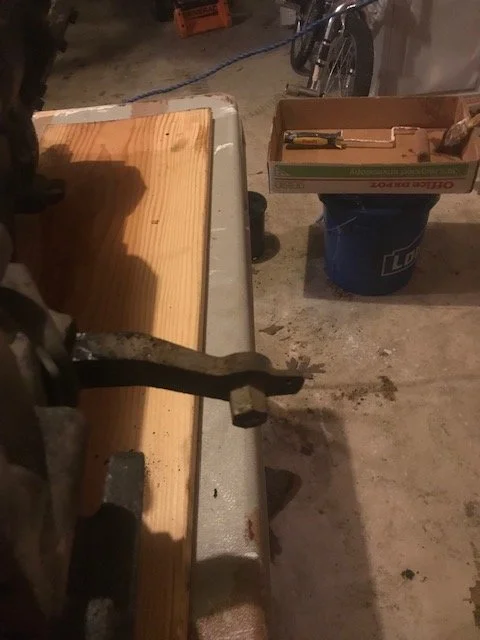

In the last pic with the clutch fork it looks like the slave pushrod end is jammed into the seat. That’s supposed to stay with the pushrod and rest loosely into the groove with the spring. They do wear with a lot of use but not sure I’ve seen one stay in the seat firmly. No big deal as the new slave should come with a pushrod and end.

Now that it’s out you should remove the pressure plate and take a look at it and the disc. Price out the following and see where it lands in your not to be discussed budget and go from there:
Toyota or Aisin master cylinder
Toyota or Aisin slave cylinder
Clutch pressure plate and disc
Throw out bearing
Pilot bearing
(Confirmation of which ones you have from members or get whichever kind you prefer) Some vendors are much more familiar with the V8 conversions than others. Advance Adapters should be a good start but as suggested @Downey would be a good resource and a real cruiserhead with more knowledge than I’ll have in 3 lifetimes. Use the search function for member name and you will find him. Start a “conversation” from there.

1. You have the newer style Downey bellhousing, it was made for the 4 speed tranny, but since all 4 speeds had the shift fork on the passengers side, we machined ONLY the passengers side for a slave cylinder mounting bracket. Who ever did your conversion simply did not re-route the slave hose over to the passengers side. That means what ever your slave cylinder mounting was, it was home made, and wrong. I'm going to attempt to attach a photo here to show how to build a simple slave cylinder mounting bracket that lets you mount the slave cylinder on an angle so that it points directly at the shift fork.
2. If you do need a new clutch, I recommend my Downey "Chevota" Clutch, and here's why: A Chevy clutch takes .500" travel (at the T.O. bearing) to disengage, and your Toyota clutch master cylinder and slave cylinder produce only .450" of travel. Even the LUK clutches many on Mud use takes .420: of travel to disengage, so it's operation out at it's ragged edge. My Chevota clutch takes only .375" of travel to disengage- - -so there you have it.

You might consider running a whole new hard line from clutch master cylinder to clutch slave cylinder mounted on passengers side, you'd just have to be able to double flare the fittings (we use to make the hose for this when Downey was in business).
Yep, replacement of gaskets/seals straight forward, and design of new slave cylinder mounting bracket super simple.
When I installed the V8 in my '74 using Jim's @Downey kit for a 4 speed transmission I purchased a 3 or 4 foot straight brake line at O'Reilly Auto Parts and ran it across the firewall and down on the passenger side of the engine. I used a tubing bender to follow the contour of the firewall. Just select one by the correct fittings on the ends...
tlc762 is spot on, they do make 3 to 4 for brake lines with metric fittings already installed- - -easy deal.
