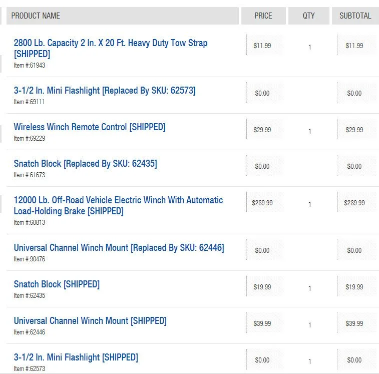

Speaking of Harbor Freight, they sent me a promo email yesterday and I decided to splurge a little. The wife has gotten attached to the rig and gave permission to "do what needs to be done" to get Landy in tip top shape. Almost all their recovery gear was on sale and I decided to use this excuse to get a winch setup. A winch is needed to get any FJ80 in tip top shape, right?...
I plan on moving the LED bar to the top side of the brush guard and putting a hole in the stock bumper for the winch. I would have never thought of it if it werent for you all on here. More on this to come!
