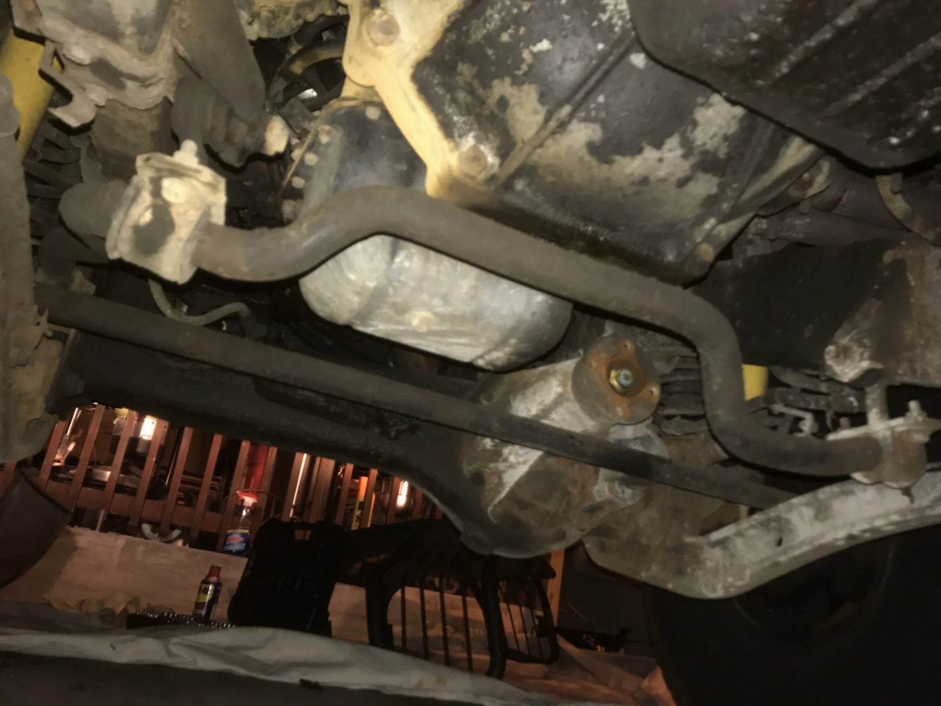

The bigger issue, and main reason I am posting, is that I found that the front drive shaft has been REMOVED! The LC has factory lockers and they seem to work while driving, but this is obviously all show and no go (in the front).
My question is, what is the best way to fix this, and why would this have been done in the first place?
Thanks for the help everyone!
Best way is to find a front drive shaft and go from there. Jack up front end and engage lockers. See if they work and both wheels turn the the same direction and see if there is any noise. With no drive shaft turn wheels by hand.

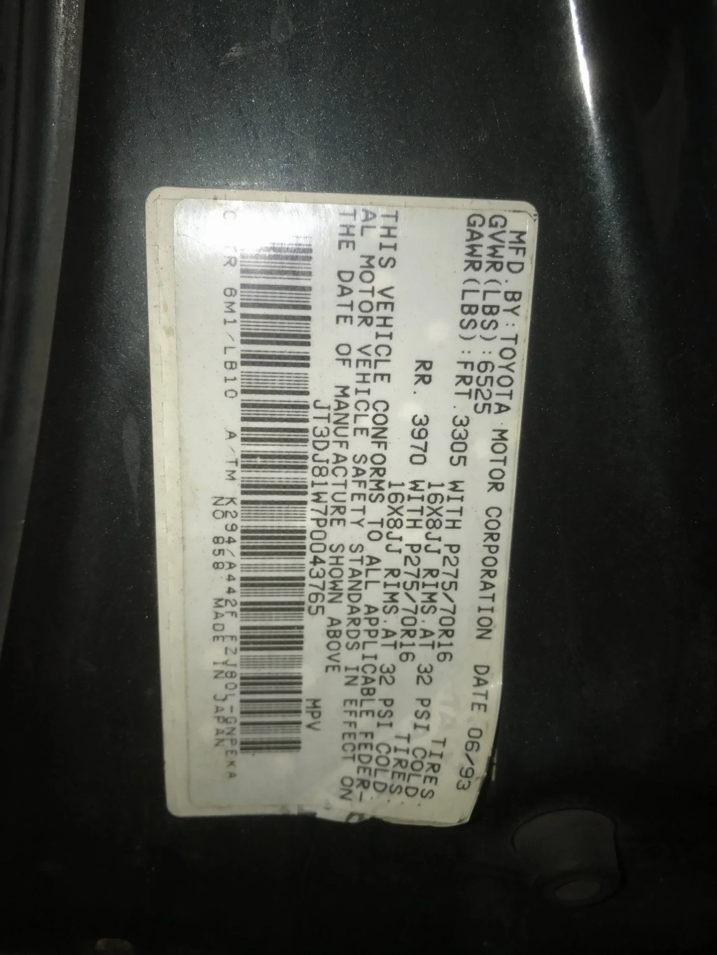

Now post some pics! Especially of the VIN sticker so we can tell you if it actually has factory lockers or if the PO lied about that too...

Today, when I was doing an oil change, I noticed that there was no front drive shaft. Now, I am pretty livid, I called the dude and sent him an email. I am not so much worried about the money, but the fact that I was lied to in multiple ways. Also, I am concerned that someone removed the front drive shaft because of some other problem with the drive train.

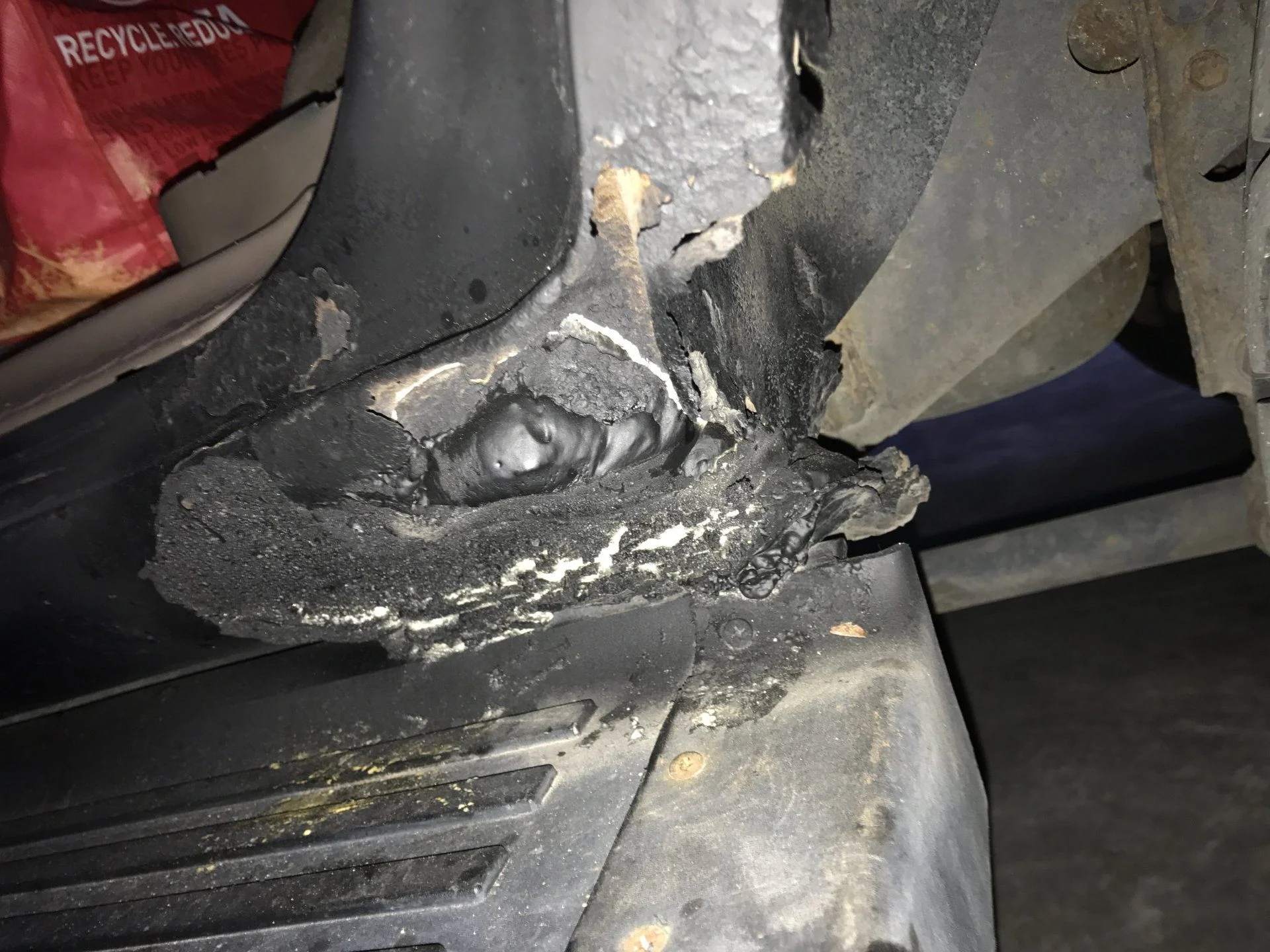

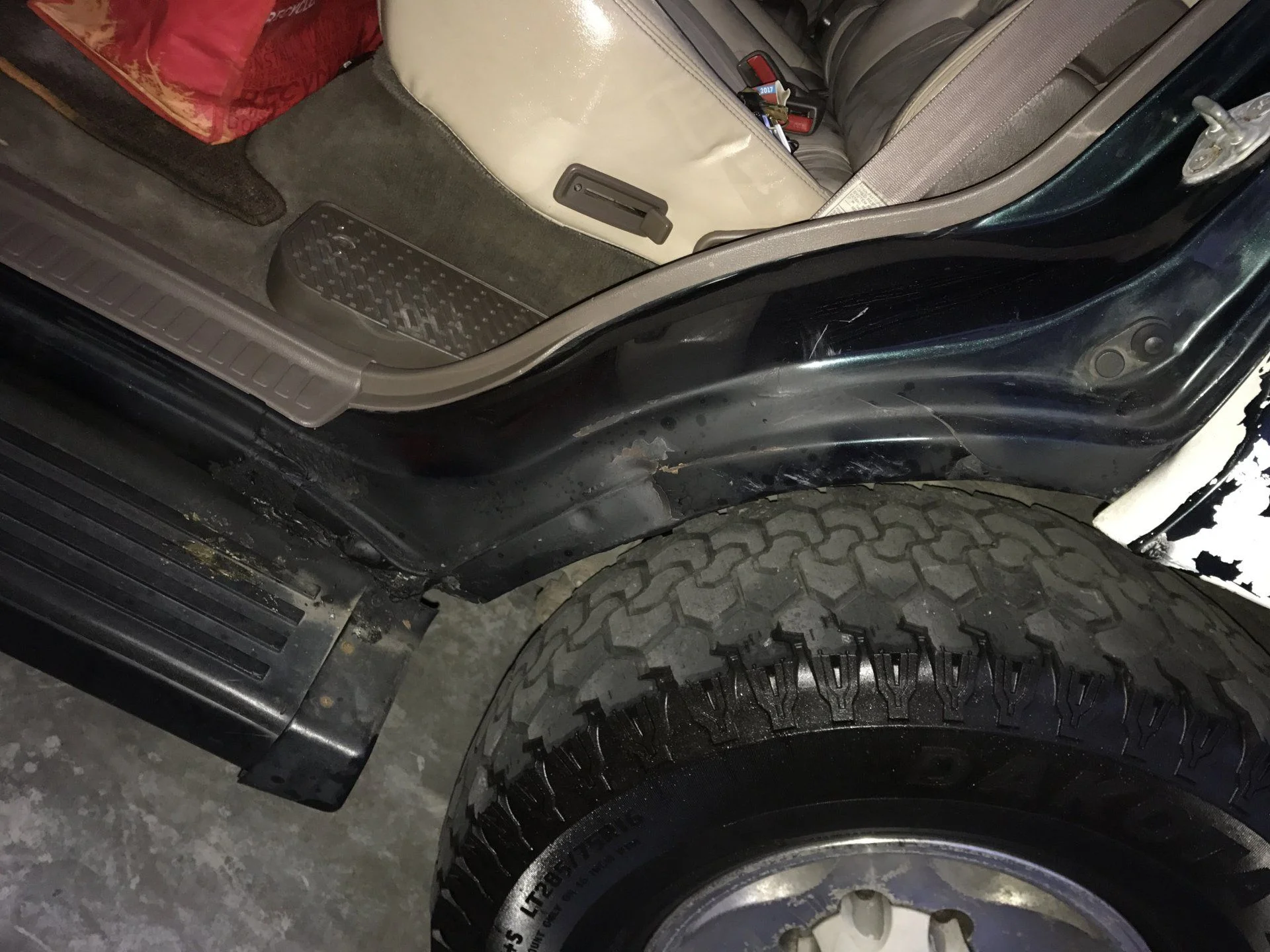

I think your main concern will be to send it to a body shop and have them look it over or put it on a chassis machine.Since it has the original peeling paint will lead me to the concern of undercarriage damage or possibly frame.
Did they weld the rocker to the side steps? Or is it caulking and expanding foam insulation?
ding ding! foam with some Flat black paint. it is actually to cover up the rust hole that was there I assume. I am ordering a replacement part of that quarter to get it fixed (should also fix the fat dent in the same quarter panel near the front side of the wheel). This is probably where the accident was and they most likely replaced the rear driverside door but not the body panel.
