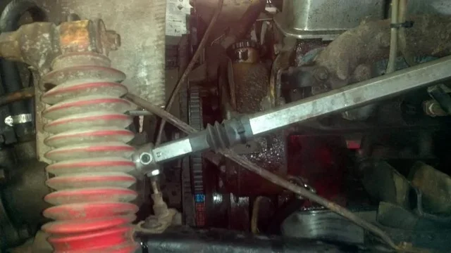

Alright found the power steering pump and bracket at a junk yard out of an 84 montecarlo ss and she worked like a beauty $34 I needed a 36.5" belt to connect the harmonic balancer to the PS best part of just yard all hardware included. Ill post some picks later tonight

junk yards are getting scarce with old vehicles due to the scrap metal price. Most in my area dont have much below 1990 I had to travel to find the monte carlo
here are some pics of the job :beer: time happy st pattys day all
