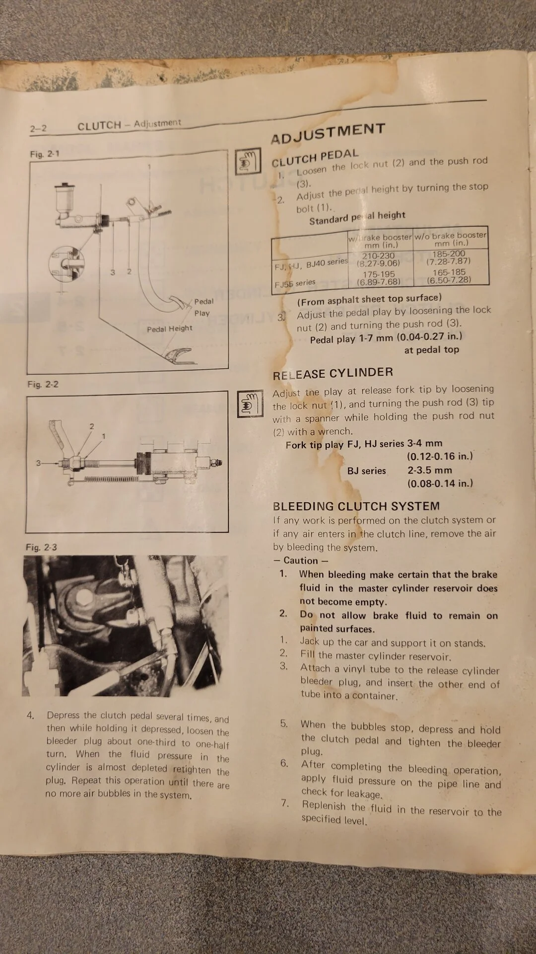

1st i hope you were in low range. Make sure the throw out bearing is not in contact with the pressure plate springs when the clutch is released. I'd go thru Toyota's adjustment procedure, adjust pedal height, then pedal freeplay, then adjust the slave rod for freeplay. The return spring seats the piston in the back of the slave. Adjusting pedal freeplay is not when you feel resistance, its when the slave rod starts to move. My slave is on the drivers side, so I was able to check pedal free play by watching the slave initially move while pushing on the pedal with my hand. These adjustments insure full stroke from the master and the throw out bearing is not touching the pp. You should get more than 20k on a clutch disc.
Yes, in low range. I've been through the adjustment procedure a couple of times just to validate. The throw out bearing has no contact with the diaphragm and has a couple mm space.
