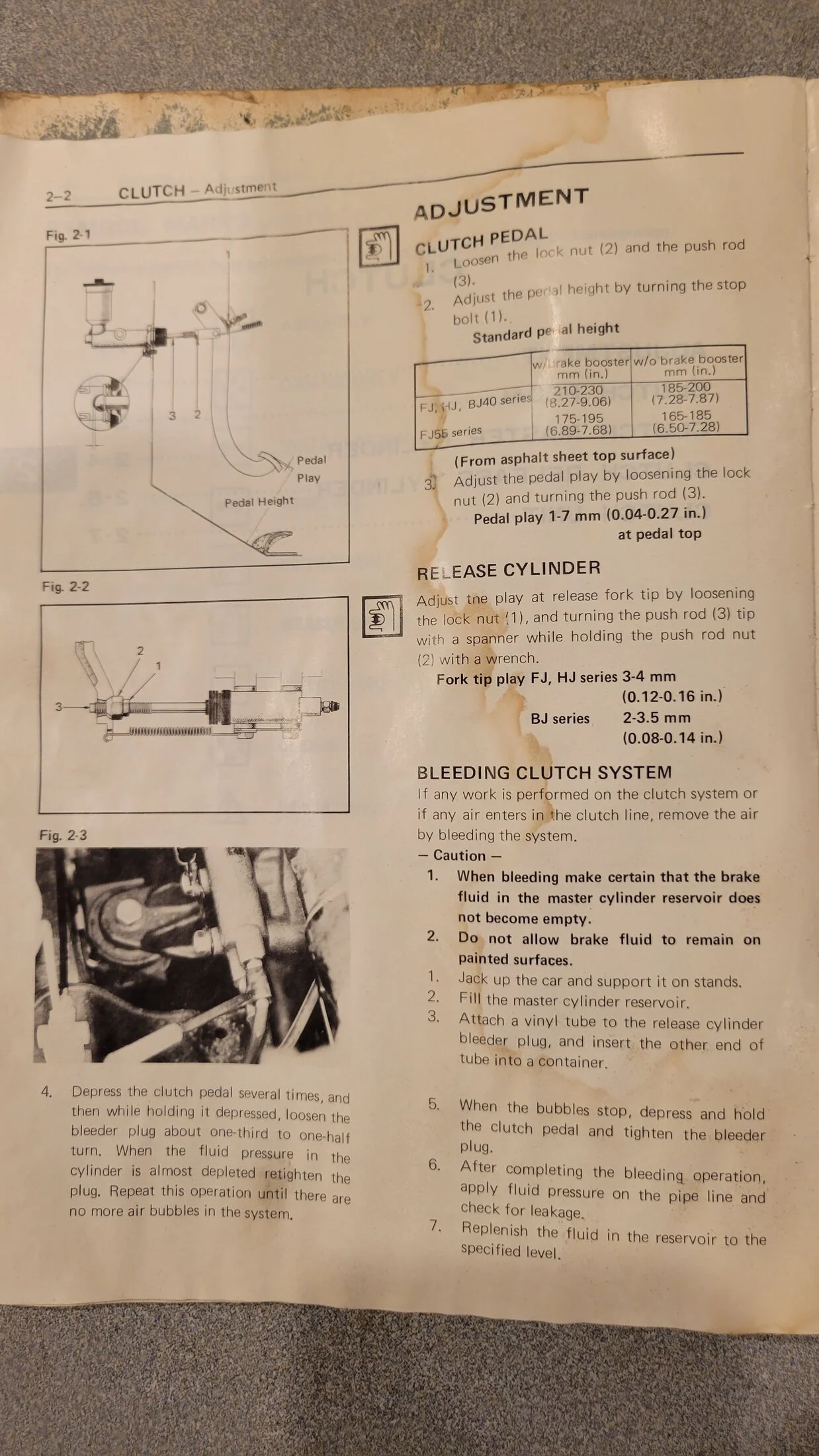

Have you adjusted the clutch pedal also up top to the master double check your getting full stroke of the master also sometimes the pedal hits the floor before achieving full master travel. Especially if ya have floor mats. Also have you physically looked at the fork to throwout bearing and adjust the slave so the TO bearing is just about to touch the fingers take up all the slack or slop everywhere. It should work fine
I just use the 1978 master and slave combo but remove all the slop out of the slave and make sure the pedal is achieving full stroke master. Adjust the master pushrod and the slave pushrod to almost zero gap. And no resting your foot on the clutch pedal while your driving or you will kill your TO bearing if it is touching the fingers and spinning all day.

Thanks for the advice!
I have done everything except adjust the pedal rod, will definitely do this today. I’ll double check the Bearing clearance with a scope as well.
Thanks
I've been running the later model 40 slave and master for decades. When i 1st got my 75 I did have to fine tune the pedal and freeplay the adjust the rod. I adjusted the pedal freeplay by watching for the intial movement of the slaves piston while pressing the pedal a little by hand.
