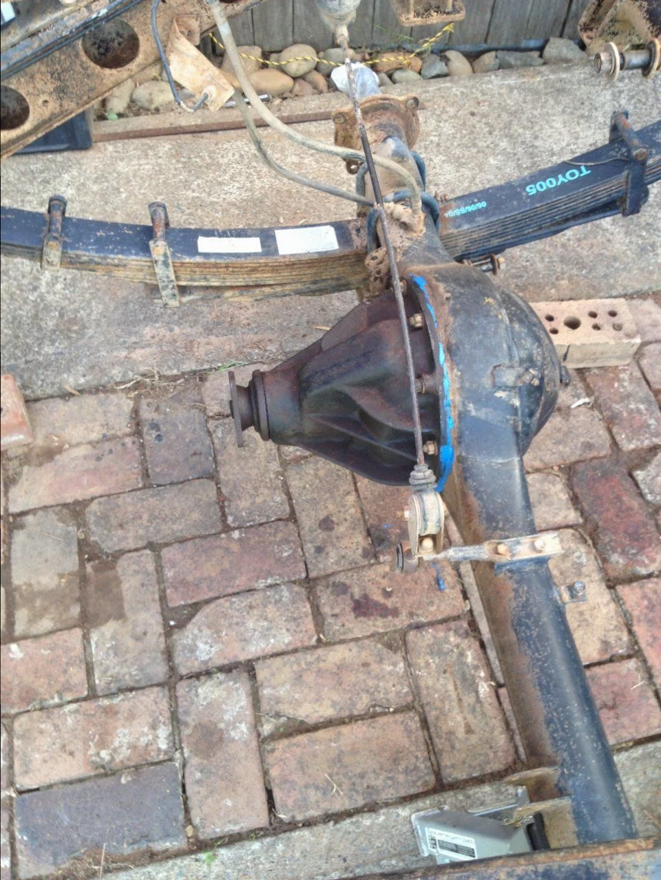

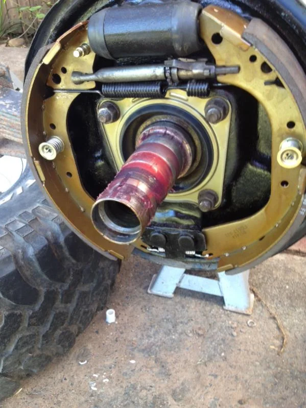

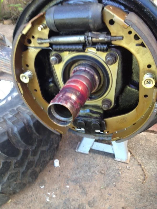

I had to pull the rear passenger drum brake apart again to put in the new dust seal which I couldn't find the first time
Looks good in there Chappo.

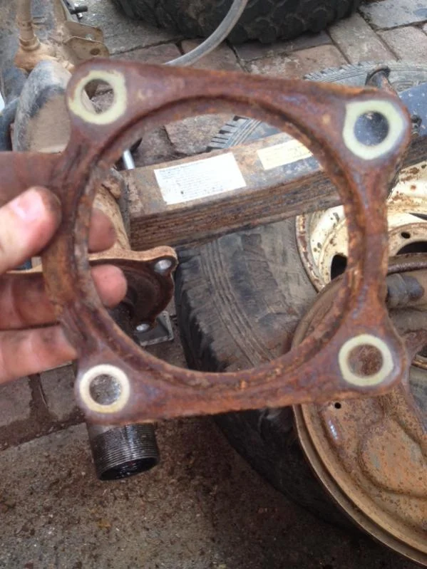

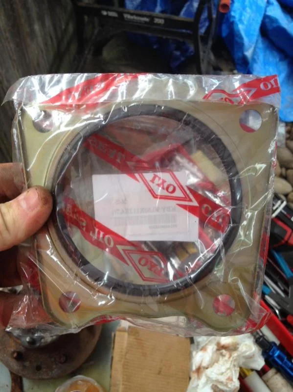

But where's this little oil seal?
Without that you'll get diff oil in your wheel-bearing grease making it all goey and prone to flinging out (through the big seal on the rear of the hub and then through that new dust seal ) to then get inside your brake drums.
:beer:
The seal was installed after picture lucky I ended up with 4 of them aswell

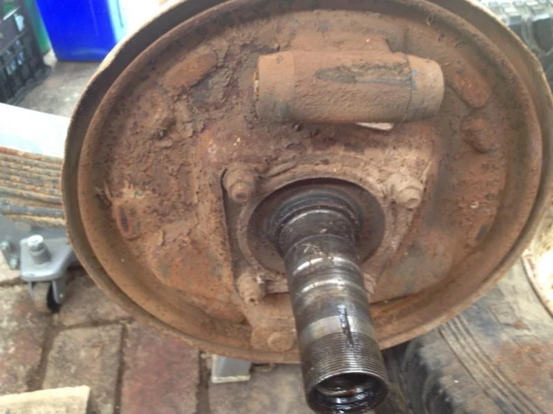

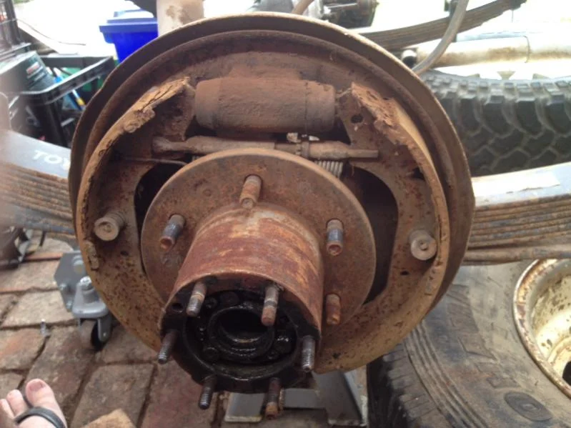

Pulled the drivers side rear drum brake off this morning. I have never seen one so rusty on the inside it was buggered

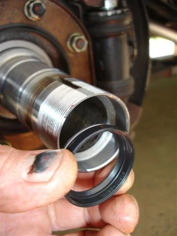

The old seal
What it should look like

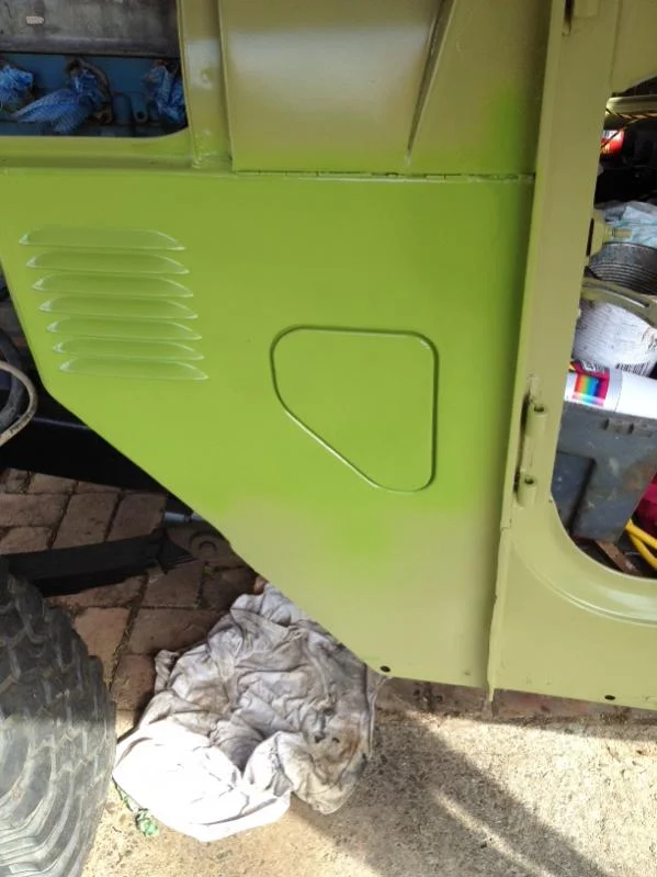

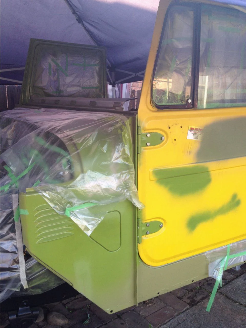

Got the new paint and tried it out I like it not as much as the original colour 6l4 light olive
Its quite a lot greener isn't it? The OG olive was a great color
Yeah the olive was a great colour
Pissed of about it but as my budget is getting very tight I just got a standard colour paint so it was cheap I will paint a swb 40 in olive one day

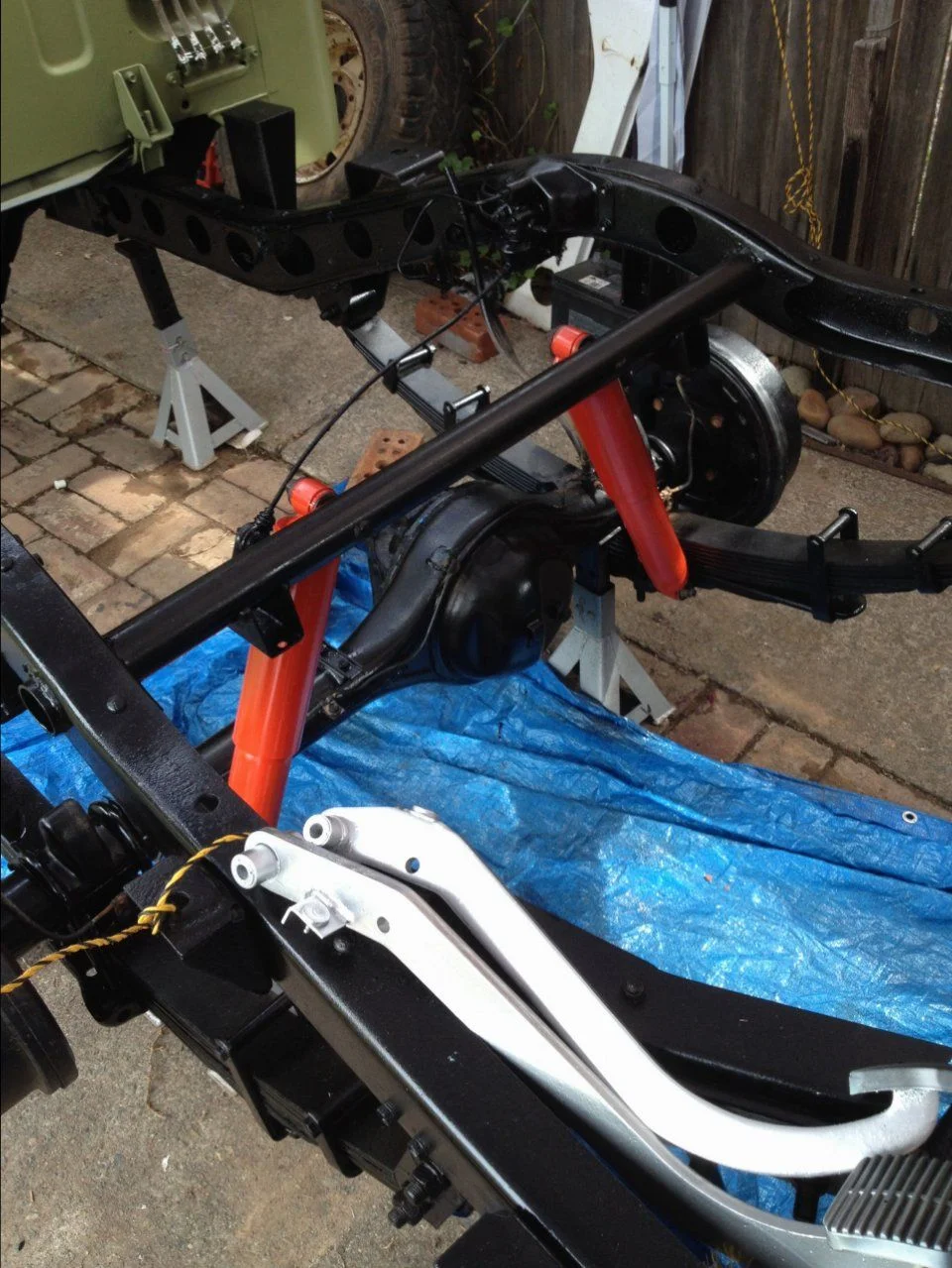

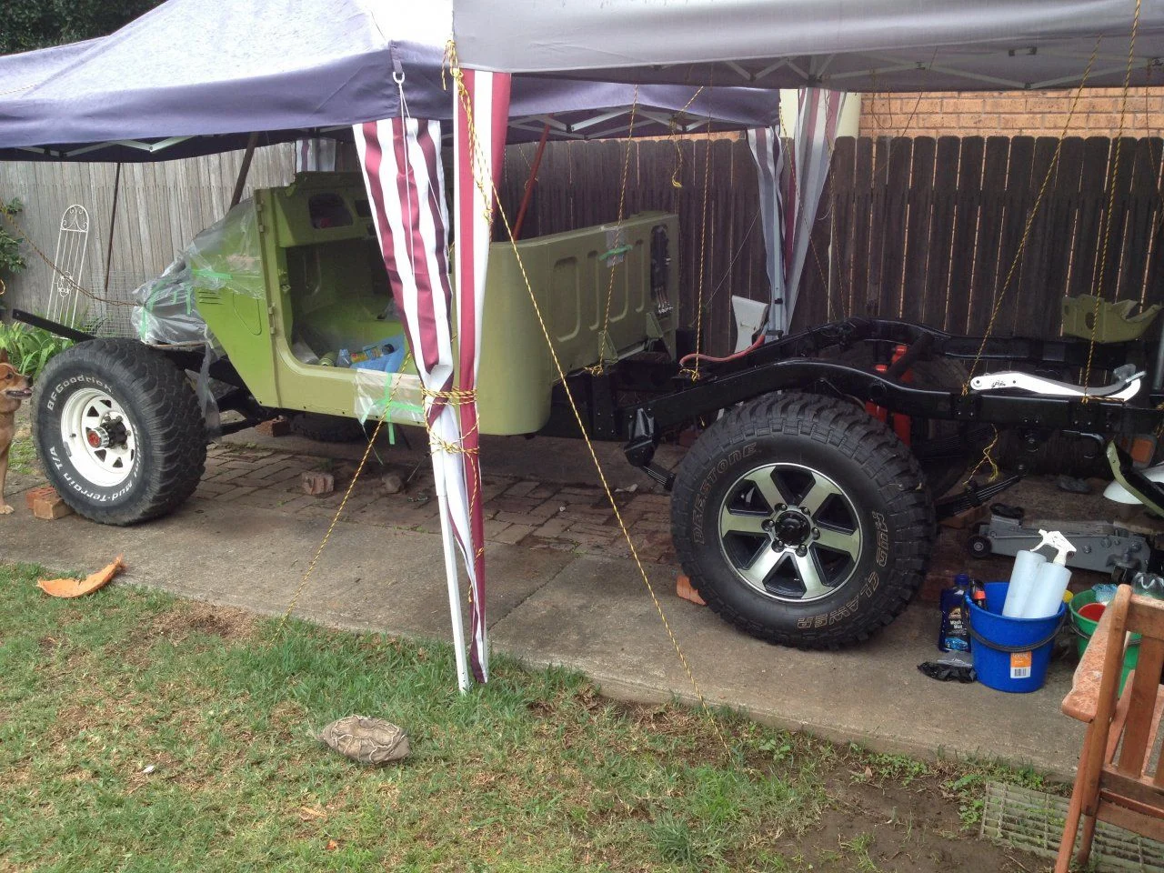

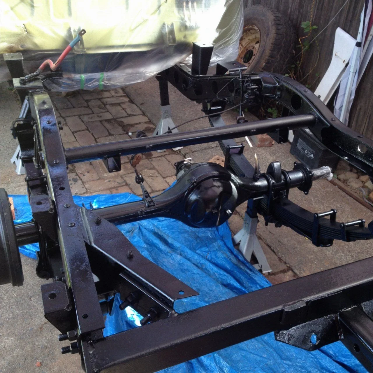

The last few day I have installed a new rear diff finished rebuilding my drum brakes and have started to paint the cab the new green

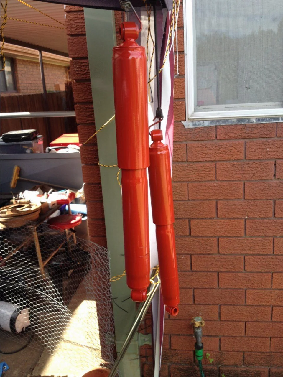

I also painted the rear shocks
Today I finished the instal of the rear axles and drum brakes
I also put on the rear shocks and brake lines

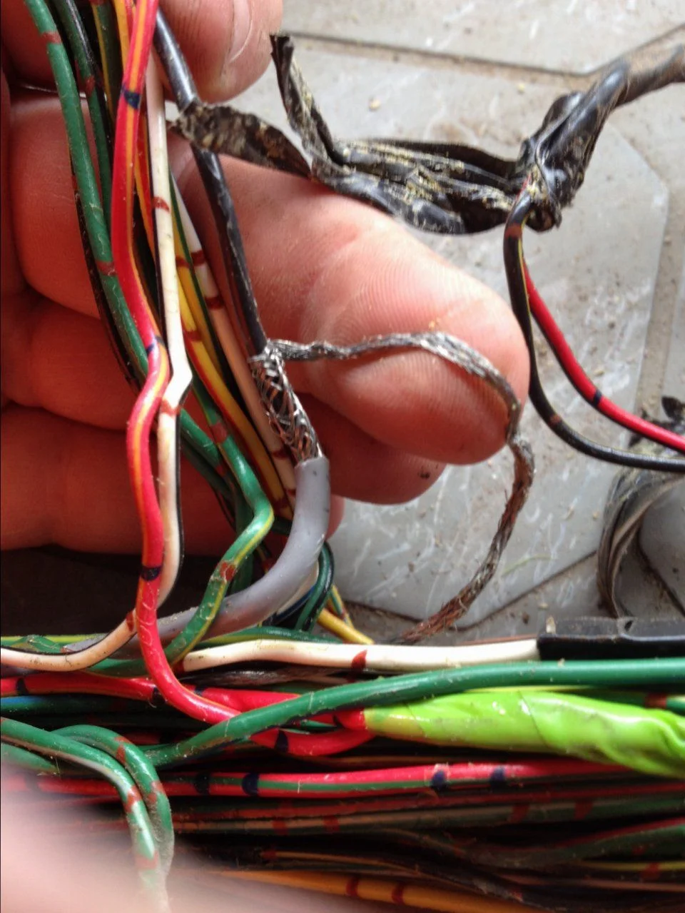

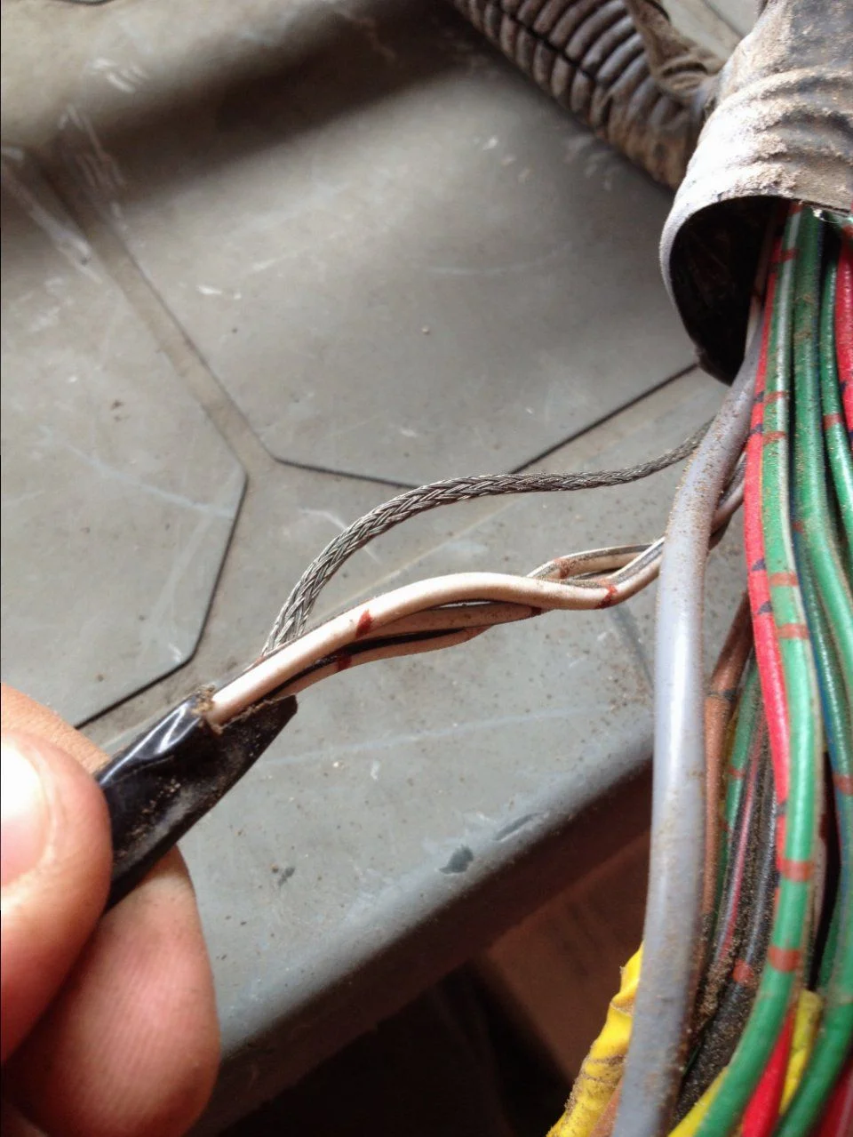

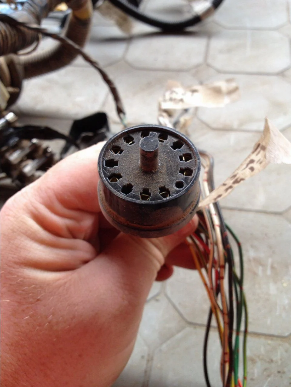

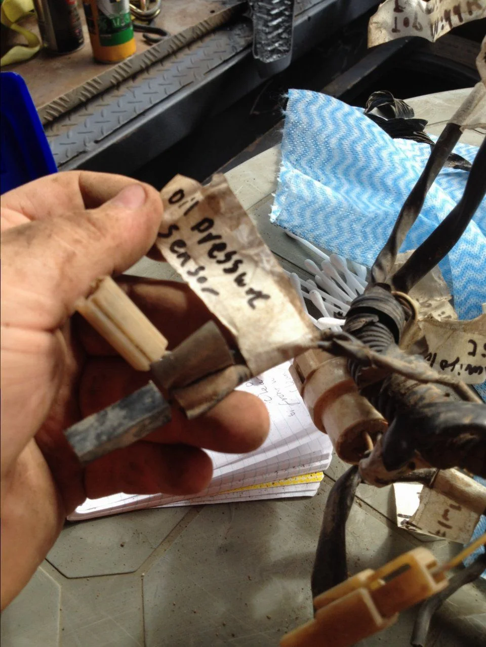

Today I also started unraveling more tape off my wiring harness but have found a wire from the dash plug that I traced to the oil pressure switch as my harness is labeled was just seeing if I should fix this or is it supposed to be like that. All bare wire about 10cm of it
I remember that wire braid when I rewound my loom back in 2007/2008, but cannot remember, its a shield and it went on to connect to something, I am sure it went to a plug?
PS. You are right, its oil pressure cut off or a oil sensor, just thought it strange at the time it connected to a plug.
Yeah mate that wire looks factory in mine

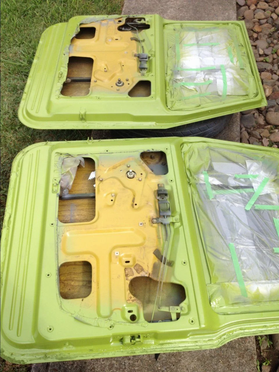

Today it wasn't raining so I painted the inside of my doors so I can put them back on and paint the whole exterior of the ute at the same time next sunny day.
I have got about 3 feet if the engine bay wiring harness left to go through and then I might be able to get it running again to
I also installed the doors
