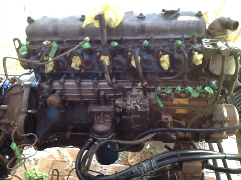

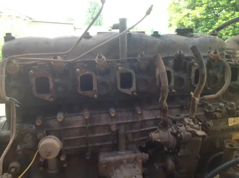

Started to clean the motor this week cleaned it a little in the exhaust side on Monday it was just black from dirt and oil and the intake side wasn't much better but after about three hours it was allot cleaner
Intake side before
Intake after
Exhaust side after a little bit of cleaning
Exhaust side after a lot of cleaning
Looking good chappo
I wouldn't even paint it as it's coming up pretty good with a degrease and scrub. The aluminum will come up like new with a decent cleaner.
My H engine come up like that after a good scrub.
Keep the photo's coming mate where looking forward to the rebuild
Just looked at your h engine what cleaner did you use on it or recommend
I used a product from chemtech its a aluminium cleaner called blitz. Dont leave it on for to long so it might need a few applications. I used a stiff brush and a tooth brush for the hard to get places.
Thanks mate I will get some from supercheap on the weekend and give it a go cheers mate
No worries cob. Harley sell a good product called S100 thats a engine brightener that will keep the aluminuim from corroding again but it must be used every time you wash/degress the engine.
