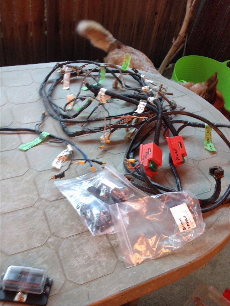

This afternoon I finished my wiring harness all looks good just one or two wire I don't know what they do but I will find out when I hook it up to the battery.

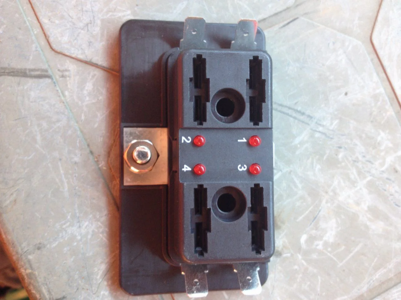

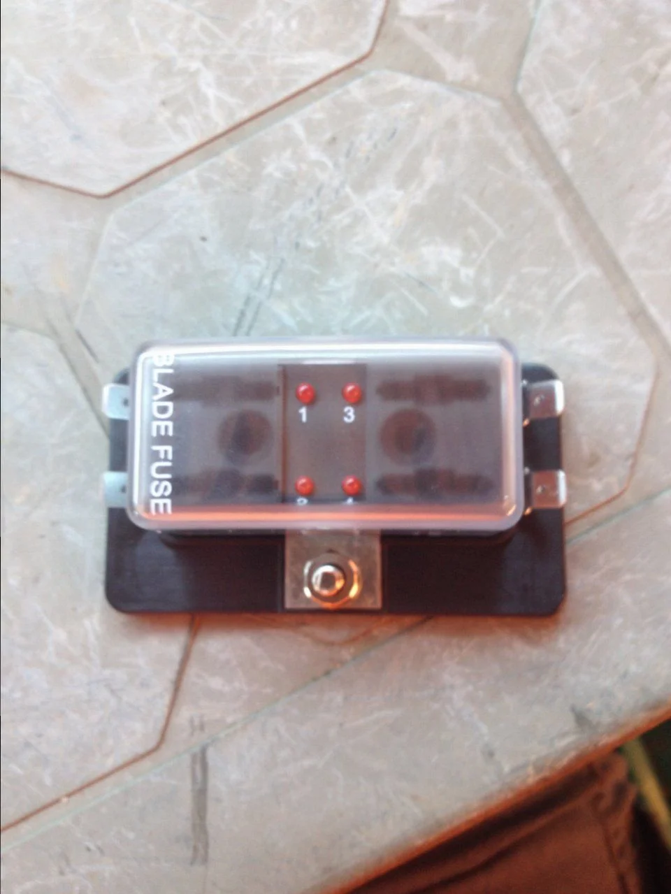

I also got my new fuse blocks and fitted my rear window panel

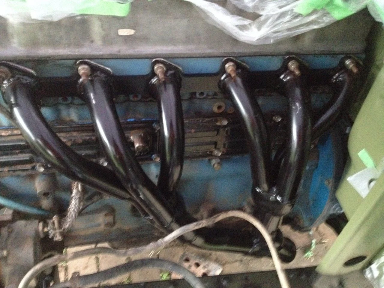

I finally decided to install my new exhaust manifold what a pos I had two remove the two studs closest to the fire wall to fit it and then add washers because it is not as thick as the old one

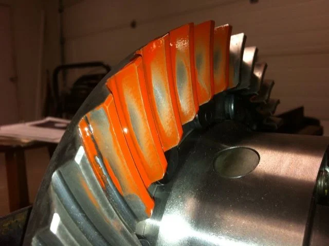

But as I understand it, the experts would say "I lucked out" by not having any problems and that removing shims upsets the relationship (backlash etc) and that I should have removed the entire diff and properly set it up again playing with pretty coloured stuff like this:
Photo courtesy of Alaskafj.
