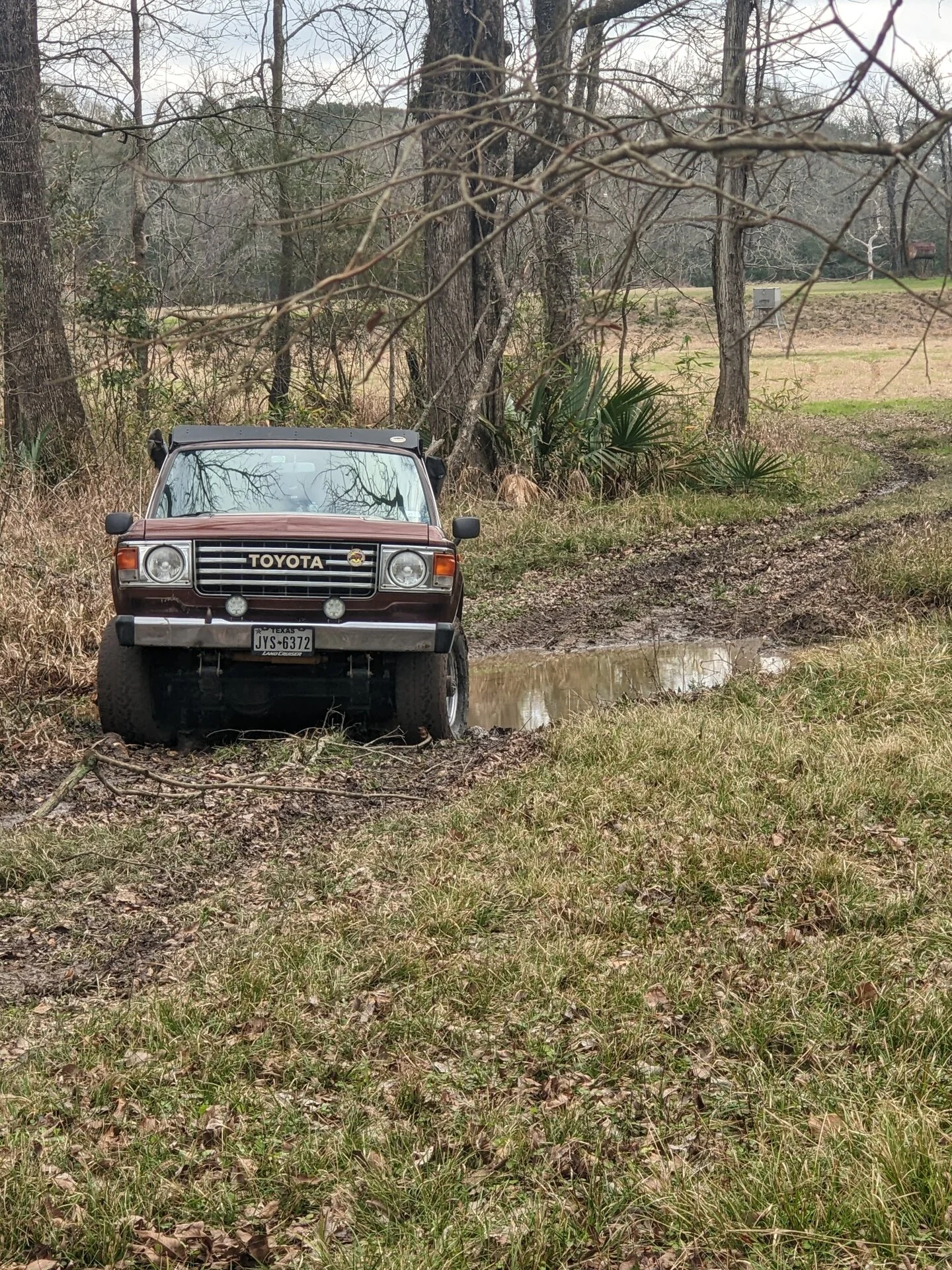

Pic for your entertainment. I have been through this hole many times and typically have no problem goosing my way through. This morning I neglected to get out of the truck and lock my hubs so I got stuck in 2WD thinking I was in 4WD. In the 5 years I have had this truck it was the second time for me to get stuck and both times it was in this hole. First time used the John Deere to pull me out but this time I called my son who purchased his first Toyota from a Mud member this year (97 4Runner, stick, with a winch). He was happy to come pull Dad out and give me a hard time.

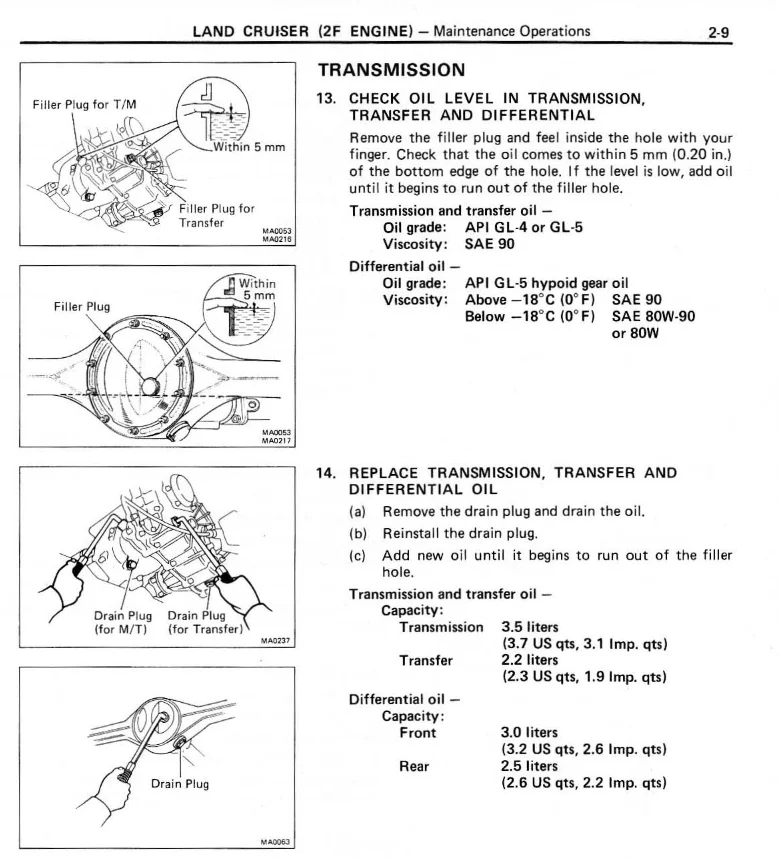

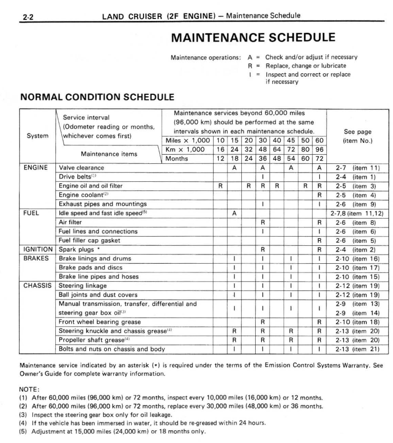

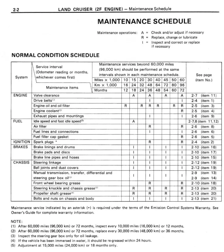

There seems to be a couple of different FSMs floating around. This Body/Chassis manual has lots of great info, obviously, but doesn't seem to have the maintenance schedules etc. Here's a screencap from the "Maintenance" section of the other manual that I have.

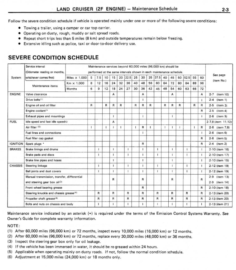

There is a 1986 maintenance manual in the resources tab (top of the page). As was probably the case in the 1980's there is no recommended replacement interval of these drivetrain lubricants for "normal conditions". However, the "severe condition" application recommends replacement every 15,000 miles. The examples of severe conditions don't seem so severe. Nothing about being stuck in a mud puddle!
There is a 1986 maintenance manual in the resources tab (top of the page. As was probably the case in the 1980's there is no recommended replacement interval of these drivetrain lubricants for "normal conditions". However, the "severe condition" application recommends replacement every 15,000 miles. The examples of severe conditions don't seem so severe. Nothing about being stuck in a mud puddle!

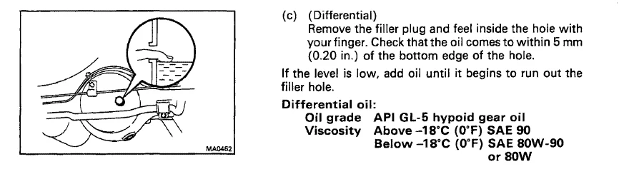

The Toyota manual states that the transmission can take a GL-4 or GL-5 gear oil …. but the differentials must use a GL-5 oil. Do not use a GL-4 oil in the differentials.

thanks for the clarification...reading back I see the FSM reads transmission/transfer is GL-5 or 4, but differential needs to be GL-5 so looks like this would do for my one for everything:
