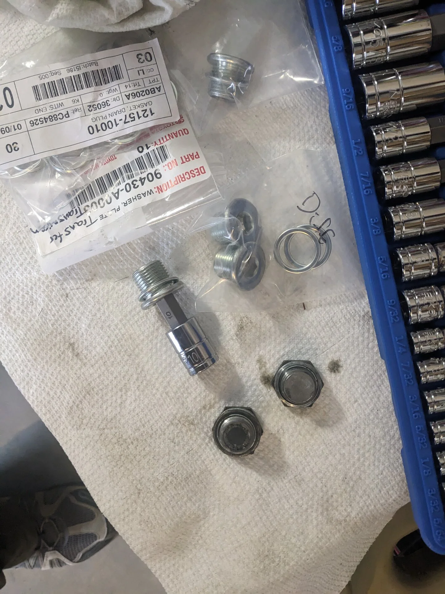

I would advise just a good snug torque on those, don't over do it. And make sure you have a good fitting socket on those skinny fill plug heads.

I bought a 6 point 24mm and ground down the first 1/8” or so on the front end to remove the taper. It fit a lot better on the thin bolt head. I read this somewhere on this site. Not sure who posted it but it was definitely worth the few minutes it took to do it. Completely eliminated the slippage for me. There’s some very good information and people on this site who are willing to help .

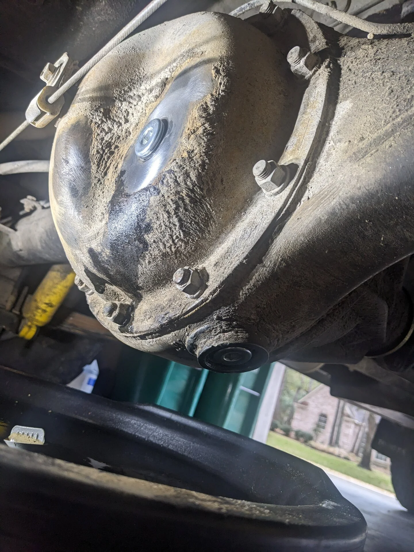

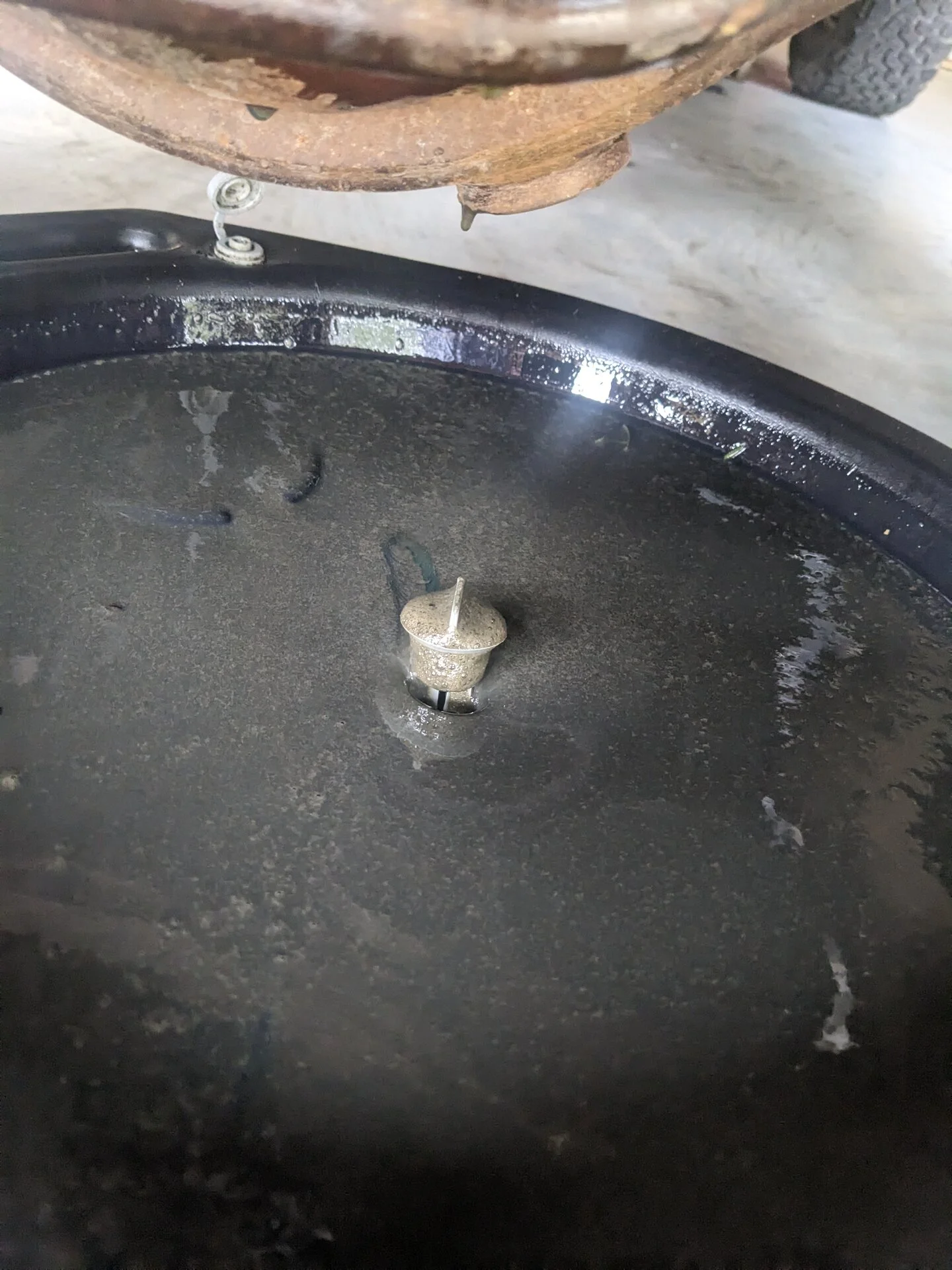

Done....did use the impact to gently break them loose. The rear looked like grey fluid until the last of it came out and then it looked like a tan latte. The front was a frothy gray fluid with the consistency of whipped ice cream. I would say this was way overdue. The transmission and transfer were done when I got the H55 put in and had also swapped it again after a break in period so I probably could of skipped it but figured I might as well knock out all three jobs since I was down there. Easy peeze.
