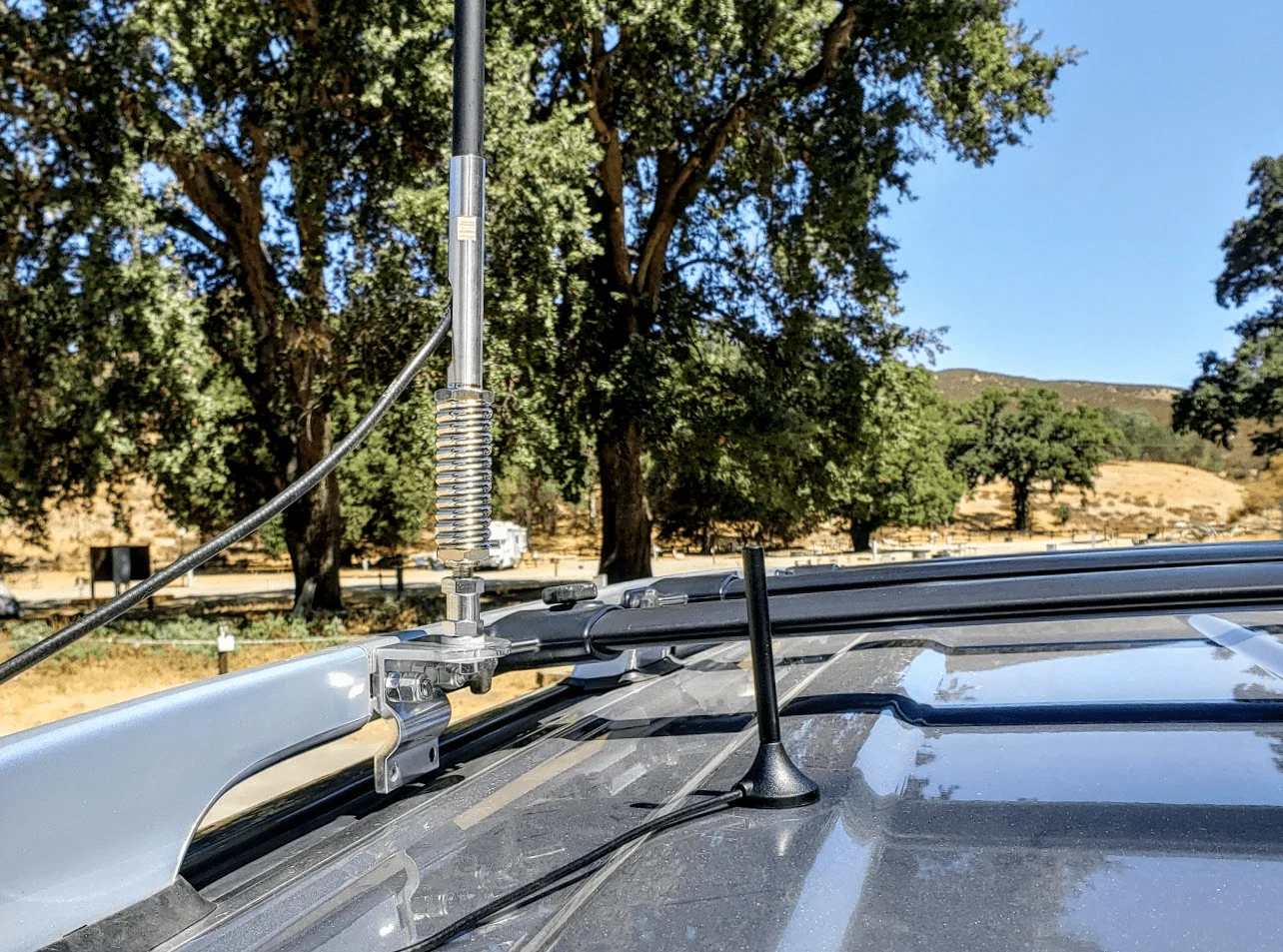

Took a cue from @LC4LIFE and got a Weboost trucker antenna. I used right angle half of the mount it came with installed to my stock (LC) roof rack via two carriage bolts in the channel. Drilled out the holes a bit larger in the mount it came with to work with the carriage bolts.
I normally run just the shorty magnetic antenna. Now can easily swap for the larger trucker antenna when in more remote areas. I leave the right angle base permanently attached and can thread the trucker antenna on as necessary. The trucker antenna comes in 3 sections so it's easy enough to shorten and lengthen depending on scenario.

Does the truck driver antenna make that much of a difference over the 4" magnetic? I run the WeBoost in my Subaru daily but with the LC I might get a CB mount and use the truck driver antenna if it really makes a difference and worth the money.
Weboost advertises the trucker antenna to have a 2.5 to 3.5dB advantage, which is a doubling of signal strength. In practice, while it won't be anything near a doubling of distance (that takes 4x the power or 6dB), it should result in appreciably further and/or stronger signals being usable.
