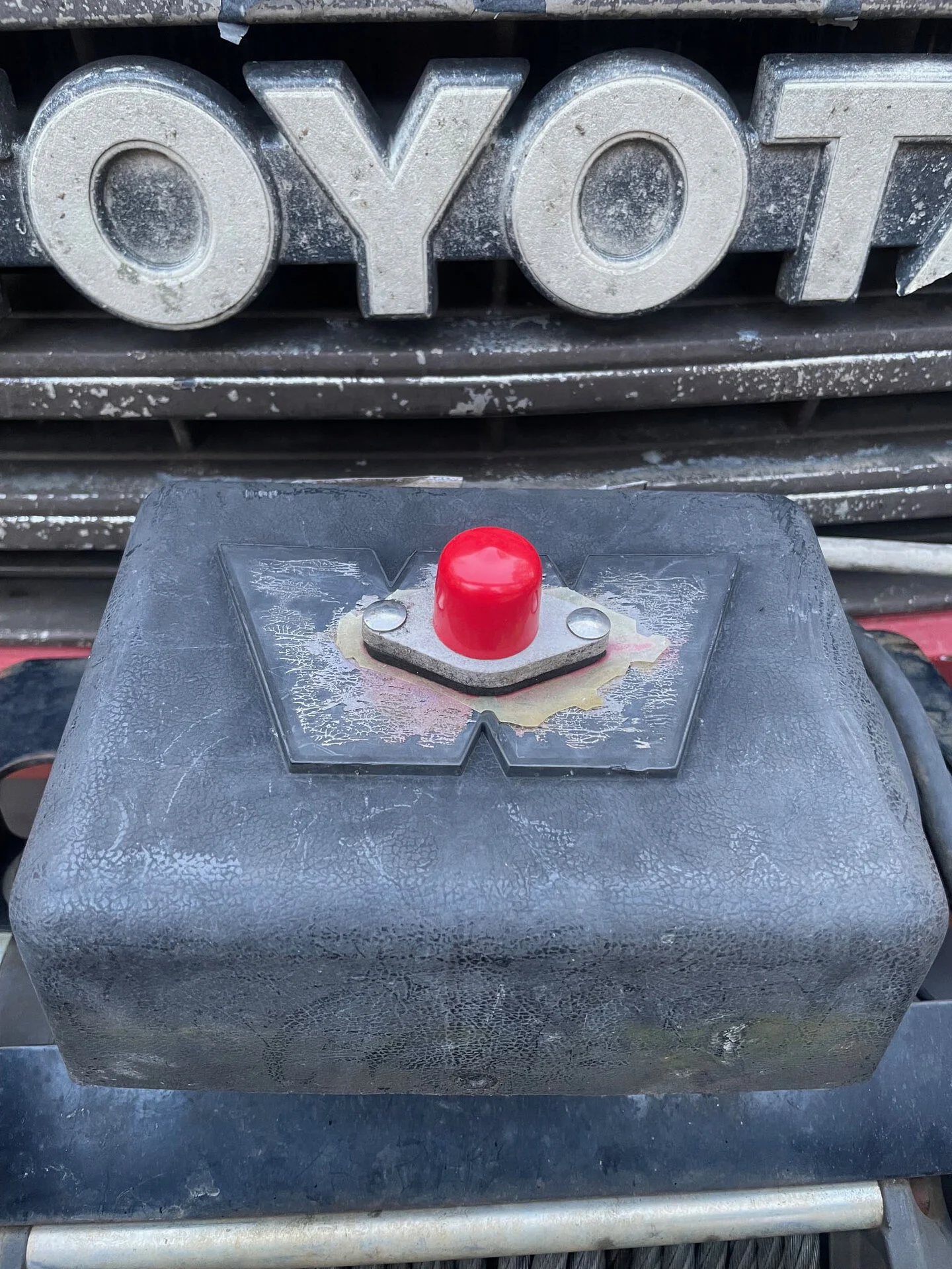

The protective cap for the control plug on my Warn 12k winch deteriorated years ago. I've been concerned about water entry and finally decided to find a covering for the exposed plug. This is a vinyl cap from McMaster Carr. Fit is snug so it'll stay on and I went with red for visibility.

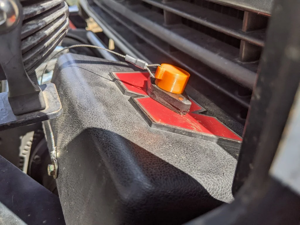

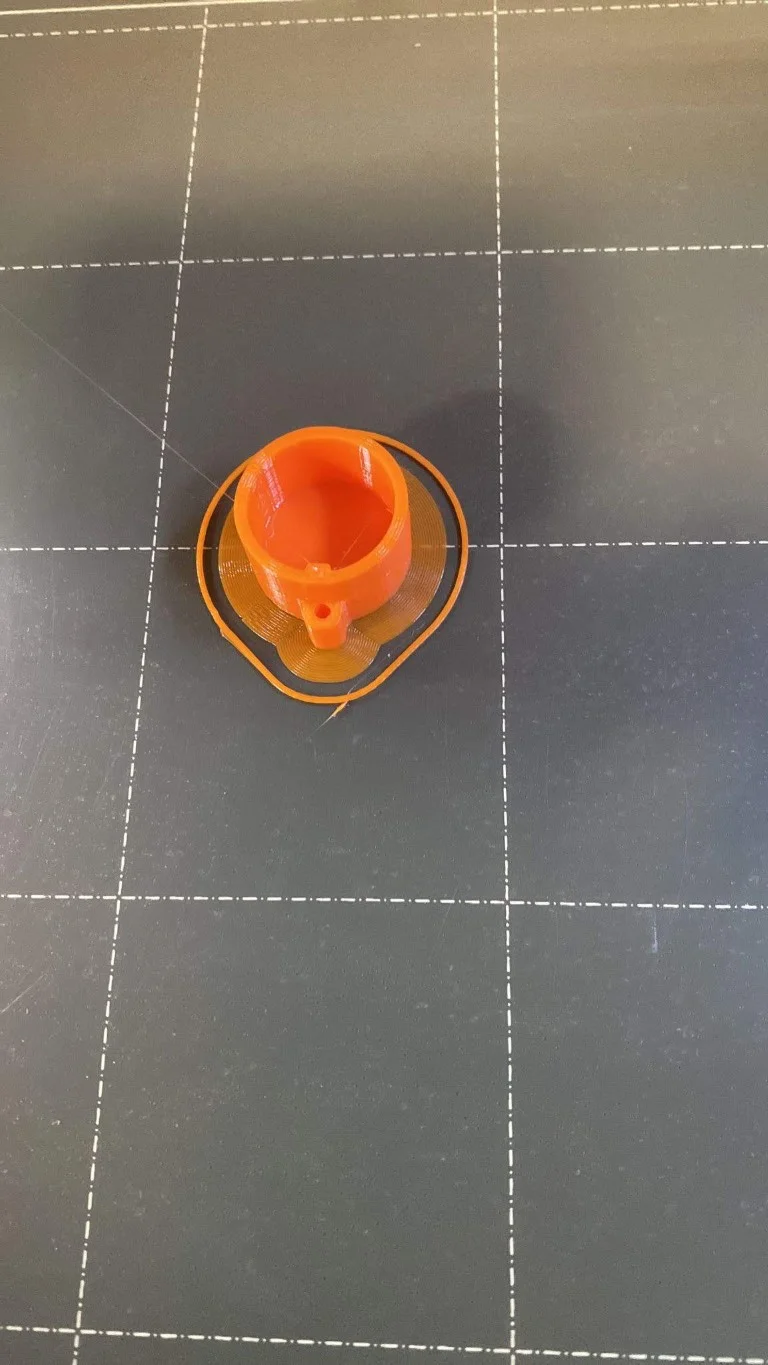

I designed and 3D printed a replacement cap for mine. Also made it to allow a retainer to be used.
cheers,
george.
In case anyone wants to 3d print their own, the STL file is attached. I have the solidworks sldprt file if someone wants that, just ask.
cheers,
george.
