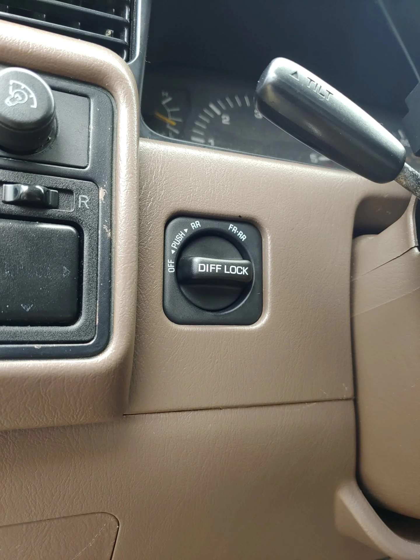

Finally got Deacon back from East Coast Gear Supply. He's now x3 locked and no more growling/vibration in the driveshaft 😁
Everything was complete a week in a half ago, but they wanted to use the OEM diff lock switch instead of the separate toggles.
So I guess I bought this for nothing lol.
I'll find something to put there eventually.

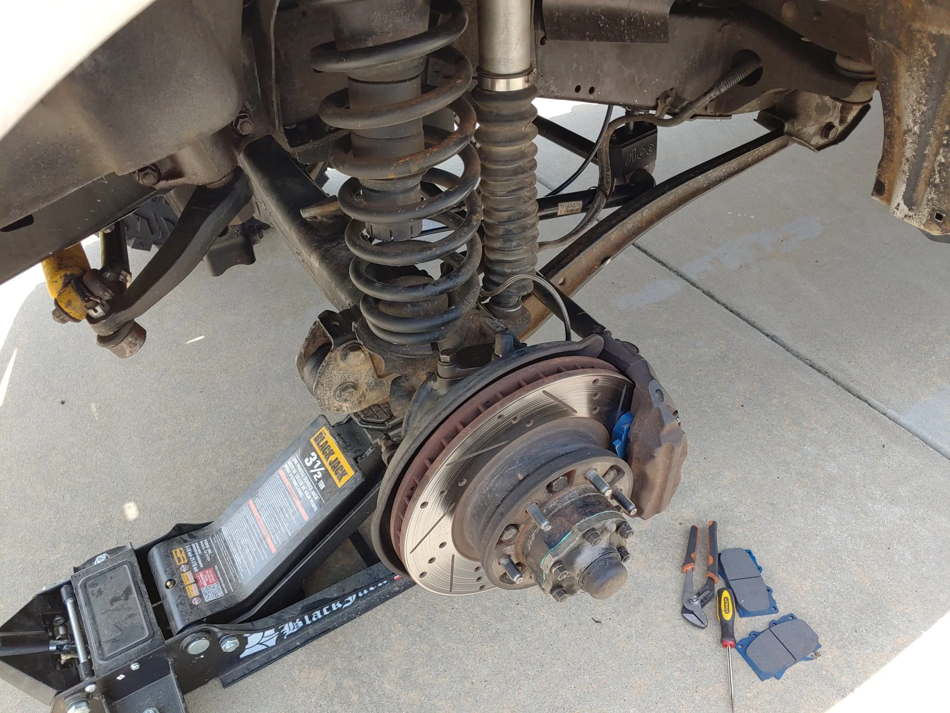

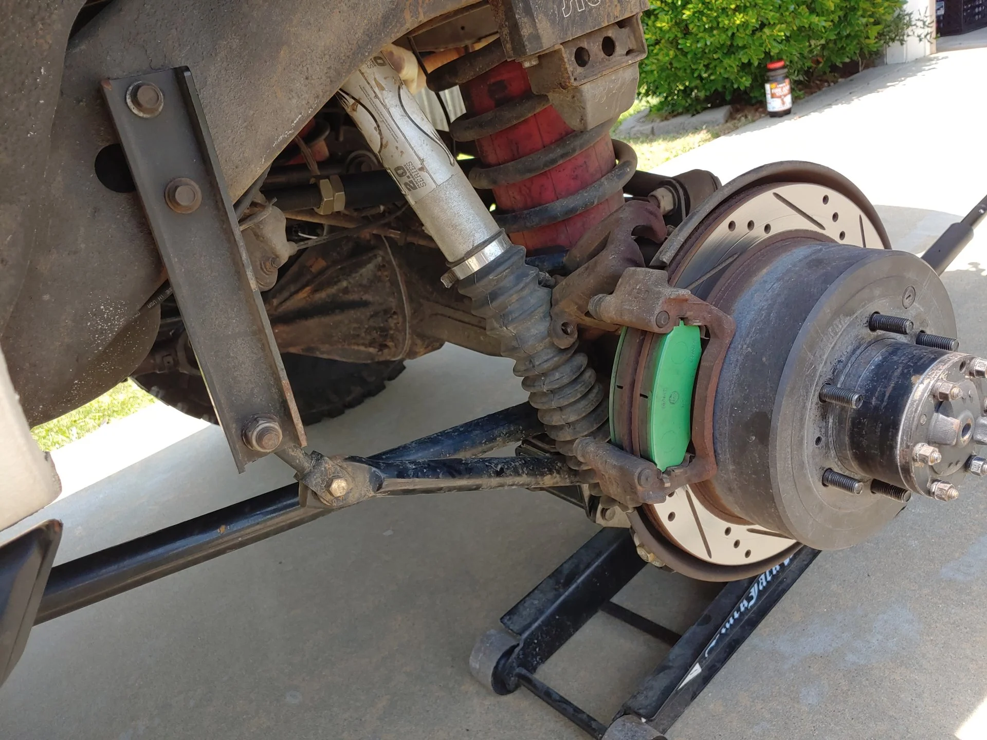

This is the first time using these, so I have no feedback for you at this time. But the front are snug going in.
I'm going back to 80 series pads when I do mine next.
Did you have the 100 series front? If so, why are you going back to 80?
I have been running the 100 series pads in mine for the last 100K miles.
The first 15K miles on each set are too tight and tend to drag. This leads to pulling and overheating of the rotors.
Also, through LOTS of reading and interpretation and pondering, the larger 100 series pads actually do the OPPOSITE of what one would expect. To improve braking performance. Not to say I've had BAD braking performance.
If you look at pounds per square inch of pressure on the rotors using the 100 series pads vs the 80 series pads for the SAME pedal pressure, the 80 series is actually higher.
Noted. I'll do the same on the next change.
Improved performance using 100 series pads on your 80 is conjecture. I went with 80 series pads intentionally after reading a gajillion threads about the 80 vs 100 pads. It was all very subjective and seats of the pants opinions.
