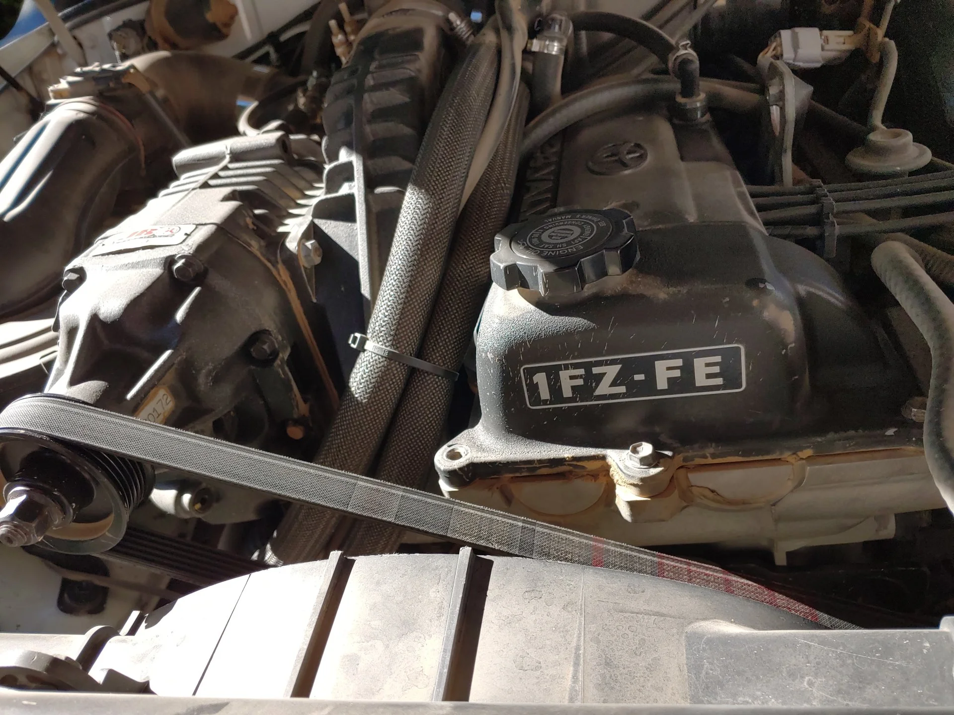

Anyway, let's talk about the supercharger and intercooler. Driving ~6 hrs from North Carolina to Tennessee my average engine temps were ~193° (with AC on). Twice in traffic I saw 206° so I turned the heat exchanger fan from auto to on and temps dropped to 198°.
Today on the trail I started with AC on and temps got up to 204°. I turned the AC off and temps stayed around 185°.

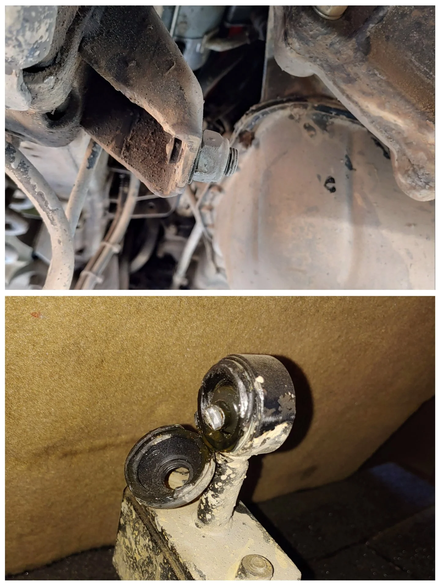

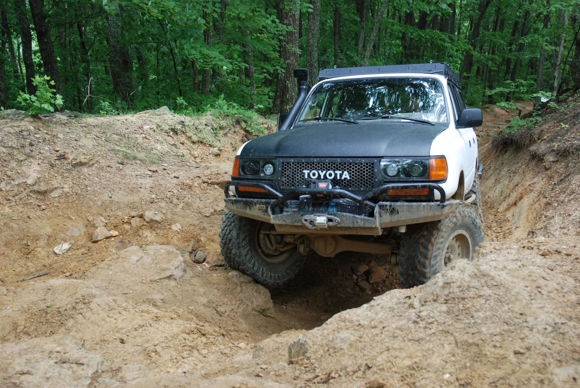

Also I found out that I don't have the signature 80 series flex. I'm running Whiteline front and rear heavy swaybars. On the road it's great. Very little body role. On the trail it's a bit "stiff" and doesn't articulate like 80s are known for.
With it being stiff and less body role helps when close to boulder and trees that love to jump on and damage body panels. The down side is have to turn on the rear lockers to help getting over the obstacle where other 80s are able to do it just in 4-low.
I do have front swaybar disconnect that would help, but I first want to test the "sag" before running it in the trail.

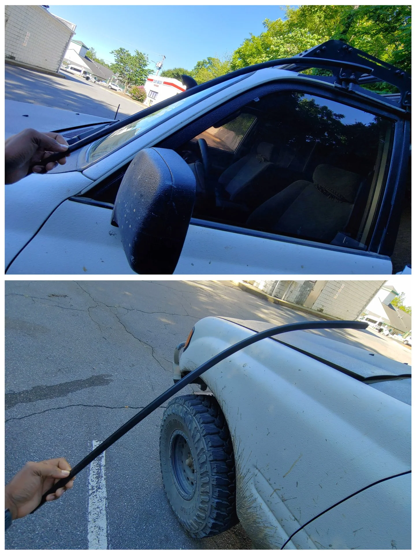

OK, lets start with the bad at GSMTR. Well its not really that bad, just little that happens. On the way there, the wind caught my roof molding and ripped part of it off.
Showing off my engine bay and @GearGeek wasn't impressed because she noticed I was missing a bolt in my valve cover. Glad she saw it, because they were all loose. . .but no leaks.
On the trail i kept hearing a pop. @Bryanseye looked under the truck and noticed my front swaybar link was sheered off.
These are the Whiteline HD swaybars. The link was the weak point.

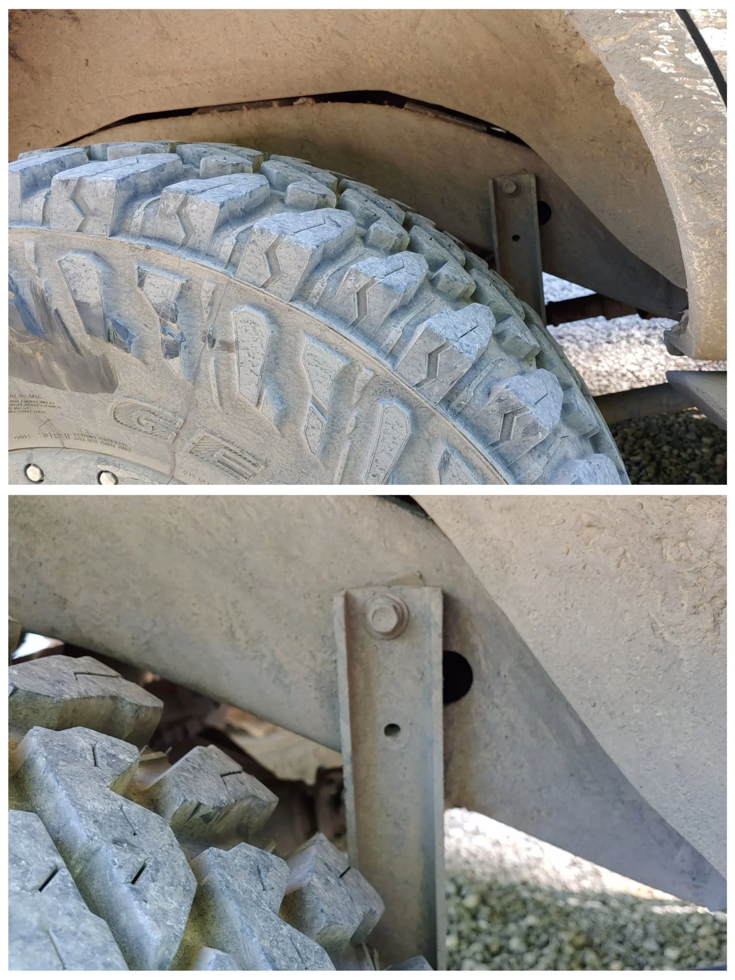

Then i kept hearing popping and looked at my rear swaybar bracket and a bolt was missing.
This same bolt has come out before while wheeling. The rear swaybar is also a Whiteline HD.

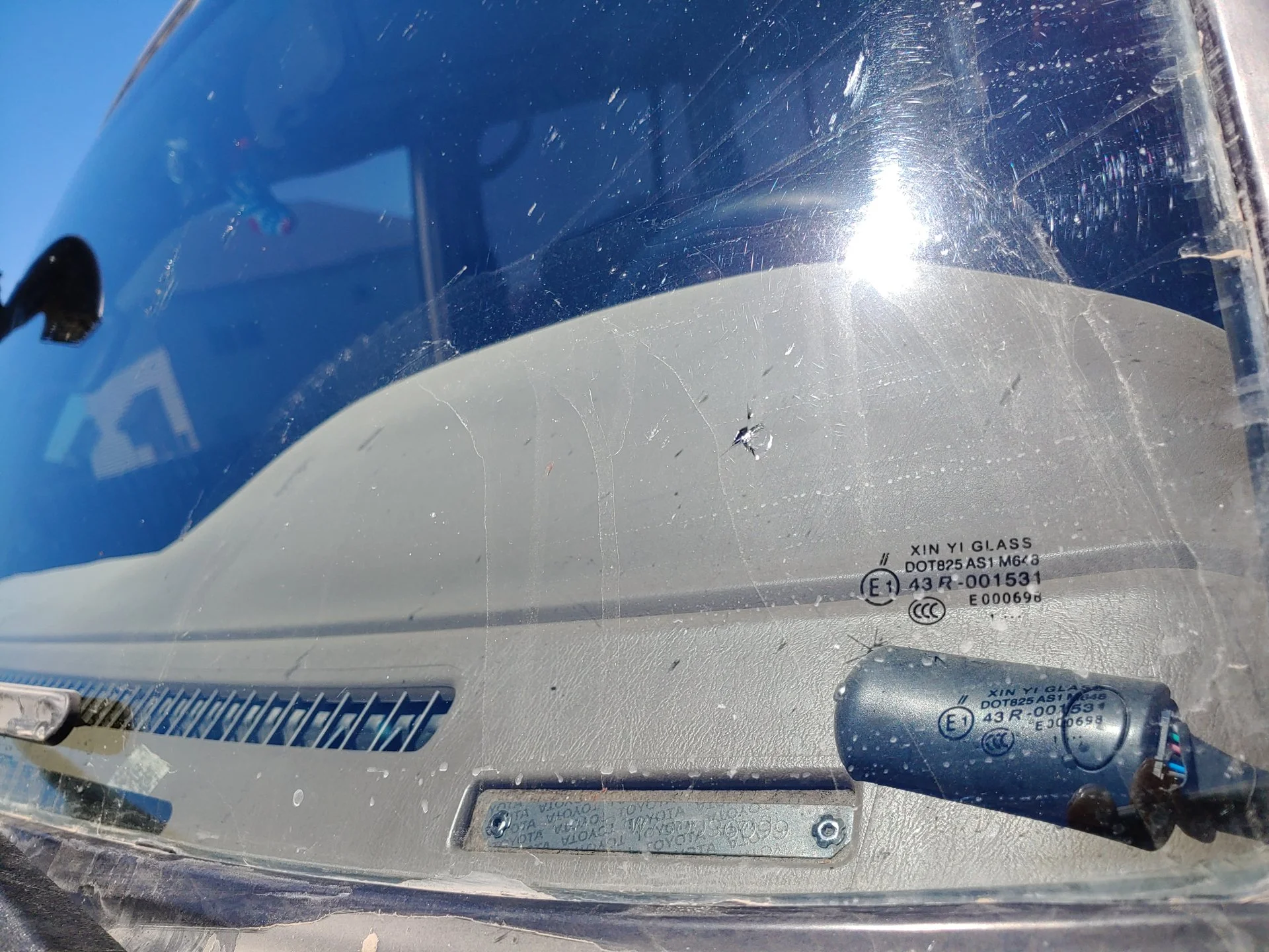

Lastly on the way home a rock hit my windshield.

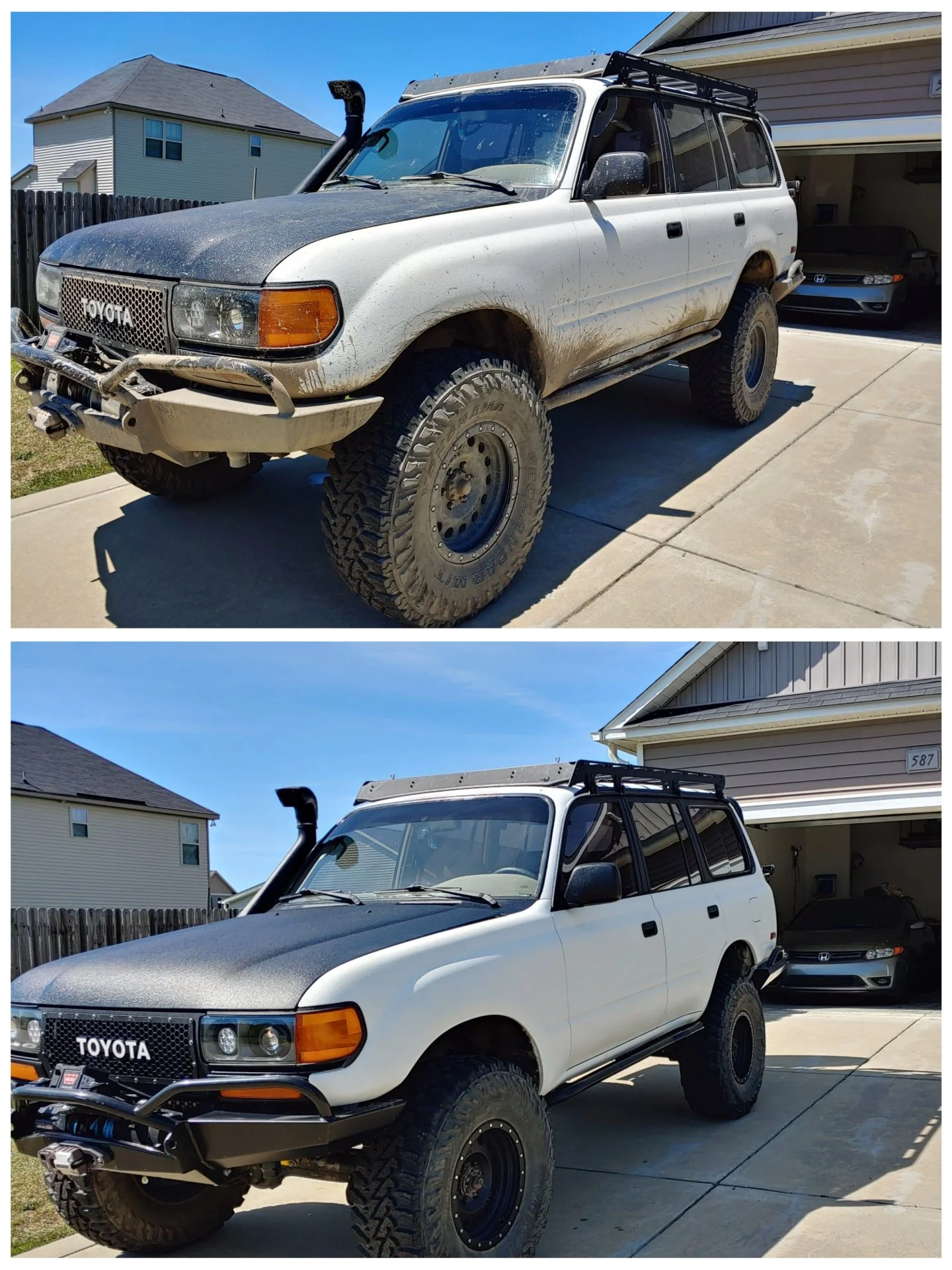

Got home, unpacked, and did "Stage 1" of my cleaning.
View attachment 3038436This same bolt has come out before while wheeling. The rear swaybar is also a Whiteline HD.
I took a rock to my windshield coming back from GSMTR one year too :doh:
