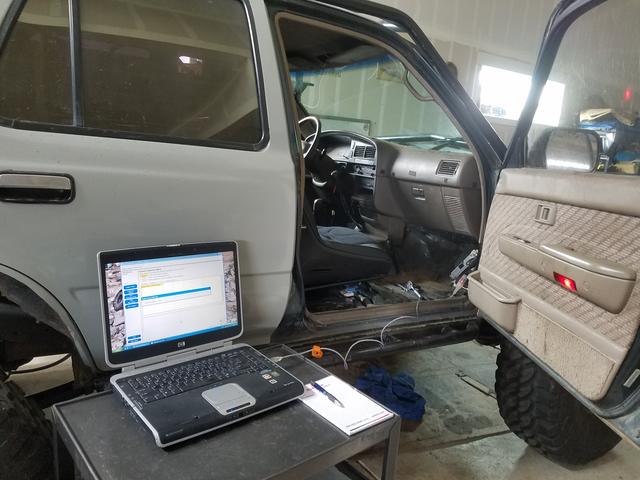

A couple of days ago, I finally got my old dinosaur laptop running XP to download and work with an old version of Toyota Techstream. Armed with that and a FSM, I started digging into finding out what is causing the high idle.
It was a little weird using a computer for diagnostics. This will definitely be a learning curve for me.
Anywho… I pulled the codes and found P0125. I cleared the code. Fired the truck up and played with the real time monitoring. That was very cool, but I really didn’t know what I was looking at. She was still idling high and my computer needed a reboot, so I unplugged it and started doing some “old school” diagnostics.

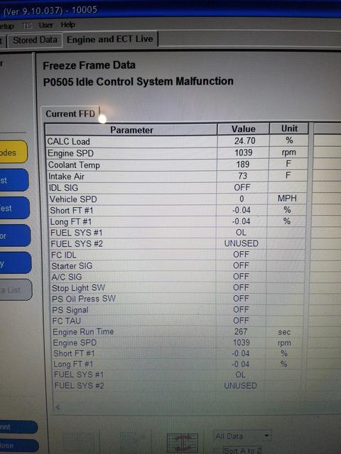

I drove her a bit (maybe a mile), just to see what would happen. The MIL was on, she wouldn’t idle down by herself, and I got light constant throttle hesitation twice. Got back to the house and plugged in Techstream. This time I got two codes: P0125 (again) and P0505.
P0505 sounded promising and there was a “freeze frame” stored showing what was going on when the trouble code happened. I wish I know what it all meant. LOL!

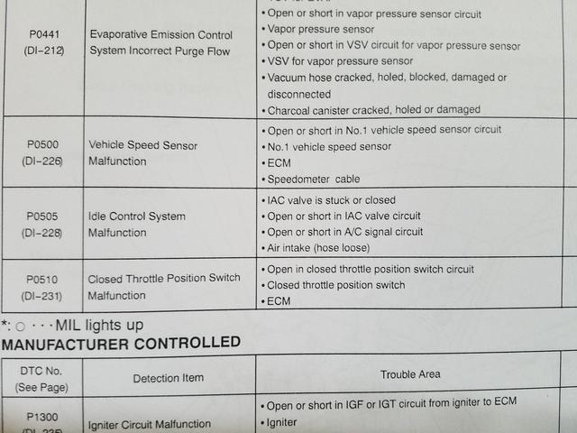

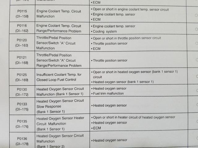

After that, I pulled out my FSM to see what it said about those codes in the diagnostics section. I got this:
And this:
So from what I can deduct, there is something going on with the O2 sensor upstream of the cat and an issue with the IAC. I had to move on to another project, so I put my tools away with the game plan of chasing the P0505 code first. That seemed like the correct path to fix the high idle. Then it occurred to me that I caused the P0505 code when I unplugged the IAC….
