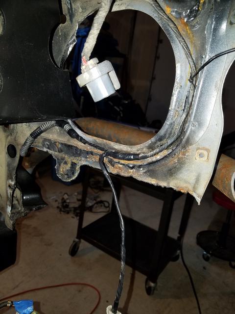

I finished wrapping up the wiring in the engine compartment.

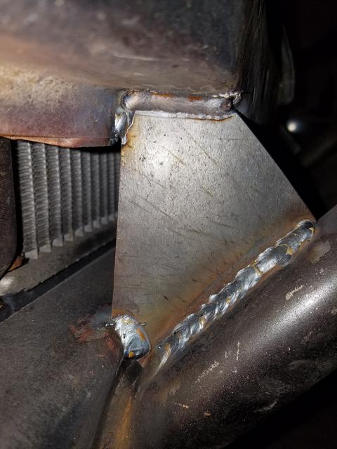

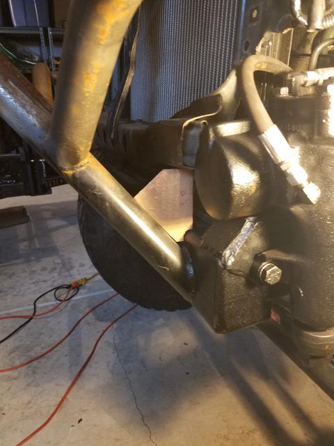

Then I moved on to the front core support. With all of the cutting, the bottom was only supported by the radiator. I could see this being an issue! LOL. So I broke out the CAD (Cardboard Assisted Design):
And quickly realized my welding is way out of practice... (Fail). Oh well, good enough for this purpose.

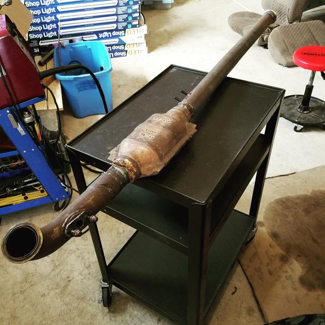

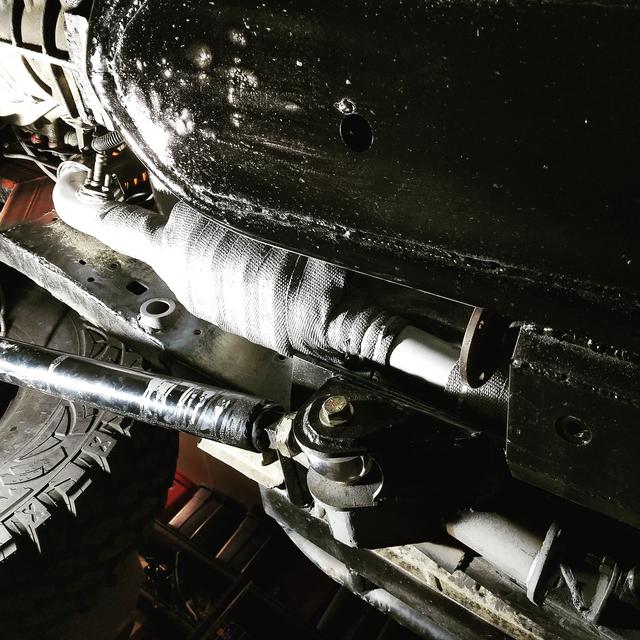

The brakes have been sorted and bled, so it should stop. LOL! I have been mostly working on the exhaust. The PO had it coming from the crossover pipe, to an O2 bung, then a long pipe, another O2 bung, the cat, muffler, and tail pipe. I figured I could just make two cuts, flip the cat around, and set it up correctly.
I measured it by eyeballing and figured I had just enough space for the cat. Well, I may have been a bit wrong. It is TIGHT! I ended up putting heat shielding around the wires and on the body trying to protect everything. I also exhaust wrapped the cat and piping under the floor. It ended up being so tight that the cat is touching the floor and the pipe is touching the crossmember. Like I said, it is stupid tight. I’m going to try it and hopefully not have to redo this exhaust.

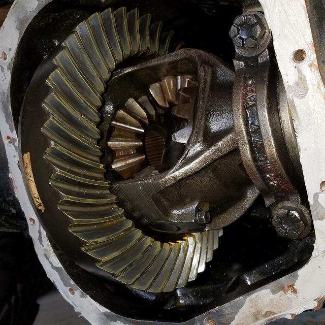

This pic was taken while I was warming Caitlyn up for her first test drive. I was upset enough that I just got her back home and parked her. Last Saturday I figured it was time to pull the inspection cover and see just how bad the damage was. This is what I saw:
Yep, not a drop of lube. I ran on the assumption that the PO would have filled it, but I never checked myself. That is my own stupidity. However, there are no metal shavings and no heat marks on the gears. All the teeth on the r&p loop perfect. I think I just seized the pinion bearing! Talk about the best possible outcome of a bad situation... I am blessed! I am going to order a Detroit and a master install kit to rebuild the rear-end. Speaking of which, does anyone know how to set up gears that would be willing to come over and help me? I have helped with setting up Toyota 3rds before, but that was a long time ago.
Luck is right!!
Doesn't look like a welded carrier unless there's a few spot welds on the bottom spider I can't see in the pic :lol:

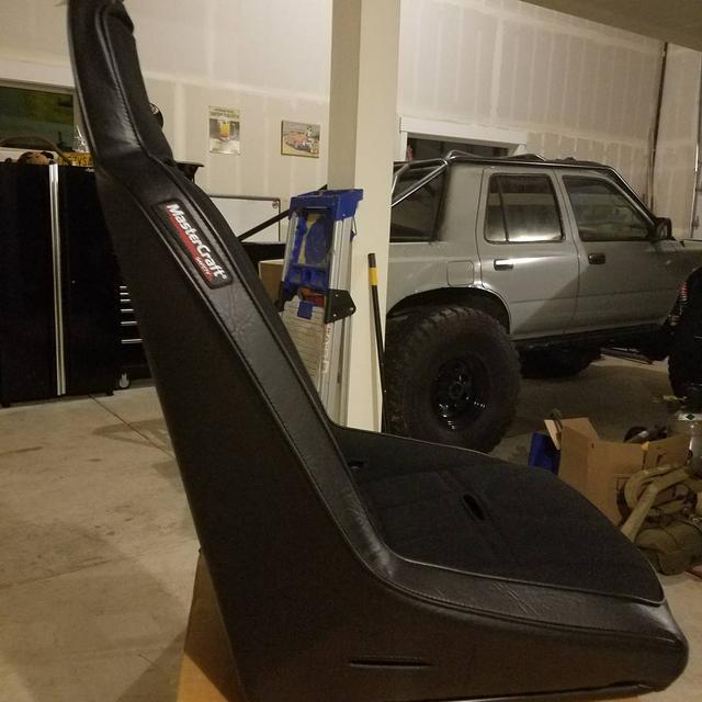

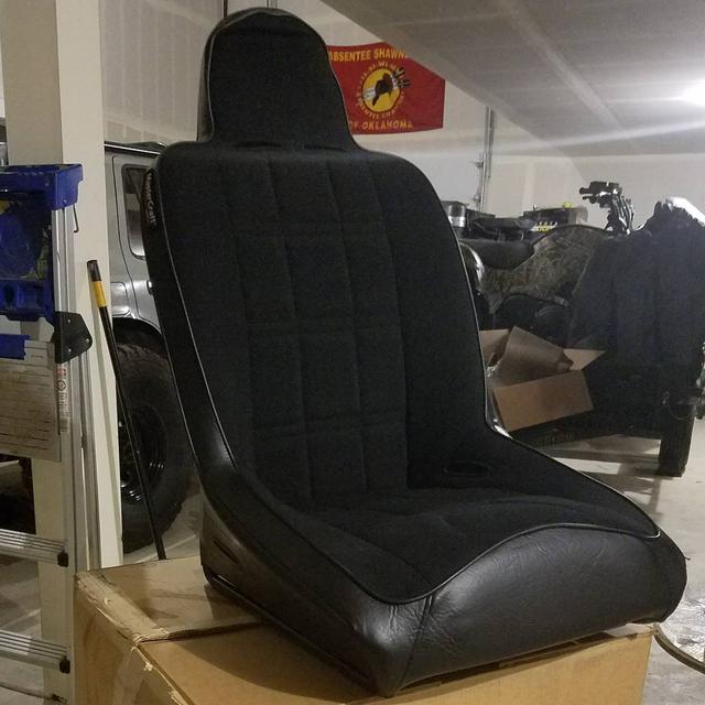

Small update: I bought some seats. Rusty's Off Road was having a sale on MasterCraft Nomads, so I picked up a pair.

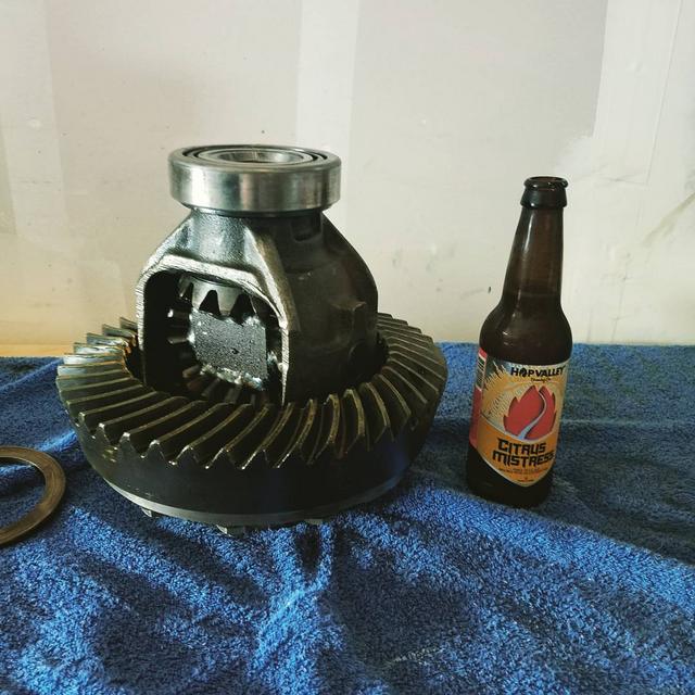

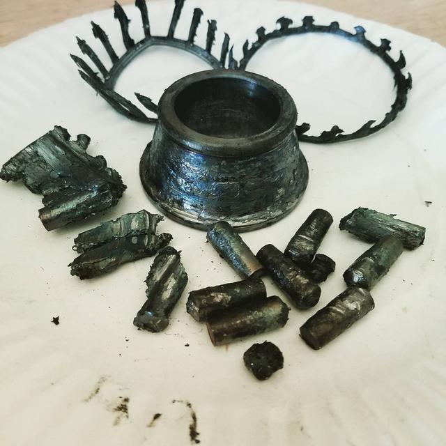

I was also able to pull the rear end apart with a buddy. Tons are big! As suspected, I just toasted a pinon bearing. I have never seen on this far gone before. It is amazing that there wasn't any other damage.
A week from Friday another buddy is coming over to help me set up the gears and the new Detroit locker. I also ordered new rear springs since I bent them pretty badly when the rear end locked up. After that I should be ready for a test run... This time with 90w in the rear end. LOL
