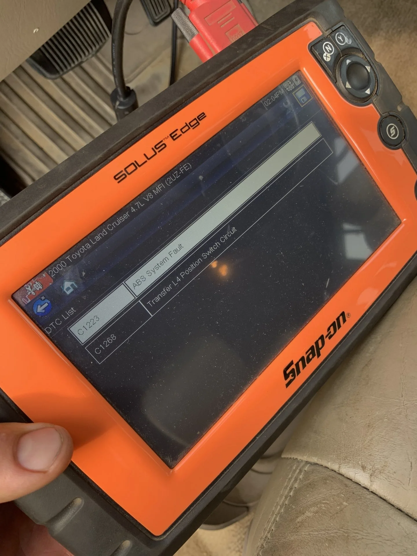

Hey guys and gals, I’ve searched and had no luck. Everything pops up for the 200 series rigs.
driving my new to me land cruiser a couple weeks ago and I realized it has an Overdrive off button on the shifter. So I pushed said button, harsh down shift and then Christmas trees on the dash.
vsc, abs, all that fun stuff. So I clear the codes when I get to the family shop and go on. Noticing it hunts for gears especially in overdrive, in and out in and out. Only way to make it semi right is turn the overdrive off.
today I drive it it again and pull codes since I don’t have my own personal scanner.
the codes that pull are
C1223 abs fault
C1268 transfer L4 position switch circuit
no engine or trans codes.
I’ve found this flow chart, https://lc100e.github.io/manual/rm/rm970e/m_di_0294.pdf
Also should mention I was a tech for 15 years, I’ve just not got access to what I used to. But I’ve still got a multimeter and hope to get a better diagram.
input?
Thanks!
