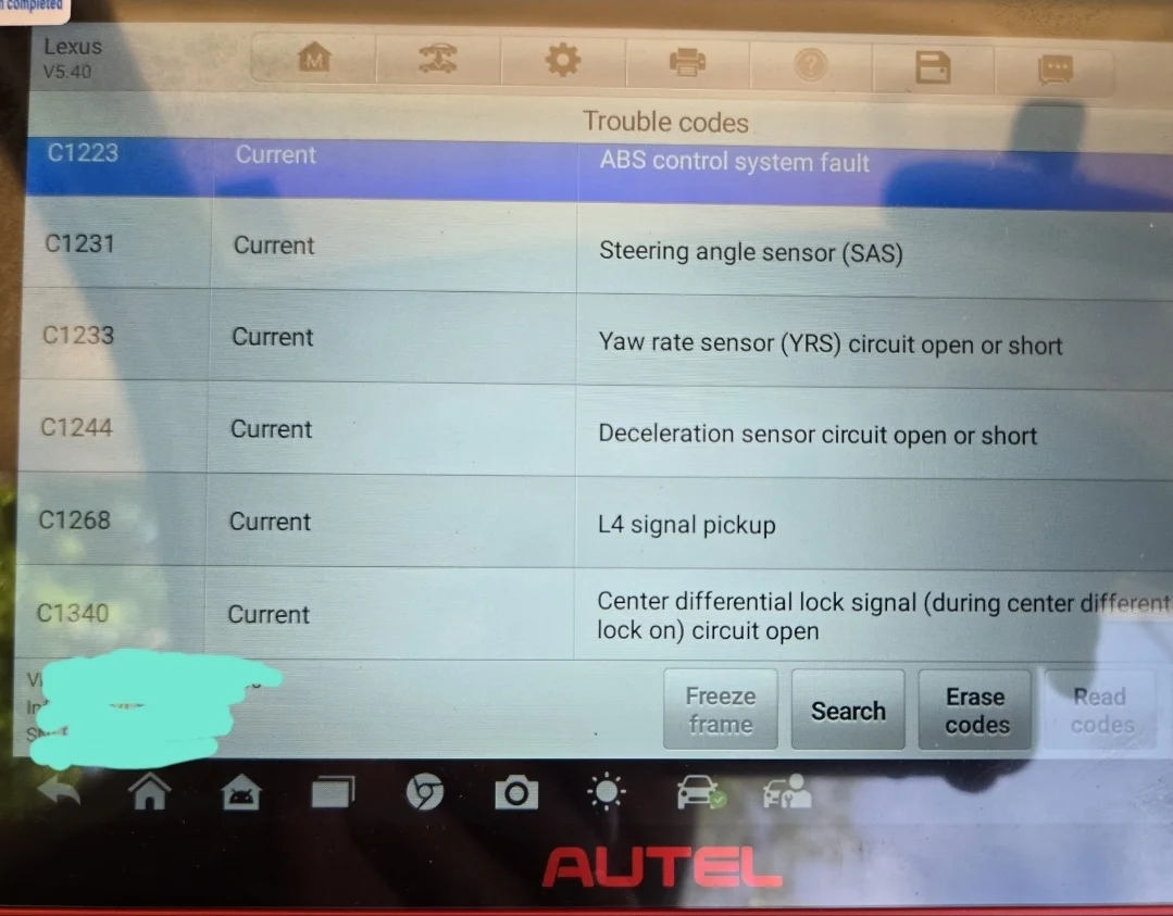

Help with C codes related to potential ABS or wheel speed sensor issue? C1231, C1233, C1244, C1268
Aug 31, 2025
2
7
Kansas City
Does anyone know where to start with these codes? Scanned from an Autel.
All the codes seem to intertwine, but unsure where to start.
Looking at replacing all 4 wheel speed sensors to see if this solves anything.
The only symptoms I am currently getting are:
Brake light on.
Speedometer slightlv off by ~3mph. Brakes pulsating sometimes. Transmission slightly jerking a second after it goes into D or R.
Any tips or ideas where to start? Or are the wheel speed sensors a good place?

Any tips or ideas where to start? Or are the wheel speed sensors a good place?View attachment 3986854

2000 LX470, 190k miles. I just purchased the vehicle.
No work performed prior to reading codes.
The brake pads are needing to be replaced, so I assume that's what the brake light is on for. It doesnt explain the codes, however.
Is there a better way to trouble shoot which "sensor" it is? The YAW sensor was around $500, same for the deceleration sensor.
As far as AT fluid, im not sure, I have it on my list to drain/refill with fresh fluid.
Tire size is almost stock, 265/70/16.
I'd download the service manual. It, and the EWD, are in the Resources forum. There is a diagnostic tree for fault finding in the service manual. CTRL+F for the DTC, back up to the start of that section, and you'll find it.
Yes! I've never seen a bad one. So I've not diagnosed. You'll need the FSM, and follow the tree on those DTC. You'll find FSMs (factory Service manual) online, Try the FAQ section, for one. If you're going to wrench, it will be invaluable.
