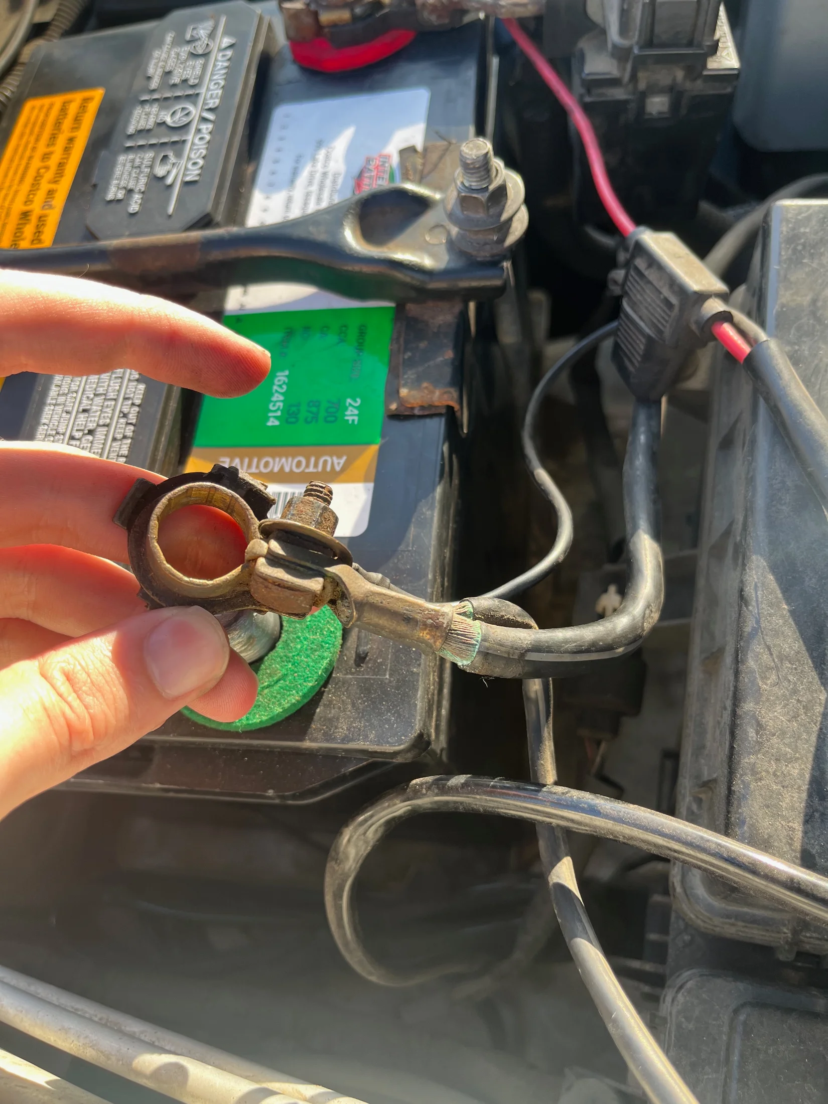

Is this enough corrosion on my battery terminal to cause issues? The stalling problem only occurs when the headlights are on. Car will start fine if the headlights are off, if they are on it will stall and then I give it gas on the next start to stay alive. Battery voltage is 12.7 with the car off, dips to 11 when I turn the starter then when the engine runs it sits at 14.1v
Doesn't look horrible but maybe..... follow the ground to the other end of that wire and check where it connects with the vehicle. If you have the time to remove and clean it all up or even just replace the cables it wouldn't be a bad idea ...how does the positive look ?
Interesting to hear you have a steady 14.1 charge voltage when running , so maybe it is just a bad ground giving you a hard time when starting
