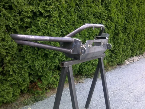

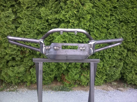

I'm working with Jason @Cruisin' off road to make me some sliders and front bumper. Trying to figure out a front bumper design and whether or not to keep the PTO winch.
Any advice on whether or not to keep the PTO winch? I'll have about $200-300 to get it up to snuff. A decent ComeUp 24V is 700-800$. I'm not sure how much better the approach angle will be with an electric winch. Here is the bumper style I like, and will have Jason build me one just like this (Which accommodates PTO or electric) or one specific for electric which will tuck in a bit tighter.
The PTO winch has a certain charm about it. I happen to think they are cool...YMMV.
The PTO setup has a certain allure to it, no doubt, and I really want to like it. It certainly has a cool factor to it, and if I wasn't so enamored with my lovely wife I have no doubt that the line "come check out my PTO winch" would be a wild hit with the ladies.
I imagine it will get used a fair bit, the truck doesn't have lockers and probably won't for awhile. That's a big expense I can do down the road. But the proposed route home goes through Moab, so with open rears right now I expect to be giving it a decent workout. If I do keep it, I'll do a small service to it and fit it with 80-100' of 3/8 synthetic rope.
I guess my real question is with a stock geared, stock t-cased, 5 spd truck on 33s can I effectively use the PTO to get myself unstuck in moderate wheeling situations. I've used a PTO winch the exact same number of times as I've driven a 70-series LC, zero (0), so am in new territory here.

PTO? I love old tech - keep it if you can get it working. Not sure how much you need more extreme approach angle or how much difference the PTO vs. 'lectric makes, but the 74 is a pretty neat package to begin with.
As for the bumper, do you have deer, elk, pedestrians in Central Pennsylvania? If so, you might want to consider adding protection a little higher up on the front clip. The classic ARB-style bull bars have saved a lot of guys, or so the anecdotes would suggest.

Yup PTO's are super reliable and can run all day without worry and definitely have a cool factor...... until the motors not running and you need to winch the truck off of its side, out of a hole or onto a trailer, then they are useless. Oh and then when the shear pin lets go and your buried in mud and now tied to a tree. Also they are no good for winching and driving together as the speed of your wheels and the speed of your winch dont even come close to matching up. Not to mention they really kill the approach angle in factory form.
So it really depends how your going to use the truck?? Personally ditching the PTO was one of the first things I did but some people like them. With a little searching I am sure you can find countless threads debating the topic, rather then having your build thread turn into one

We have both deer and elk in PA, and the pedestrians are typically quite well fed so I will consider an additional bar or two.
I'm pretty sure I'll be keeping the PTO winch. While it's a good idea to never say never, I can't imagine getting myself into a terrible situation when out solo that a PTO wouldn't work. I plan on getting an extra shear pin or two to carry as spares. And will make it a condition of my wheeling companions that they have nicely functioning winches :)
