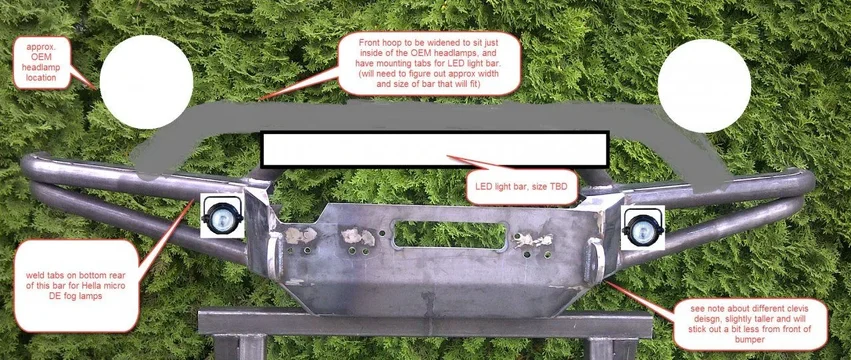

Here's a poor sketch of the front bumper layout that Jason and I are designing:

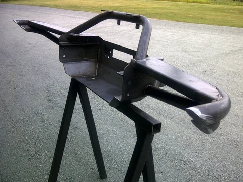

I don't think Jason will modify the PTO winch at all. Here is another view of the bumper from the other side. I'll be sure to take a bunch of photos once it is fitted. He sold this to a customer and unfortunately never got any installed photos!

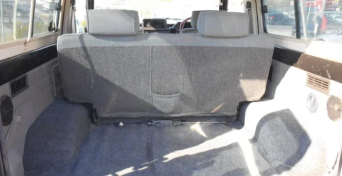

It's funny that some of the trucks didn't have rear seat belts but it looks like all the rear seat backs have a pocket to stow the belts when not in use??
