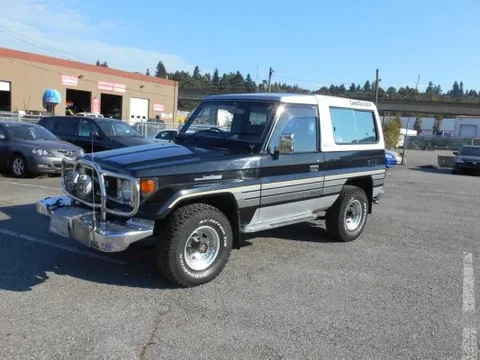

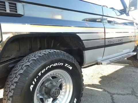

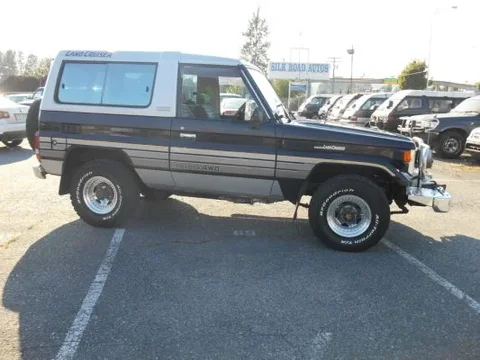

After a few weeks of searching and reading lots of the 70-series tech archives, I'm going to add my name to the owner-list!

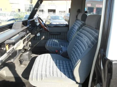

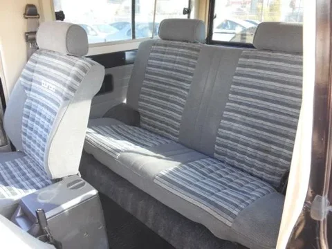

Buying a '89 BJ74, fresh off the boat from Japan, from a dealer in Vancouver. I've had a PPI done and the truck looks and sounds to be in great shape. A few small items but overall a very nice, original, low mileage truck with some awesome overtly-80s seat fabric and door panels!

If you see something terrible or think I've made a horrible mistake, speak up ASAP. Still might be time to stop the wire transfer!
Nice looking truck with low miles........
The batteries are mis-matched so I would consider replacing them with a matched set.
Nice looking truck!
I paid for a PPI and he said it was one of the cleanest he's seen in quite some time.

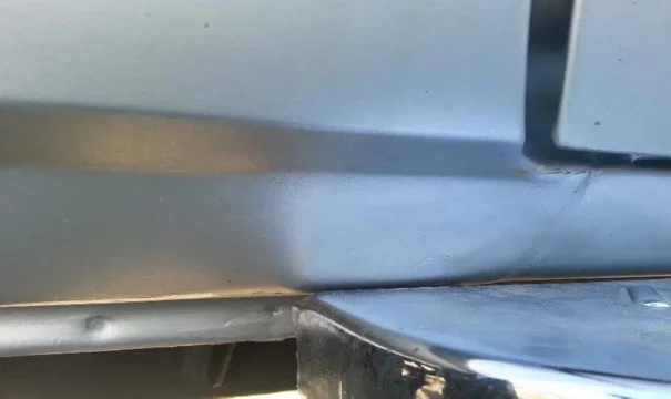

A spot of repair in the driver side rocker. Not thrilled about this, but it's 25 years old, and coming back to PA. It's a tool, not a jewel, right?!
