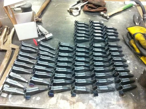

I'm working on tailgates this weekend. I decided to weld all the hooks today. Here is a boring video showing two hooks being welded in real time before I sped it up. Get the popcorn ready, it's riveting. :D
Took all day but I got them all welded and even ground a dozen or so smooth.

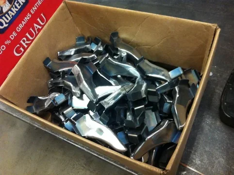

Finished grinding the welds smooth on the hook. Still have to drill drain holes in them and sand them a bit smoother-ish
did the ends - still gotta grind'em

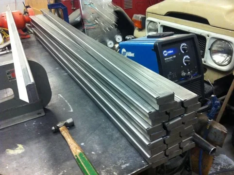

I started the top rails
Got about half of them welded before I ran out of gas

Tonight I finished the top rail welding and also ground them smooth.

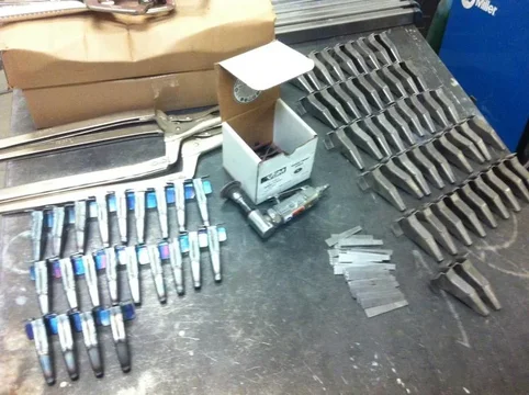

Chicago Pneumatic CP875
The backing pad and discs are knock offs of 3M Roloc style quick change system. You don't have to buy the 3M brand, cheaper ones are out there. I use VSM brand 2" 80 grit discs and Sandtex medium surface finishing discs. That would be Maroon Scotch Brite in 3M. Fastenal sells the discs but theirs wear faster.
