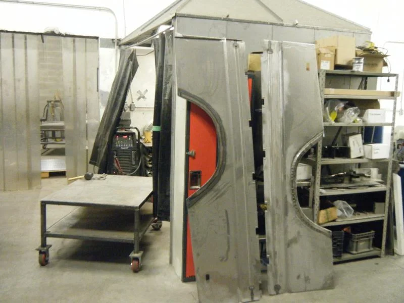

A few teaser shots from last time...

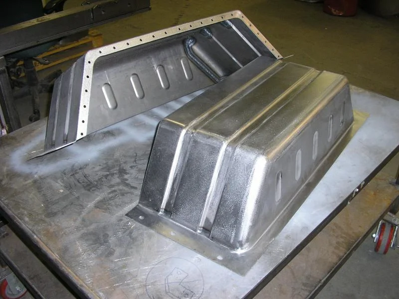

As mentioned, I am adding a few features to certain parts of the bed to make assembly easier and to enhance the original look. These changes include, but are not limited to...
1) I have added pre-punched holes to assist in "rosette" or "plug" welding parts together. Where ever a spot weld is needed I have punched a hole in the less visible part to allow welding. Last time I drilled a lot of holes.
2) The rear corner post where the tailgate chains hang from... My last rendition did not have the pressed in stiffening rib or emboss. I will attempt to replicate that this time.
3) The rear valence... Last time it was just flat where the tail lights mount. Again, I will attempt to press in the recess for the lights. Also, I will be making both the three and four hinge versions. I will need some info from the community on the three hinge. Ideally, I need one in my hands.
4) The tailgate... yep, gonna try the letters. I believe I can do them if I do one letter at a time. The issue then becomes one of jigging and positioning.
5) The wheel humps or wheel wells... Last time I just "threw in" a rib using a tool I have. I will try and make a more original looking inside surface this time.

I've purchased several items from Kevin, and I have always been impressed with (and jealous of) the quality of his workmanship.
I can't wait to see these all assembled - they will be sensational. I wish I was one of the new owners, but I am pretty confident they will be very happy whomever they are.
Josh
