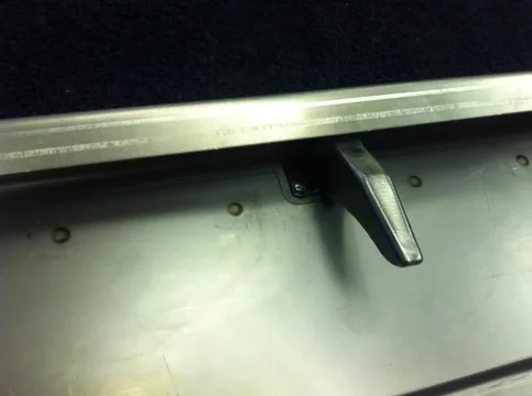

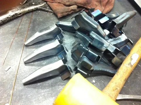

So I welded some hooks

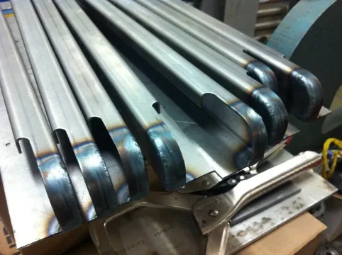

And some end channels

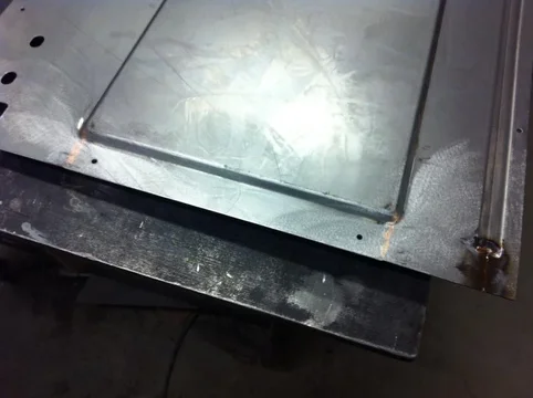

And a skin
Skin

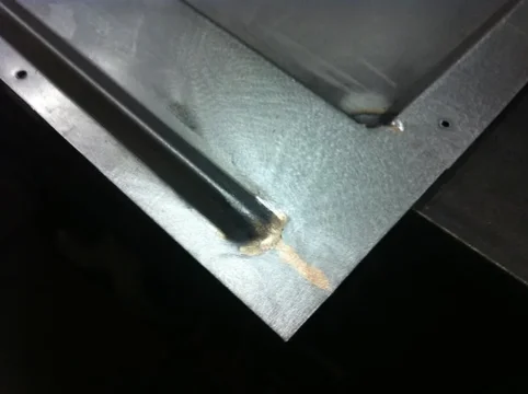

I then took it to the shop and spot welded it all together. The skin panel does have some mild shrinkage issues due to the letter pressings so I paid attention to the tendency of it wanting to twist as I forced it flat. I started by welding the hooks to the top rail...top rail to the skin... bottom rail to the skin. Once I weld the end channels on if its twisted it will stay that way so that was tricky but thankfully quite easy.
Here is the gate missing only the stiffeners and the chain anchors. And some close up shots.
