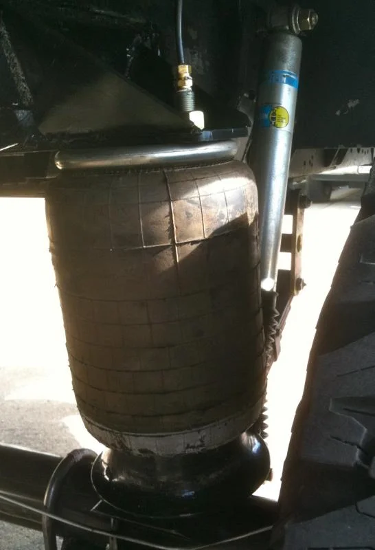

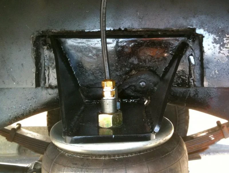

rear air spring/air bags installed
i am using firestone part # W01 358 5426. want to thank you all for your input. this air spring where recommended by Over the Hill 4x4, i spoke to them a couple of times and where very helpful their # is 503 240 2824. i also spoke to firestone tech and this is the air bag recommended as well. see pictures below.
they are currently inflated at 30 psi and can be inflated up to 100 psi. as you can see Nulla is now higher on the rear, no longer has that sagging rear.

bags seem like a good solution for ride quality, I'd carry 1 extra as a loose road debris could otherwise stop your journey.

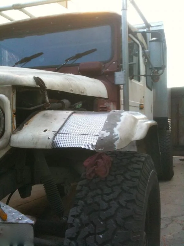

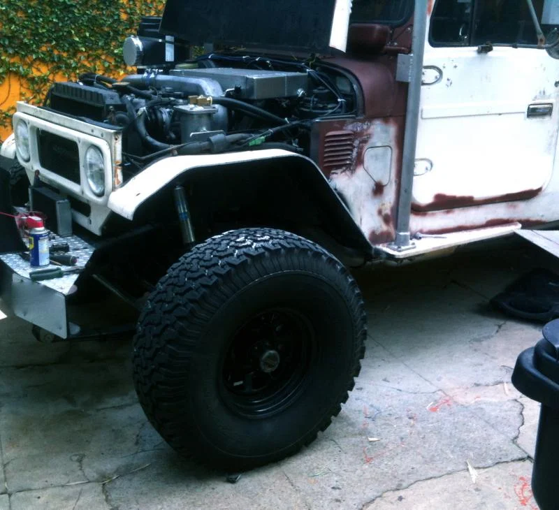

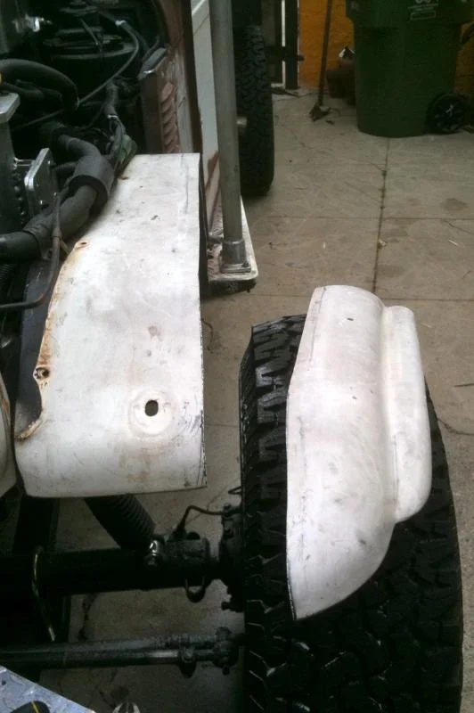

widen fender
took it for a little test drive all was good just need some alignment, i am very happy with the air bags and wider track, nulla is more stable. i worked on the fenders today and made them 7 inches wider, that space that you see will be filled in with fiber glass. :bounce::bounce2:

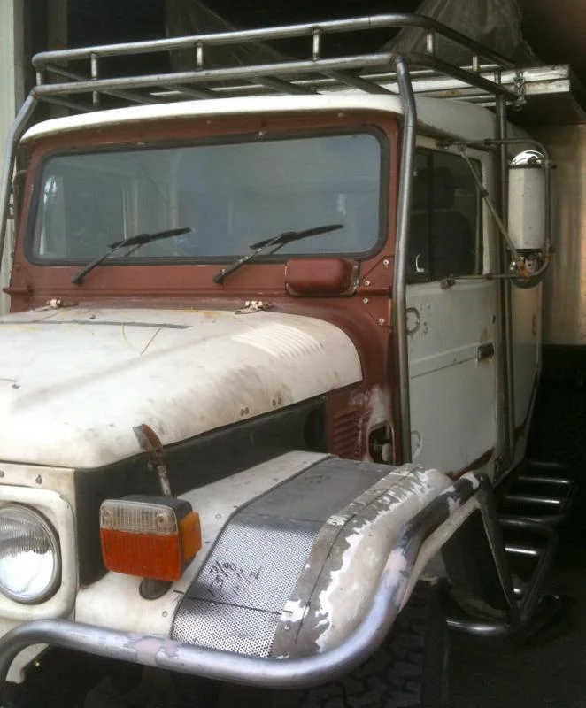

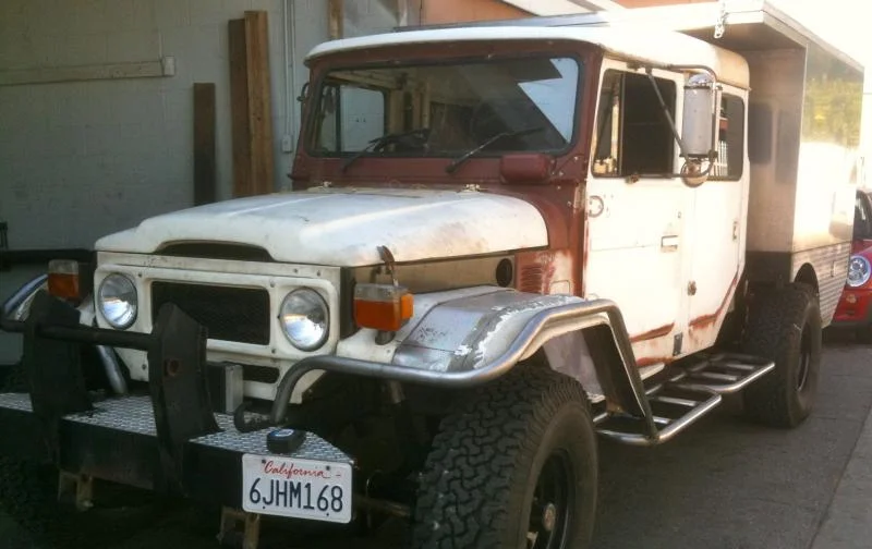

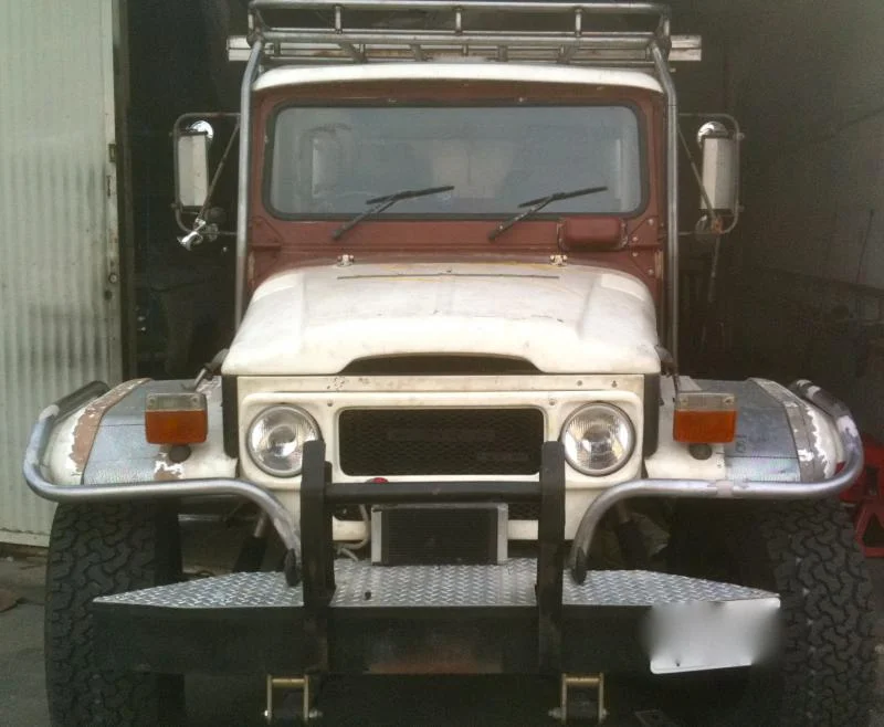

Nulla is still at Custom Fabrication Off Road. see picture below. here is what is being done;
1. the tubes have been removed and send for powder coating. all the tubes including the rock slide are removable (bolted on) the top of the rock slide will have an aluminum diamond plate floor when done. tube protection will also extend to the rear following the contour of the rear wheel well all the way to the back. i will post those pictures when done.
2. the rear of the cab is being opened up so that the "camper" will be access from the cab and vis versa.
3. the exhaust will run to the rear instead of it current location which is on the side before the rear wheel.
other modifications are being made and i will share pictures when they are done. i have not been able to work on the fender and roof fiber glass because of the rain. i have decided to do that when Custom off road Fabrication is done. thanks and enjoy:bounce::bounce2:

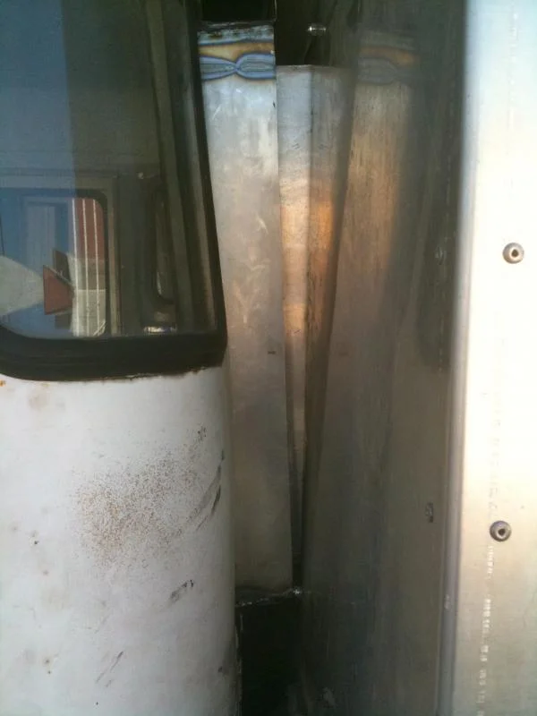

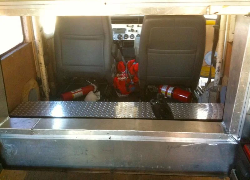

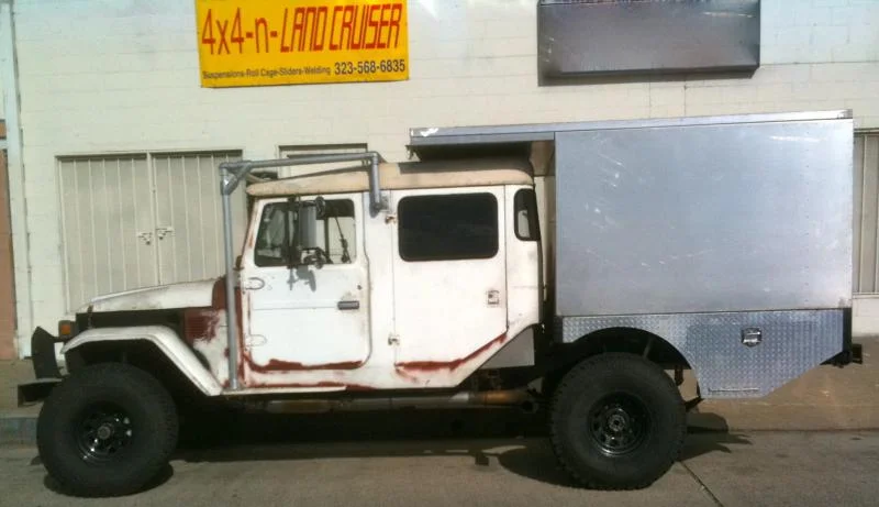

update: cab and the camper together
the cab and the "camper are now joint together, see pictures. those are two rectangular frame one for the cab and the other from the camper. they are floating on to each other to allow for the flexing. the frame on the camper side is removable so that the rubber seal will be installed later. enjoy :bounce::bounce2:
