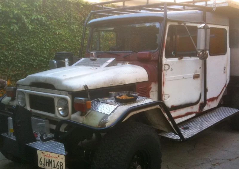

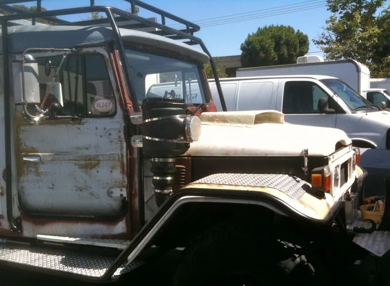

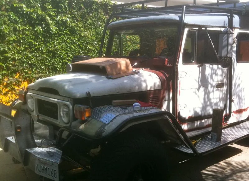

intercooler repositioned

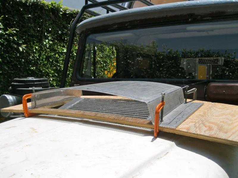

i have reposition the inter cooler to lessen the heat sink from the engine. see picture below, the intercooler is 3 1/2 inches slanted up ward over the hood. the over all dimension of the intercooler is 3 1/2" thick x 11" wide x 24" long.
i will also put a air scoop over the hood what you see on the picture is a mock up. the mock up is 6 inches high (too tall), the final intercooler will be 4 inches high. note that the opening of the air scoop is bigger in the rear, i am thinking of designing it this way to catch the air coming off the windshield. what do you think of this design? :cheers:
Do you need the hood scoop at all ?
I take it provides some sort of protection for the inter cooler?
It looks better without it IMHO.

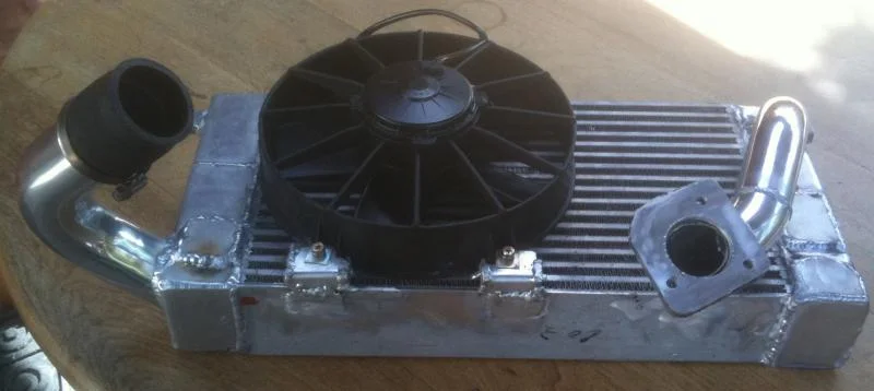

intercooler and injectors
here is my intercooler with a puller fan, the fan will pull the air through the intercooler and blow air to the back side of the engine, it is design so that the fan will cool the intercooler while blowing the hot air away from the intercooler. this will hopefully lessen the heat sink cause by the engine. the fan will also serves to cool the back side of the engine. this SPAL fan is rated at 1390 cfm.

,... i am thinking of designing it this way to catch the air coming off the windshield....
Sorry, late to this thread, just checked the last page.
Not sure how you envision 'air coming off windshield' to cool engine. The 1% I can see that happening is a downdraft when you're parked facing the right direction.
Please explain. Will read all after this post and delete if my Q is answered.
edit: imagining air @ hi speed = water, can almost see a back eddy on the windshield, with the 'scoop' (which becomes an eddy-making boulder, pulling air in behind it).
and if I jacked that up, it's only my 2c worth.
there is a post here and an experiment but i cannot find it. it shows that the air coming off the windshield to the hood. however since i did that post i have tilted the intercooler as you can see facing the front and placed a fan to pull the air through the intercooler so i don't think my original design is still relevant. at this point i am still trying to figure out the king of scoop i am gonna put in.:cheers:

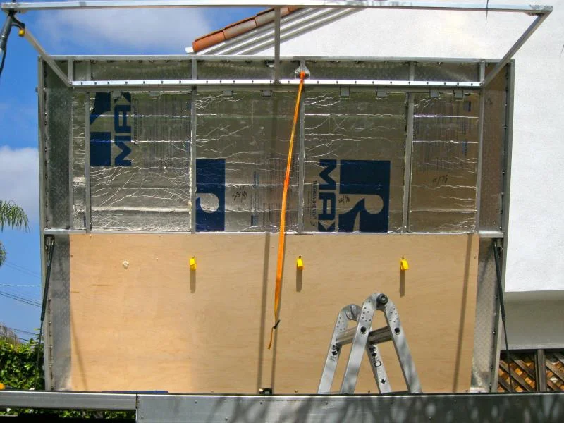

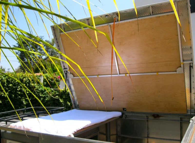

pop top update
here is the pop top insulated, paneled and the bed over the cab, the canvas is now being installed at the Sun City Upholstery, Huntington Beach, California. pictures of that will come later. we are getting ready for a trip.:cheers:
