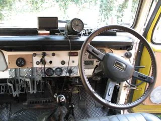

Did you get your original steering wheel leather bound or is that aftermarket?
what halfshafts are you using with the housing you're getting made? would be fairly easy to accomodate airbags on it if you're getting it custom made
the leather came from Man a fre, SOR sell them as well.
i do not understand your question about a half shaft. the axel shaft will be custom made by Diamond Axel to accommodate wider axel housing.

The 70 series wheel is just a standard 15" (I think) size. The 40 series is the one which is a bit difficult to find, because it is a 17" (I think). I've never seen these steering wheel wraps in Australia, but you can order them from JC Whitney and have them sent here. I have brought six or seven of these back with me from the US for the in-laws, and they absolutely love them. When I sold my Hilux a few years ago, the bloke from Darwin who bought it told me that the reason he was buying mine was because he loved the steering wheel... Make sure you get the genuine leather one.
Cheers,
Josh
I've used bicycle handle bar tape to wrap a steering wheel. You'll need a few rolls.
the leather bound wheel looks pretty cool, do you know if they do one for 70 series?
halfshafts are just another name for axle shafts. you getting them to make the axles fully floating ?
the steering cover are genuine leather, they are great but they are not toyota specific, it depends on the size of you steering wheel mine in 17 inches, you can get them at different sizes. i am sure sor or man a fre will ship it to you but i don't think it is the cheap way to go. try ebay.

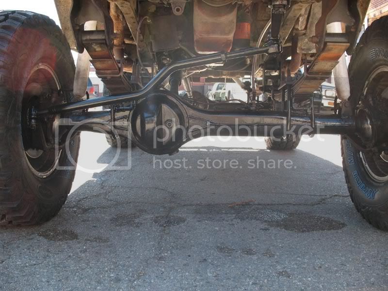

this looks scary
What are you talking about? It looks like Zorro has been there! :flipoff2:
Are those 60 axles under a 40, but instead of outboarding the springs, the spring pads were inboarded and SOA'd, while using the stock steering arms instead of High-steer?
