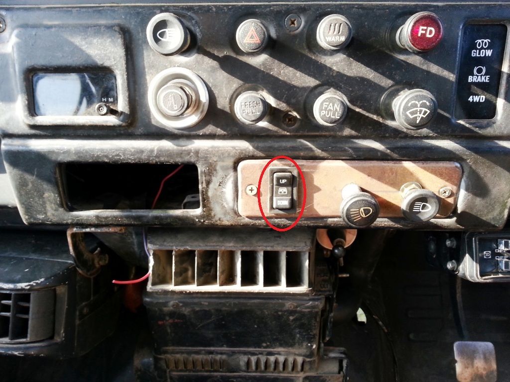

Okay, what the heck is this?
I only BARELY managed to resist echoing The Greek's words..."it's the up and down switch, silly" :D
On a more serious note, that's the interior switch for the winch. The winch I fitted to the Phantom does come with a long-cable remote control unit, but this interior one is for those occasions when you'd much rather be seated in the vehicle, while you operate it. An additional switch panel was required for the multi-function lights...I thought I might as well use up the remaining real estate on fixing a switch for the winch.
