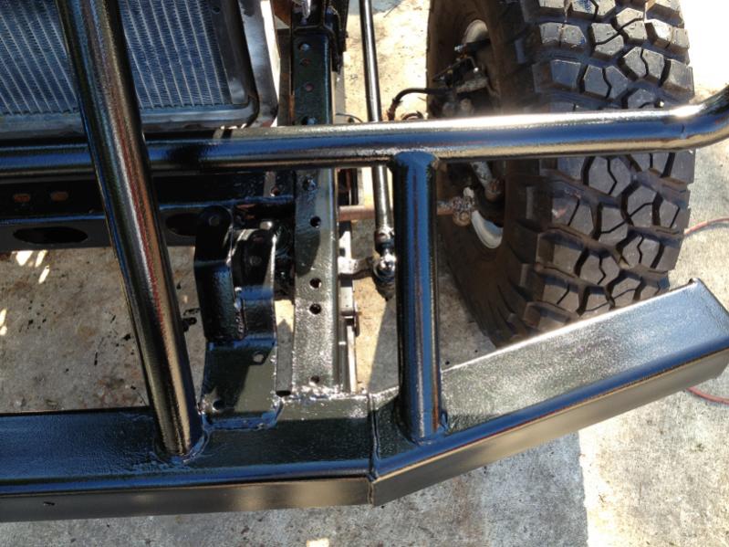

What kind of winch is that? I am trying to figure out what i can use with my custom bumper. I dont think I will be able to fit my high lift into my highlift mounts that came on this bumper.
It's an OEM Toyota winch, which I'm told (by my parts provider) was culled off a Series 80 TLC, second-hand. I'll post some pictures of the mounting arrangement when I get around to taking some photos, if you're interested. However, the winch DID sit with very little difficulty at the "sweet spot" between both arms of the chassis...which was pleasantly surprising, since I'd wanted to keep the front profile as unobtrusive and "un-busy" as possible.
And having seen your bumper, I agree: it doesn't appear that your jack is going to fit there easily.
Edit: In fact, after having looked at your bumper arrangment closely, I think you're going to have to mount the winch externally, and somewhat raised...since there isn't a "channel" (for the winch hook) cut into the bumper for it to be mounted between the arms of the frame. And then, from the look of things, it'll be either the mount OR the jack. Might I suggest another position for the jack? At the space just aft of the front mudguard, mounted upon the footboard, and bolted to the windscreen hinge for added support. I'd originally planned to mount my jack there...but decided to mount it on the bumper, since I didn't have any other plans for the front.
