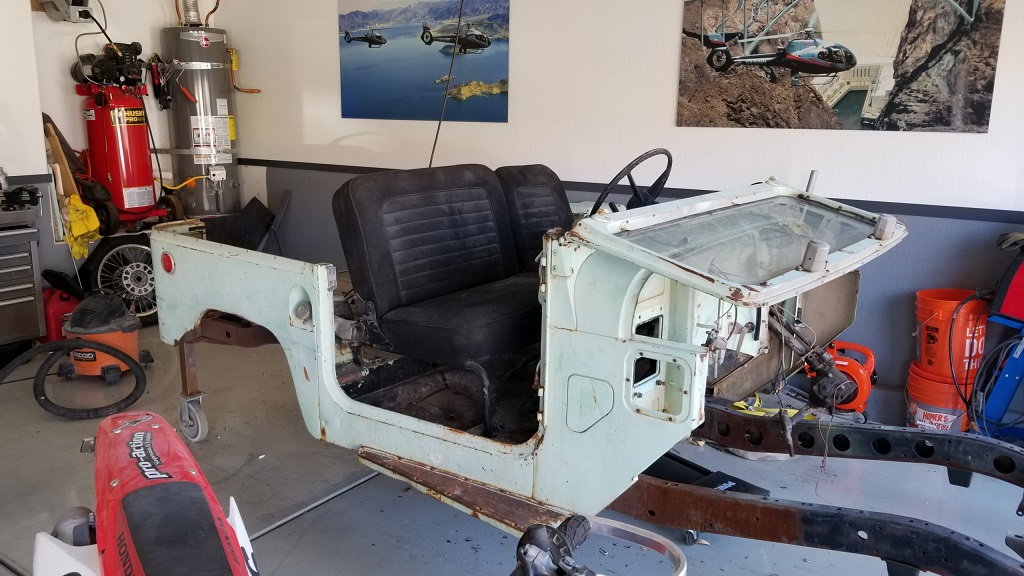

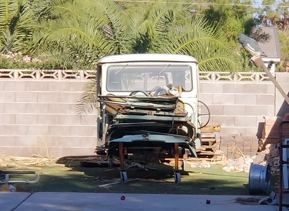

The 40 wasn't exactly a 40 when I picked it up... it was more like a bunch of body panels. This kept the cost down though. I paid $1500 for the tub, frame, and all the panels including two hard tops.
I got it home and took the hard top off. I cleaned it up and got it down to basics so I knew what I was working with.
The tub was pretty nice except for the rear sill. I knew I didn't need it, so no big deal. I got to work with the Sawzall and grinder and tried to make as clean of a split as possible.

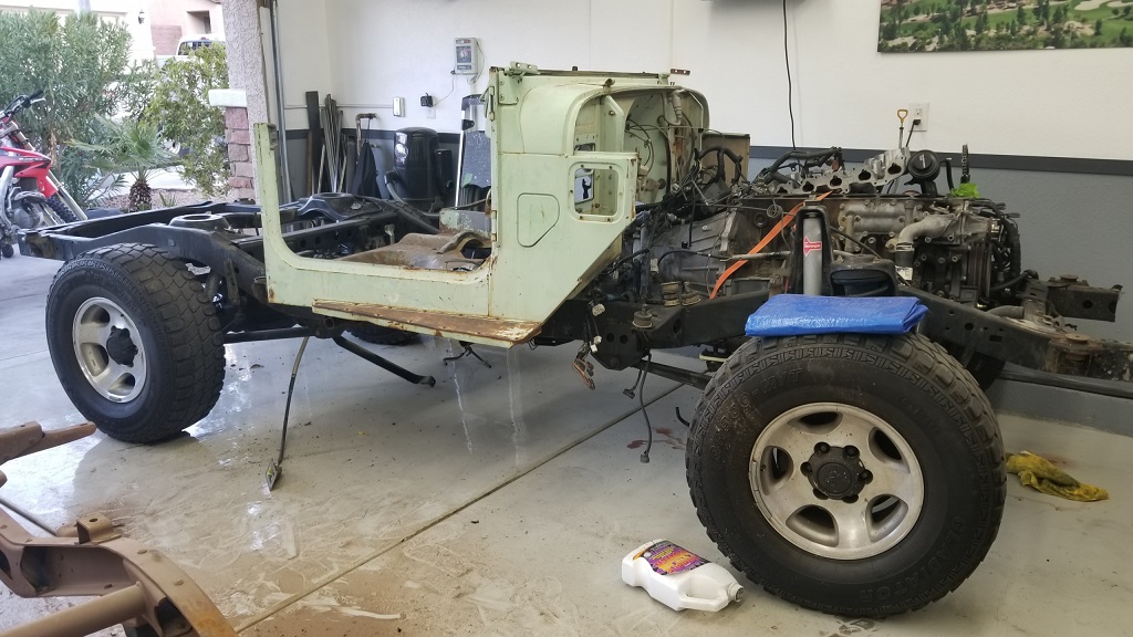

One step closer to being a 45
And setting the cab on the 80 frame for the first time. It's amazing how light it is in this form!
