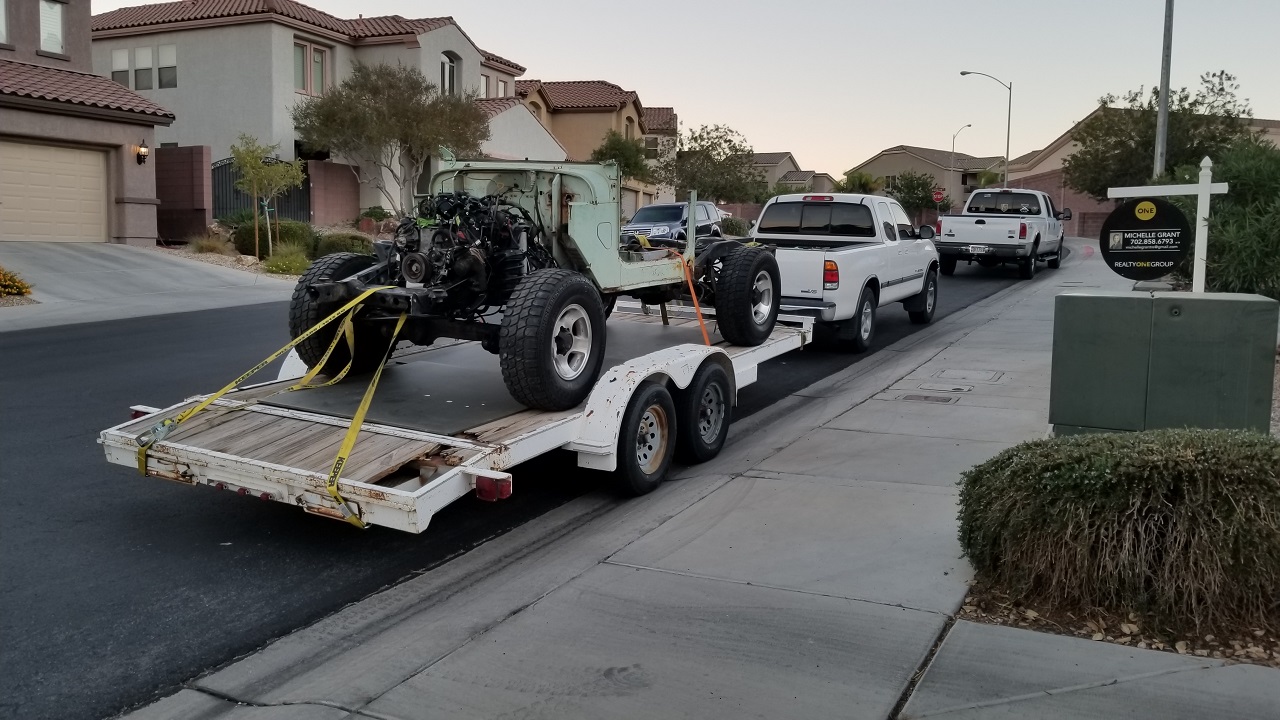

A short drive NW on US 95 (all 4-lane divided highway - future Interstate 11 corridor) can get you a large fenced lot (0.71 acres), a newer (2005) manufactured home on a permanent foundation, and a more than adequate 28'X32' shop with abundant power and a bathroom :). Right across from the school and park. Think about it. Here's a photo with the rolling chassis from my '85 FJ60 parts vehicle on its way to CA and a new owner. FJ62 belongs to @erse, a nice looking rig.
img_20180728_123651-jpg.1755057
