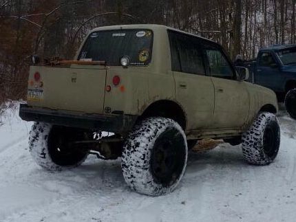

22" difference between WB, roof is rotted as are the rear quarters, so originally thought converting the 70 to a 75, but now considering other "options" similar to these:
Use the 70 series body but cut it straight back from the top of the rear wheel wells and add a small flatbed at the back "extending" the lines of the small part of the 70 body... the wheelbase difference then makes no difference. Cut the top off and build a full cage with a bikini top...

Get rid of all the wrongs with the heavy station wagon body, chop the overhang off, and it might be a formidable rig yet semi streetable.
Yes a greed. After watching and wheeling with the Franken80 for the last 2 years I'm becoming a believer in properly balancing an offroad rig from front the back.
One of the things I've noticed is the rear tires tend to float (for lack of a better description) on obstacles instead of hooking like they should. This creates a couple of problems, 1) the tires just spin in place which simply digs a hole due which then 2) forces the front to provide all of the forward "drive" which results in obvious failures.
So what we've started doing is trying to add some weight over the rear axle to counteract the heavy front. Spare parts, spare tire, tools etc. are obvious in the back but we may have to get a little more creative.

Delancy already has the bones for a wheeler - 5.29s , tcase gears, and an 80 body that is ripe for 800lbs of weight shedding.
imho. if shortbus was "good" at 5200lbs........an 80 thats barebones tipping the scales at 4400lbs will be more than capable and fun - especially if this Northwest Fab doubler is added to the mix.
