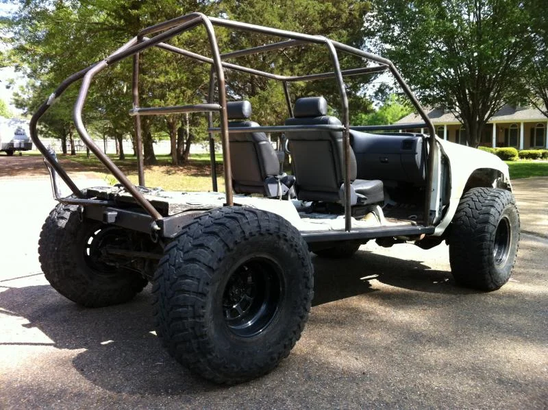

I think this one was around 4500lbs with all that cage. A simpler non- family cage and those 37's would probably tip scales at 4300lbs. An 80 at this weight would be nice offroad with gears in tcase and axles
I think this one was around 4500lbs with all that cage. A simpler non- family cage and those 37's would probably tip scales at 4300lbs. An 80 at this weight would be nice offroad with gears in tcase and axlesView attachment 887954
this one it's very sweet .. altho I would like to see one with even less panels on front .. I mean this one appears to have all front clip ..

The key would to keep it light as possible - and keep to 37's . 80 axles pushing 4000lbs should be pretty bulletproof on 37s and go about anywhere. Once you go over 37 or start adding stupid cage/slider weight you basically will need to rebuild the whole thing from ground up ( stronger axles/3link etc etc) and the slipperynslope begins a fast downward spiral.
Things I'd do to keep weight down-
- chop in toward seats on sides and eliminate need for longish sliders. The narrower an 80 is in this area basically eliminates areas that need to be protected. I'd just run a slider half size and waaaaaay up high. Light d.o.m.
- just run a simple hoop over driver and triangulate it for strength. Will function well to protect you while not adding the 250+ more pounds a family cage would have.
been done a bunch of times. We built the Franken80 a couple years ago. Caged, 39s, chromo everything, geared and beat on. Also suggest keeping on 37s on the rig, The Franken80 keeps breaking front axle parts to include 1 R&P set, knuckle studs, hub studs and now a locker. ARP'd studs going in everything in front does help but tires I'm guessing are the culprit behind multiple breakages.
